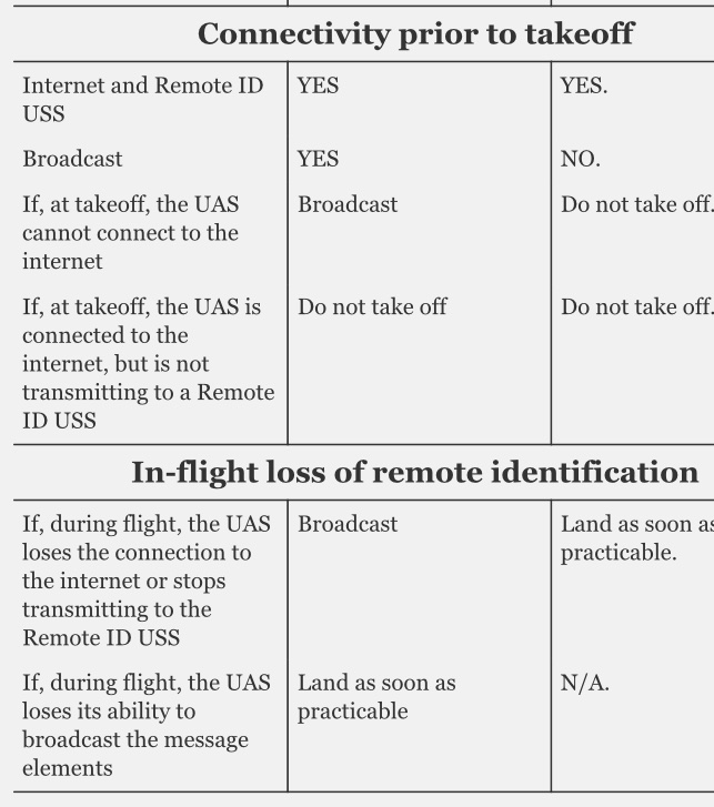

I think I found it.
Reactions: ARMeyer
I think I found it.
9. Message Transmission
The FAA is proposing in § 89.310(i)(1) that standard remote identification UAS be capable of transmitting the message elements in proposed § 89.305 through an internet connection to a Remote ID USS. Additionally, the FAA is proposing in § 89.310(i)(2) to require that standard remote identification UAS be capable of broadcasting the message elements in proposed § 89.305 using a non-proprietary broadcast specification and radio frequency spectrum in accordance with 47 CFR part 15 that is compatible with personal wireless devices. The FAA envisions that remote identification broadcast equipment would broadcast using spectrum similar to that used by Wi-Fi and Bluetooth devices. The FAA is not, however, proposing a specific frequency band. Rather, the FAA envisions industry stakeholders would identify the appropriate spectrum to use for this capability and would propose solutions through the means of compliance acceptance process. This requirement would ensure that the public has the capability, using existing commonly available and 47 CFR part 15 compliant devices, such as cellular phones, smart devices, tablet computers, or laptop computers, to receive these broadcast messages.

In terms of “always flying with internet access” that’s but one of the options. Having an aircraft that can Self Broadcast also meets the requirements.
From what what i understand there are only 3 options to comply the first 2 both require internet and the 3rd limits you to 400ft and you must be in a special area. Also you need a subscription? Even if you can do it without internet that will still essentially make older drone's illegal as it would probly be cheaper to buy a new drone with remote id than try to rig it up on a old drone. It would just really stink to not be able to (legal'y) fly drones not equiped with it without being in some special area. If they would do what i am told the uk does and just allow special privaliges to those who use remote id and let the rules for the rest of us stay the same i think i would be happy.

That last paragraph doesn't really apply... if you can't connect via internet then you Broadcast Only. Be sure you fully understand all points before making your comments or it may do more harm than good.
Reactions: dronesky
You’re mostly correct, but I went through & re-read the NPRM. It says “if an internet connection is available.” Even though internet connection is available, it is too slow for upload or download. Maybe the solution is obvious then? [emoji848]
I routinely drop to 3G on my phone and have a marginal data connection. And some apps won’t work while others will. I need LTE (4G) for all apps to work reliably. So @ARMeyer may have a point. I guess it depends on how the developer codes the test before takeoff. It needs to take such situations into account.
