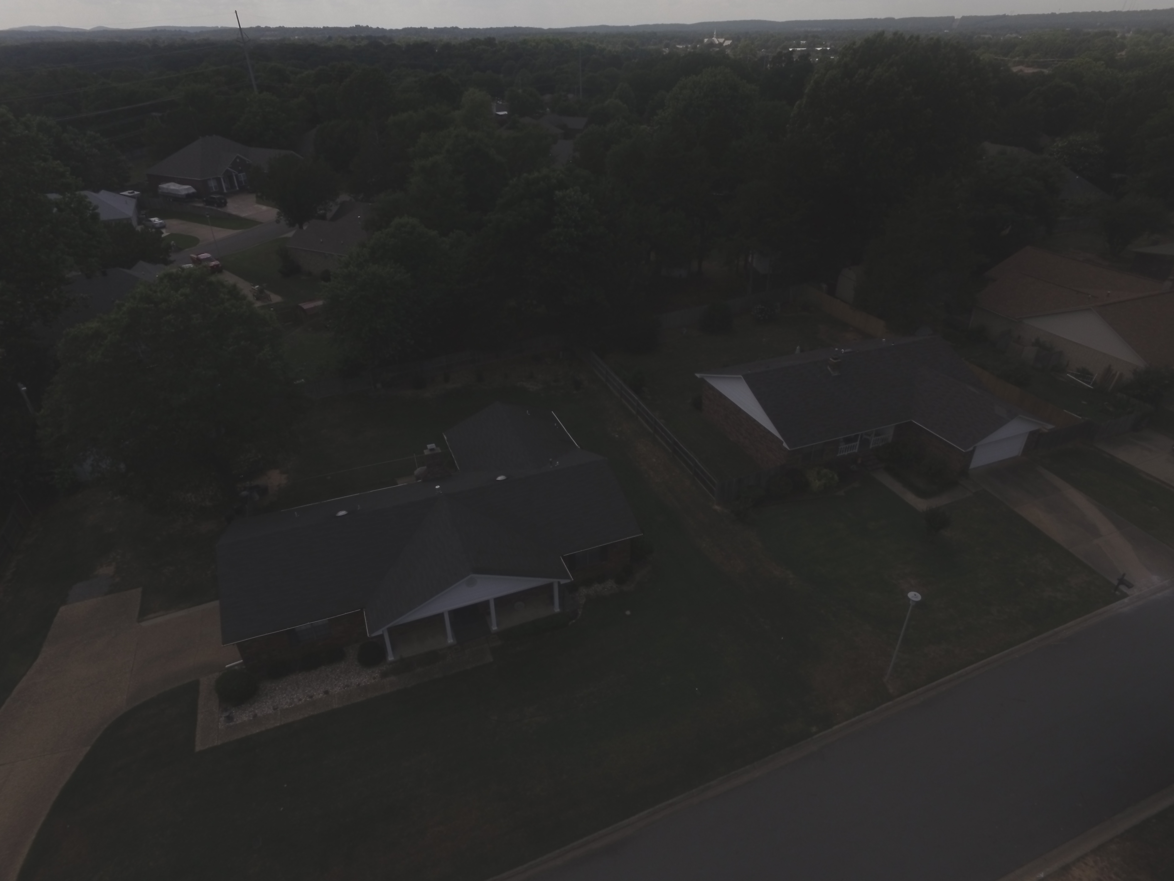

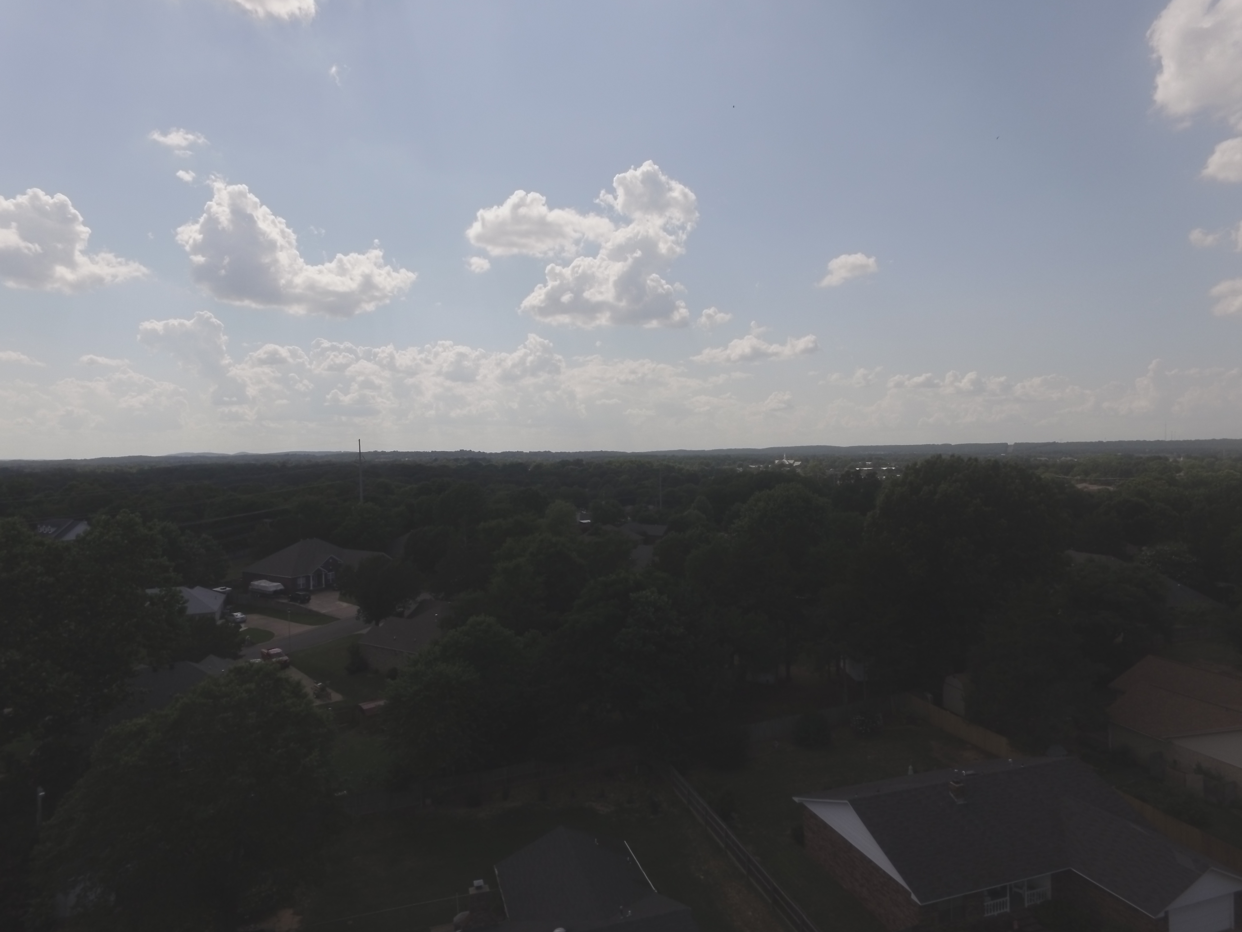

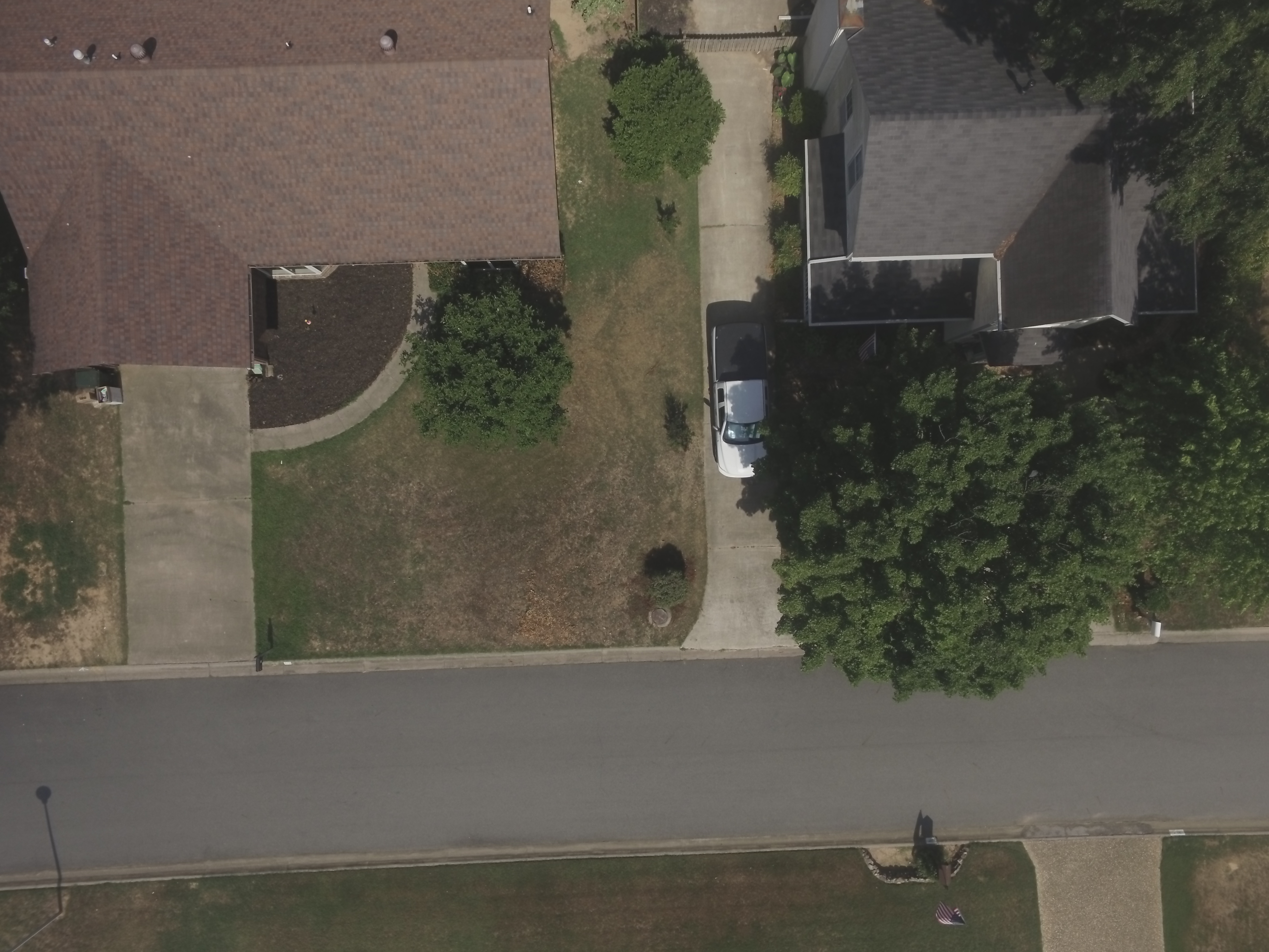

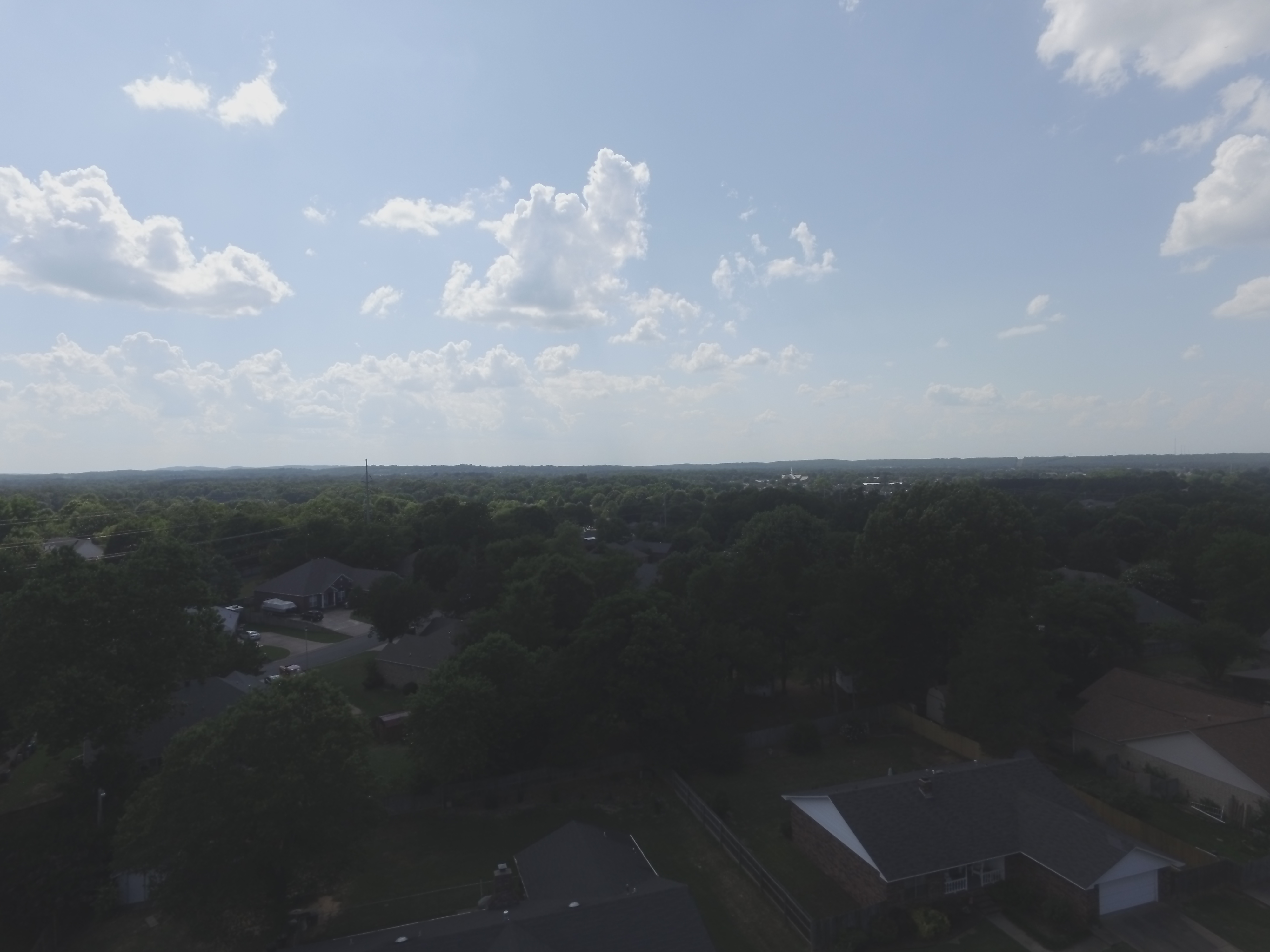

2nd set adjusted for the sky.

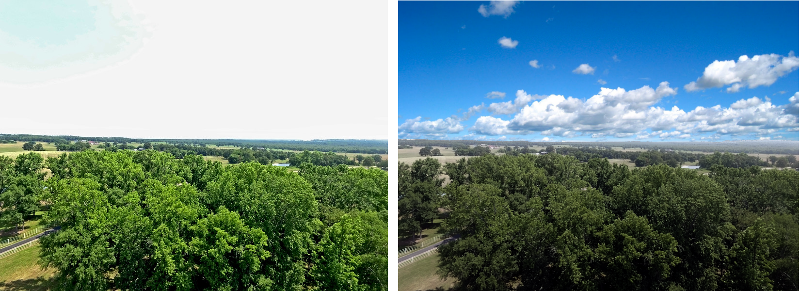

About the best you could do with Photoshop etc is something like this:
But that degree of overexposure is one thing you can't fix.
There's nothing in the sky and it's 50% of the image.
Don't underestimate photoshop

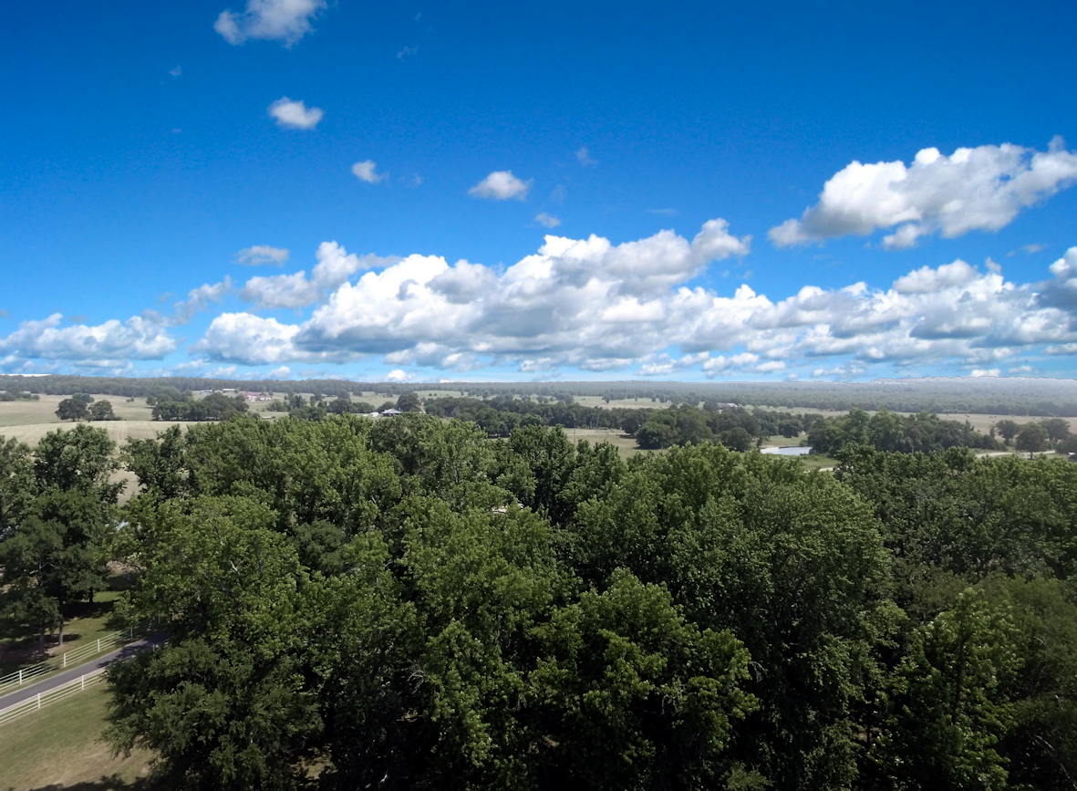

Which would you choose?
If you were doing a promotional picture, and you had a choice between a beautiful "transplanted" sky, and a nice well exposed, but inelegant "real" sky, which would you use?
Shoot RAW?
They want to do the postproduction. So could you shoot it RAW for them? Wouldn't that give them all the image information and allow them to do whatever they want in post.
Despite it being sort or a waste of time, I would take my best pictures for them, give them all the data for post, but also give them what I did in postproduction. They can use it if they want, or do their own.
Most of what our company does I would call "promotional" and sky is VERY important. We shoot to our best ability for the landscape (unless the sky looks amazing) and then "replace" the sky to make it have as much POP as is possible and still within reason.
