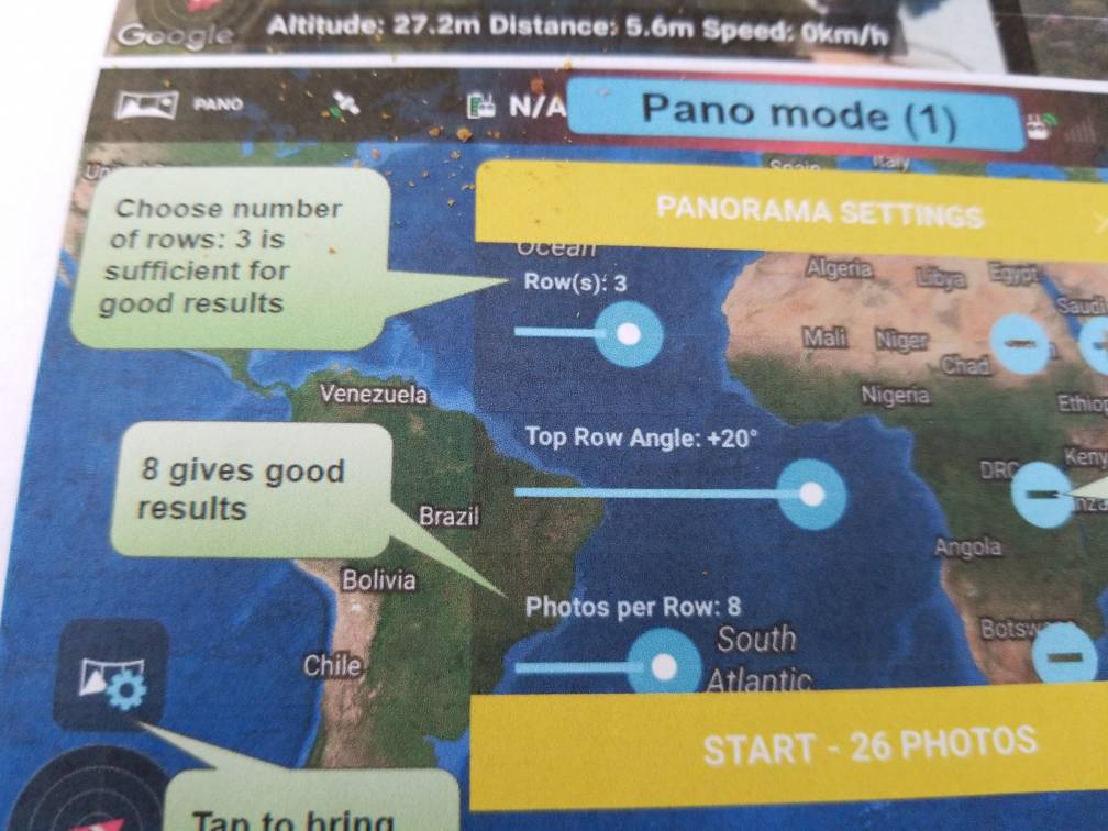

Anyone know why I cannot set the top row angle using Lichi in pano settings?
