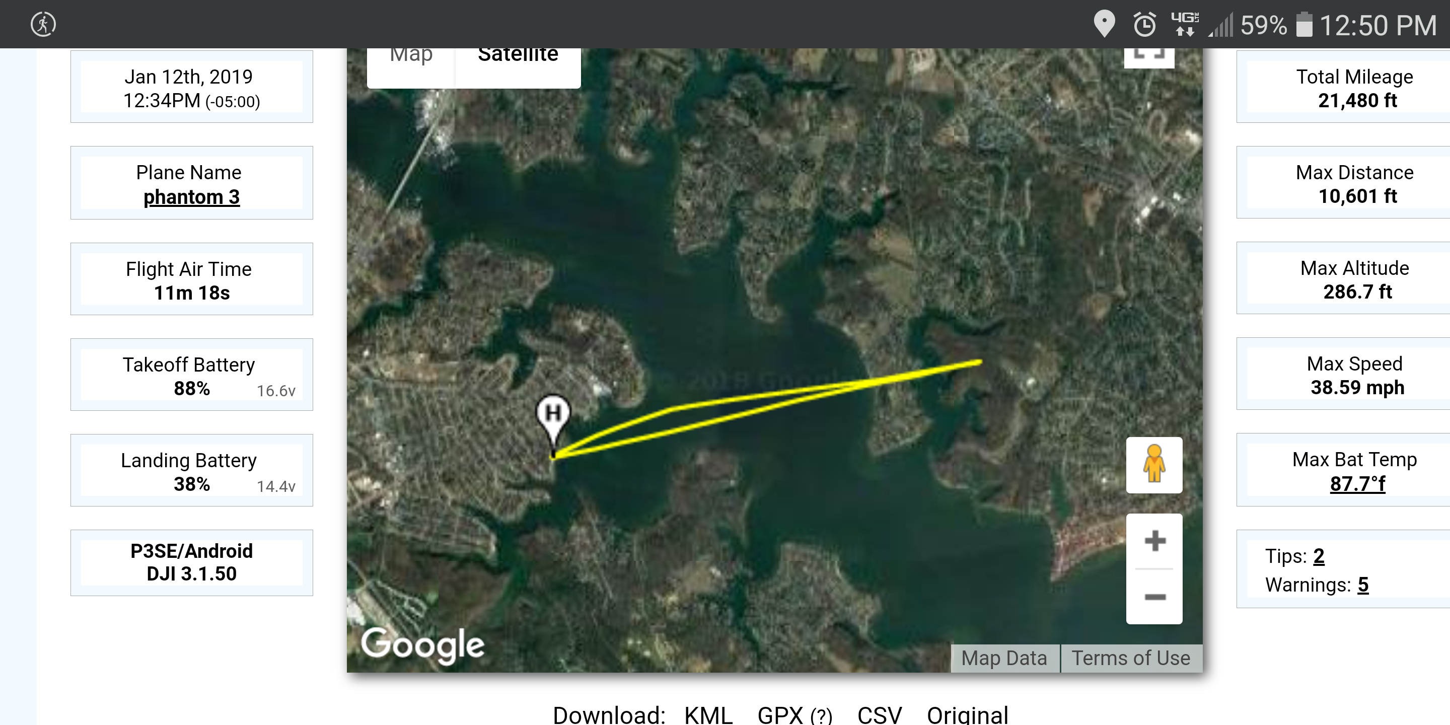

I did 8500 feet stock best run. Argtek gave me 10,600 on first distance run FCC I believe 5.8

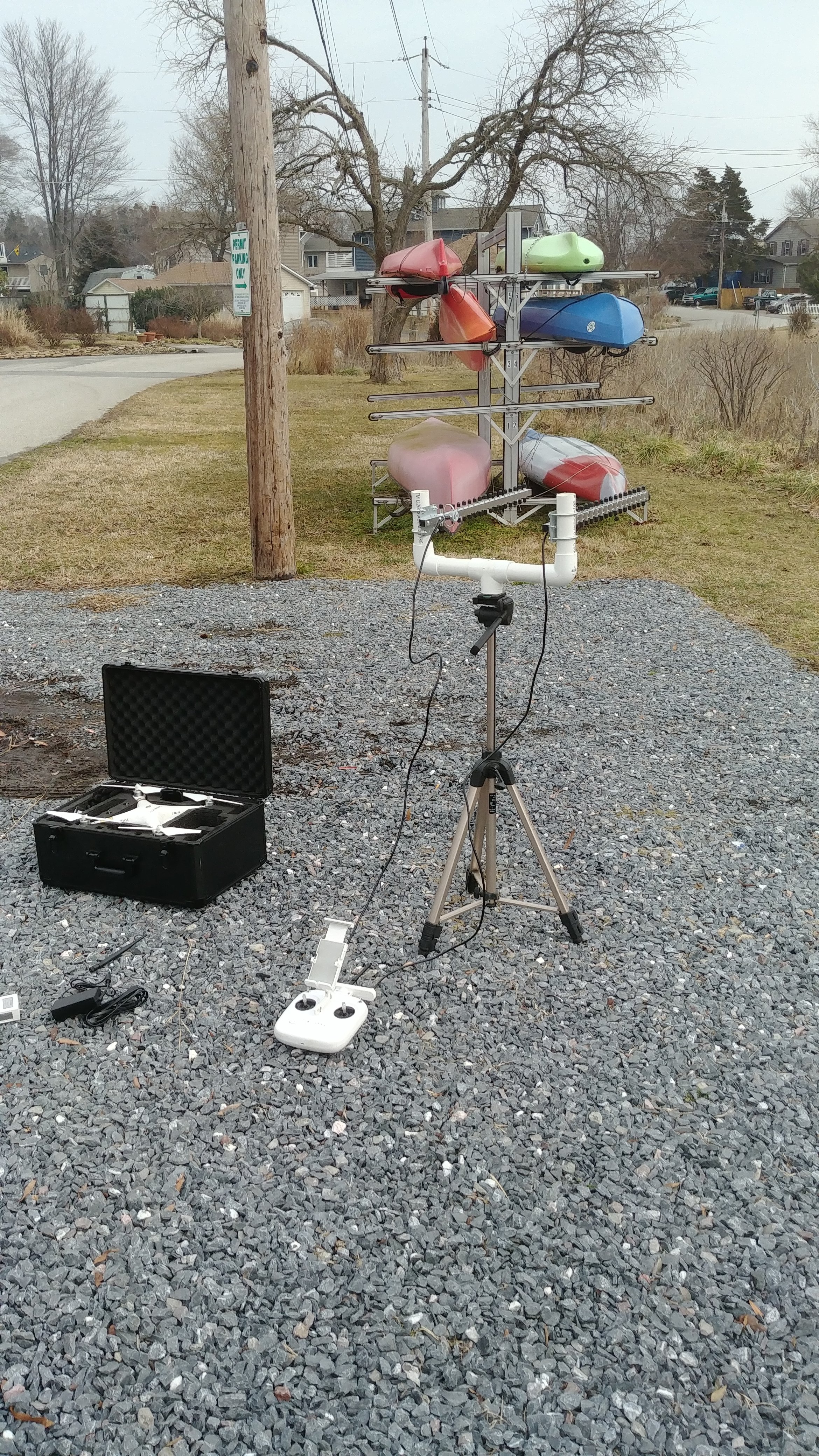

3 Are directional plat panels, they have the best distance for straight distance runs. 3 are omni directional, great for flying around. Only need to use 2 antenas on the outside post, center antena is only wifi to you tablet or phone
I got 16,000 feet from this setup unboosted, in a rural area. Bird turned around at 77% battery, and landed at 21. Airdata signal score was 100%
Oh. Thanks a lot. So no need to worry about the center one.
I’m going to open the controller to see if everything is secure
Wow! That looks more like what I have in mind jajaja
Thanks for your help
I see what you mean about the center antenna!
Awsome setup!
