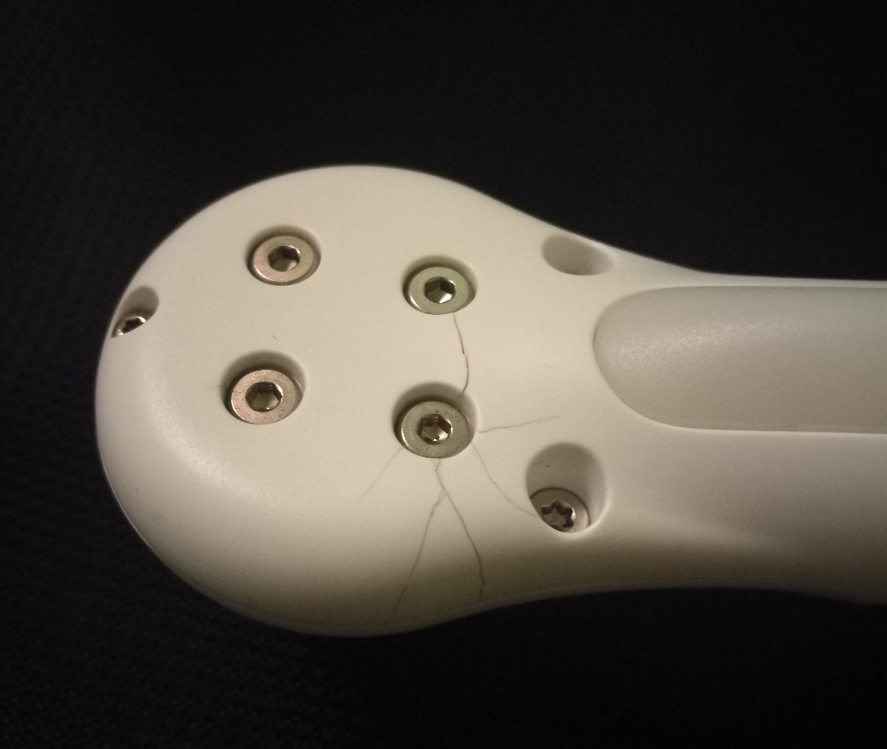

I have 2 Phantoms with stress cracks. Has anyone tried to used printed motor reinforcement mounts and epoxied them to the shell to repair the cracks? I figured that if this doesn’t work, I can always still replace the shell.

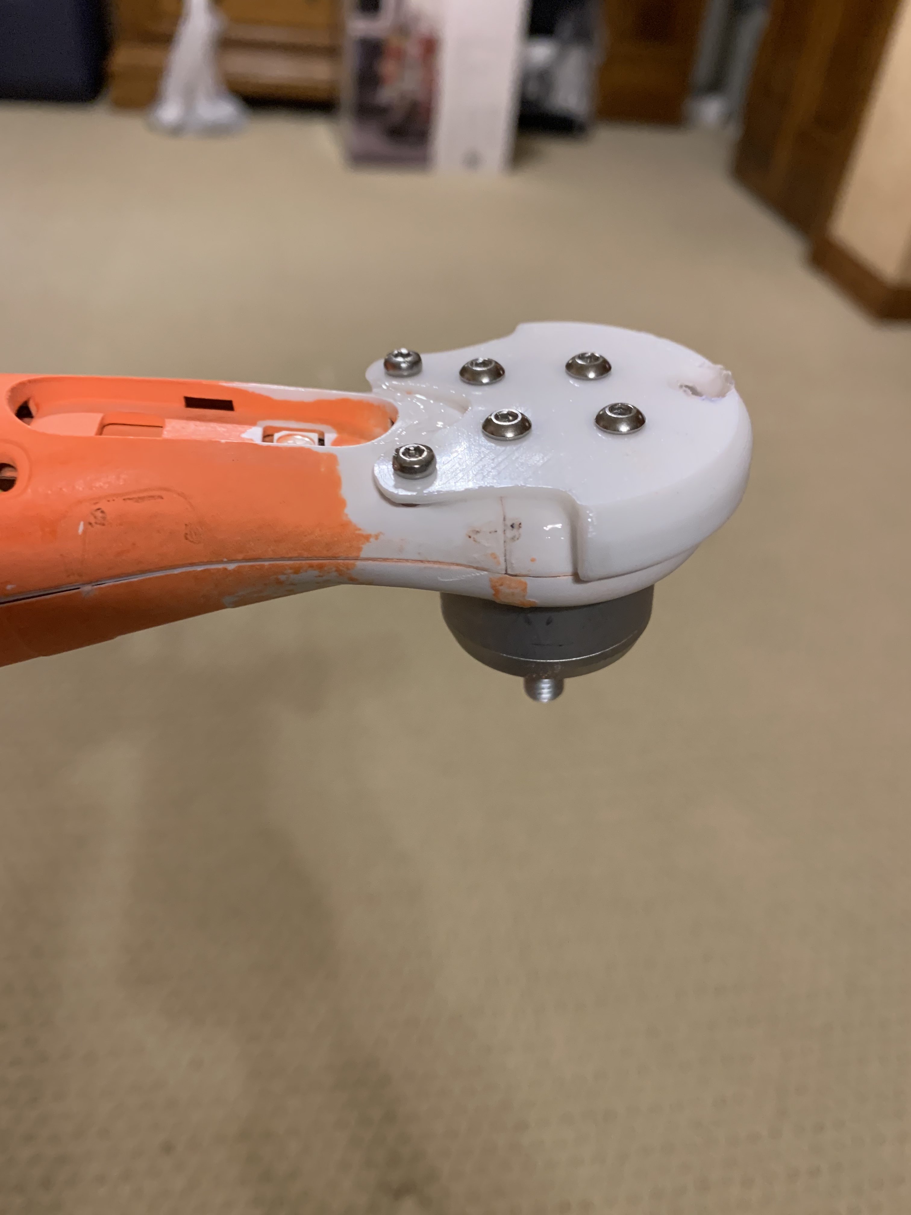

I have a P3S and P3P with the same issue. Since they are cracked already, I have to glue the bracket to the case. I thought the plastic brackets would epoxy to the case better than aluminum. I have completed the P3S and it seems to work well with only 1 flight. The motors are mounted solidly.

When you say solidly, do you mean won't be able to replace motors if they need to change them? This is mine but without epoxy.

You can access all 7 screws to remove motors or separate the shell. The original part did not have a hole for the screw at the tip, but I drilled the access hole. I when I say solid, I mean that the motor support was very soft before the repair and the motor would vibrate and props would hit the shell. Now the motors are solidly attached to the shell now and don’t vibrate at all.

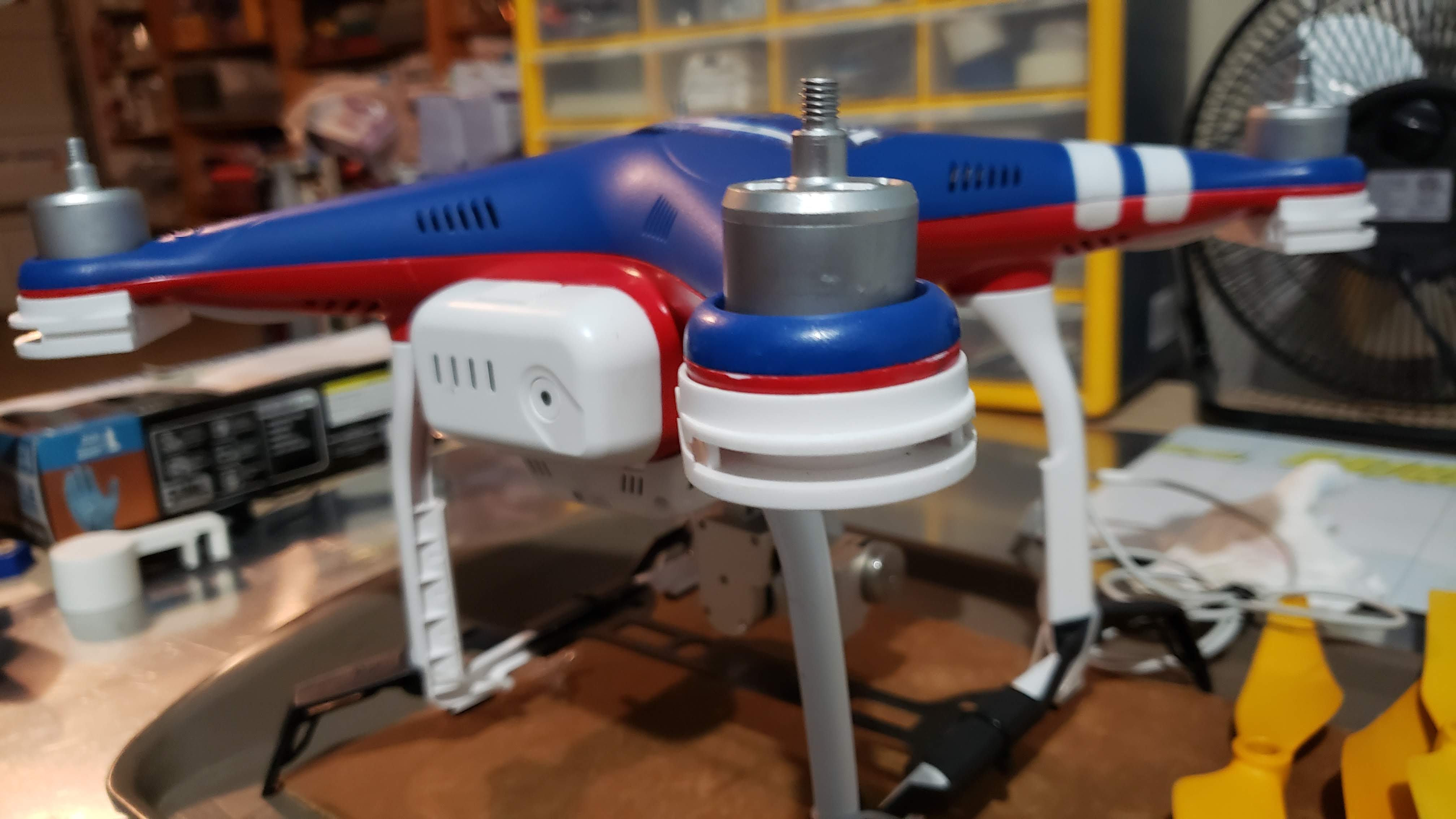

I have 2 phantoms that I outfitted with the metal plates, no epoxy:
Both have done the job beautifully... on my "daily driver" I decided to do a full shell replacement, and when I was done, I fitted the plates back on as insurance.
