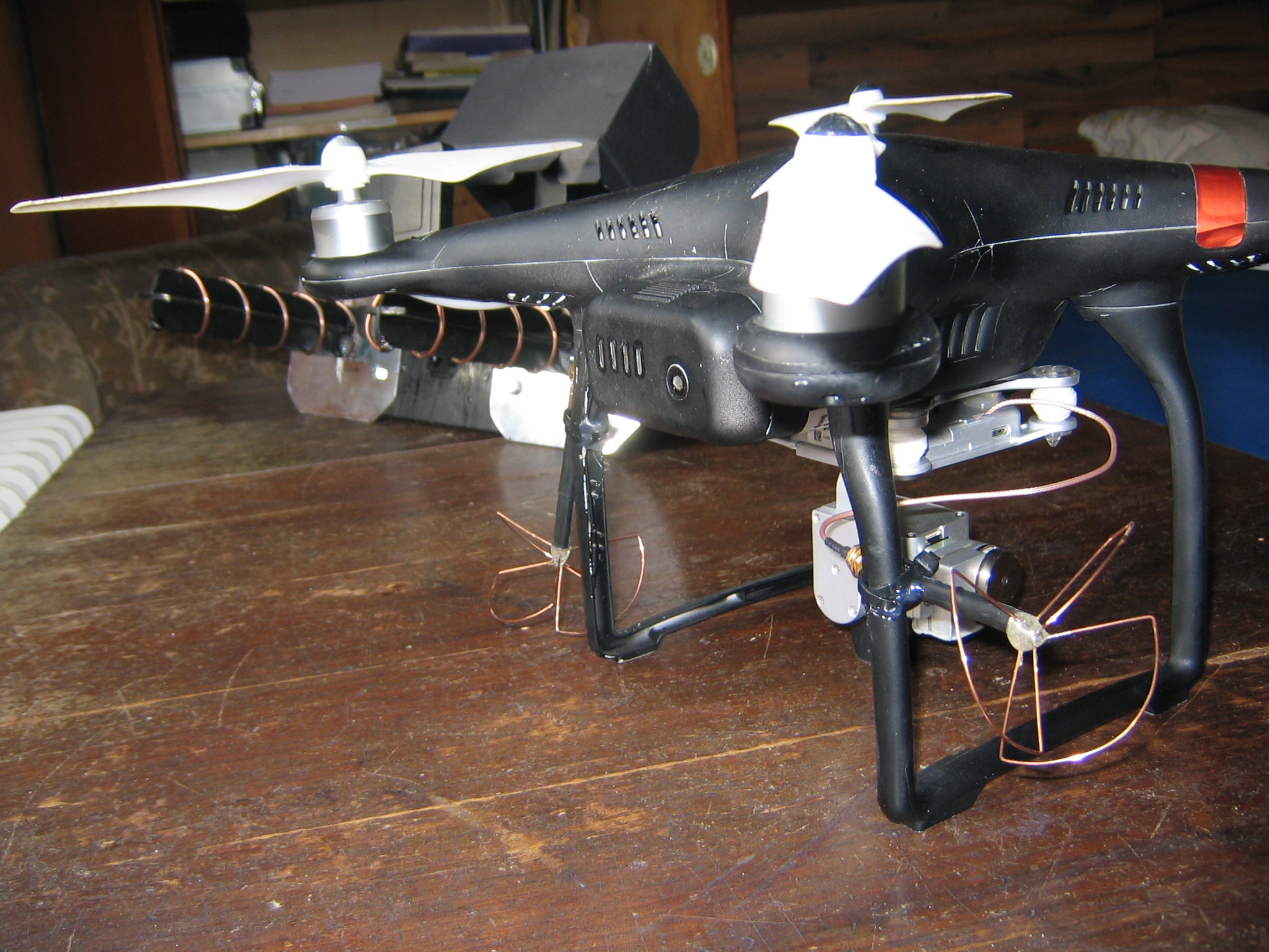

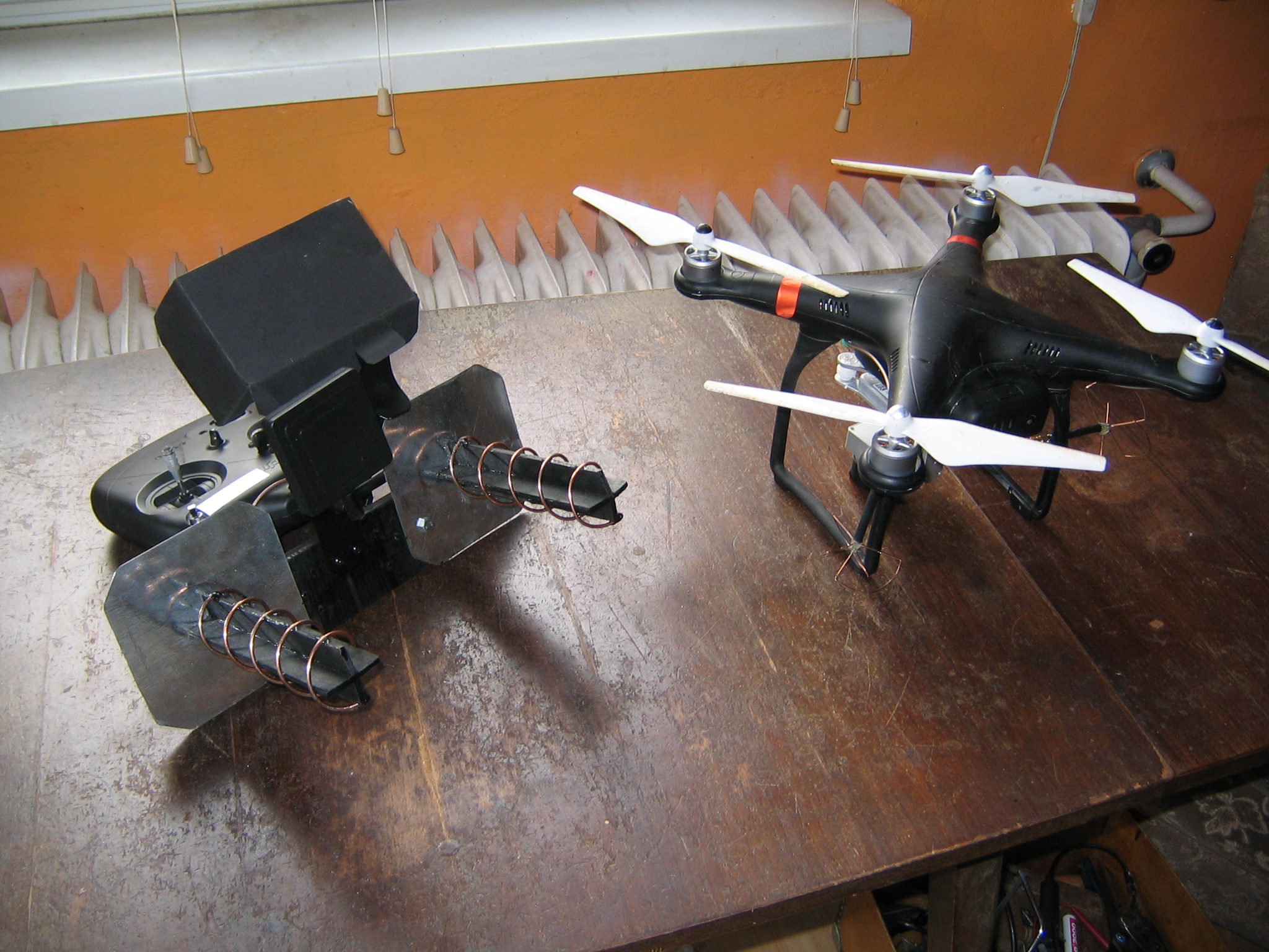

Can we see your antenna mods ??
sure, just some diy helicals and cloverleafs for my p3s, greatly improved range.
also did the infamous ce-fcc 27db scriptmod, but only to 24dbm because of reported overheating issues
