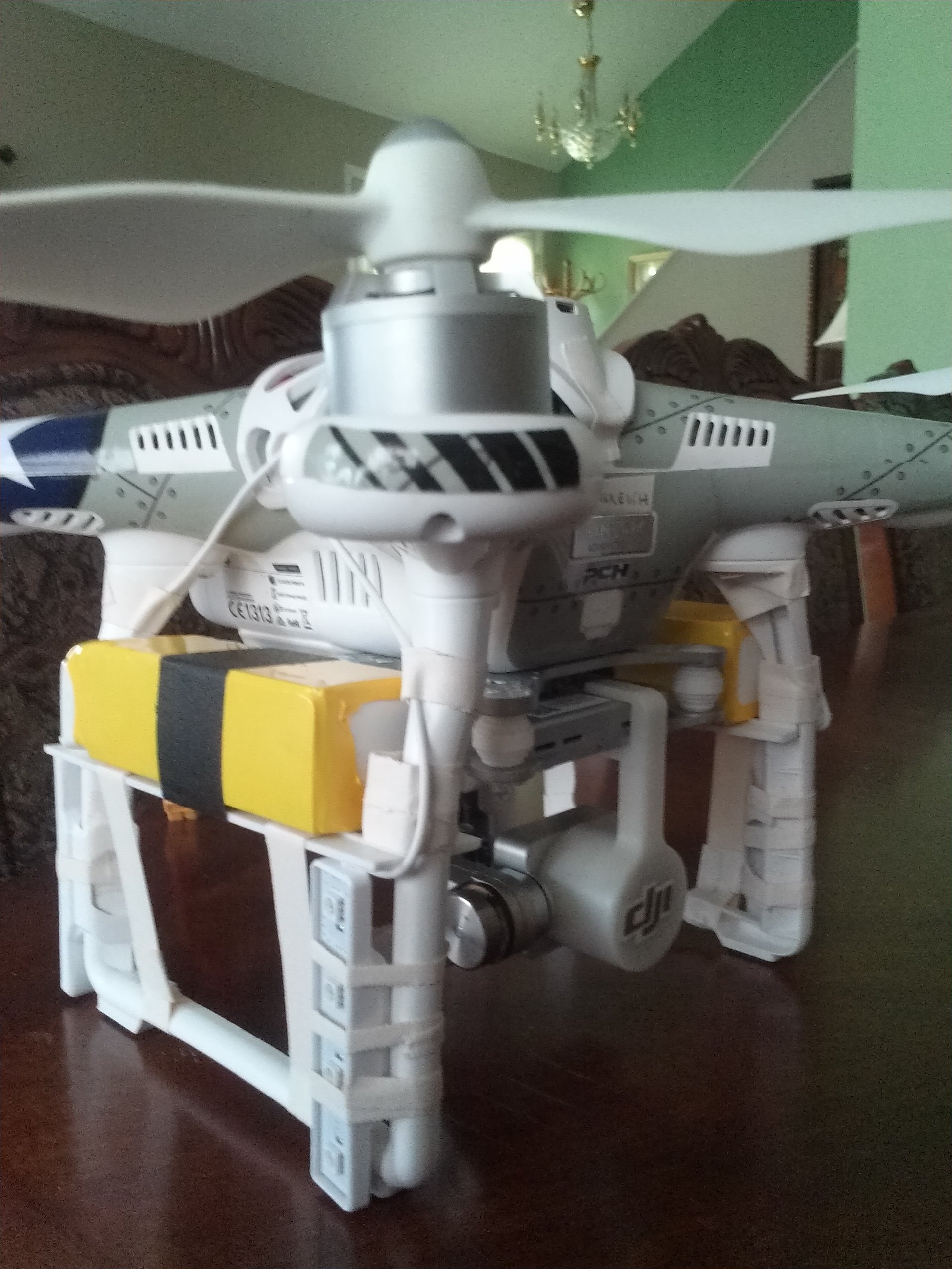

Hey maxwell, how was the weight balance on it with this battery setup? I notice the back half of the battery is just hanging out .. Does it clip in on the front to hold it in well??
Overall I have been pleased with the horizon v3 power mod with dual 5200's and a modded p3 battery. The balance of the bird is great and it remains responsive, if not more solid feeling in the air. From my experience, which is way more limited than the the warriors here, is that you should keep two things in mind. People who are getting 30 minutes or more are squeezing every last drop of power. That happens when you push the remaining battery percentage very low. These people are riding out single digit battery levels. I'm not hooked on that thrill, lol. Battery percentage drops fast when you get in the low 20's too. Even with this mod I fly to 20 percent at most and usually get around 26 minutes. When I hit 27 percent I'm flying back in close too, not a mile out for the thrill of hoping I make it back. I have one phantom and I do everything to increase my odds of keeping it in tact, not crashing it. The second thing I noticed is that after a mod flight, the dji battery is really depleted. It is not at a storage charge- much too low. If you won't be flying that battery for a while, charge it to 50 percent.

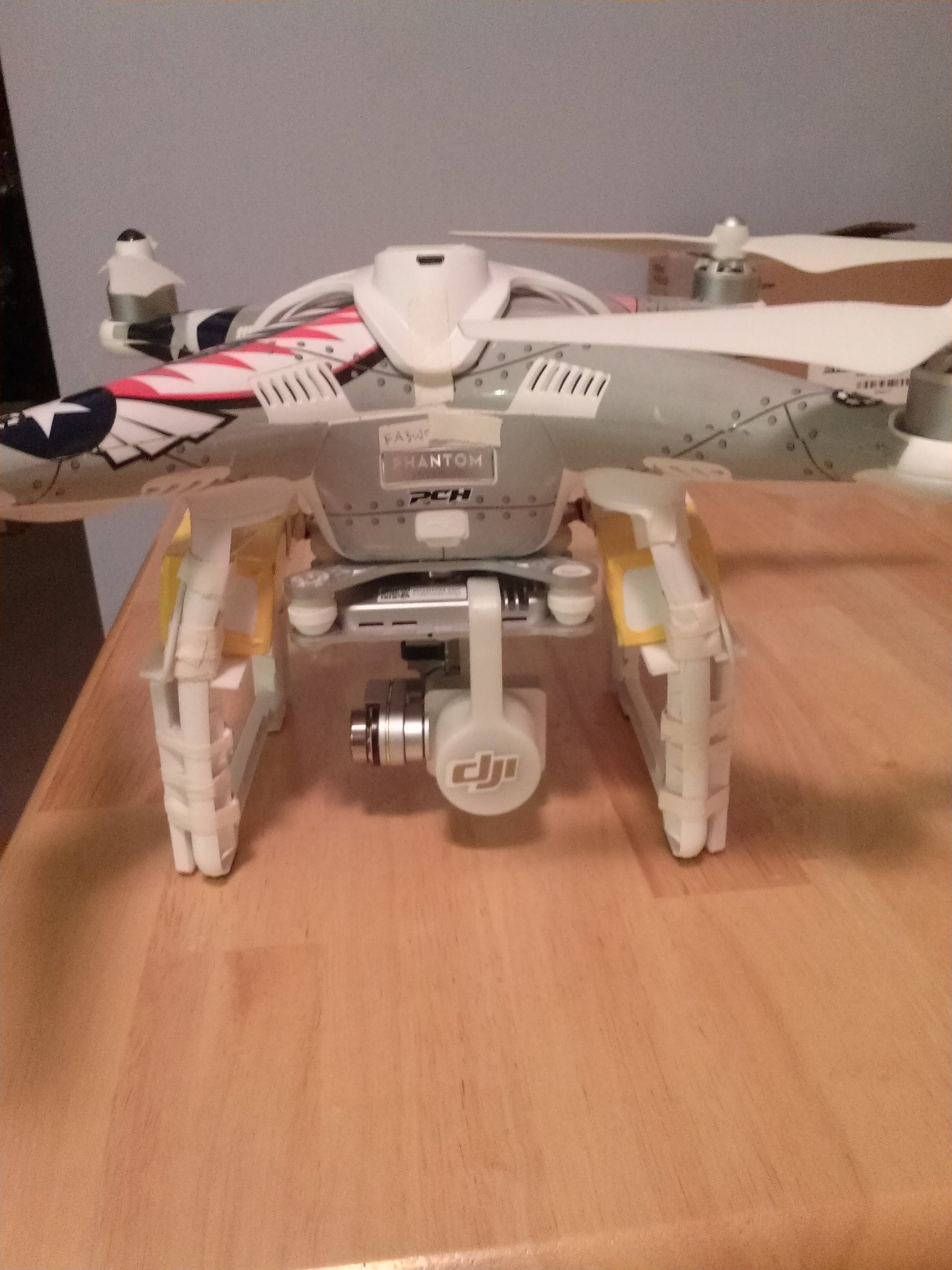

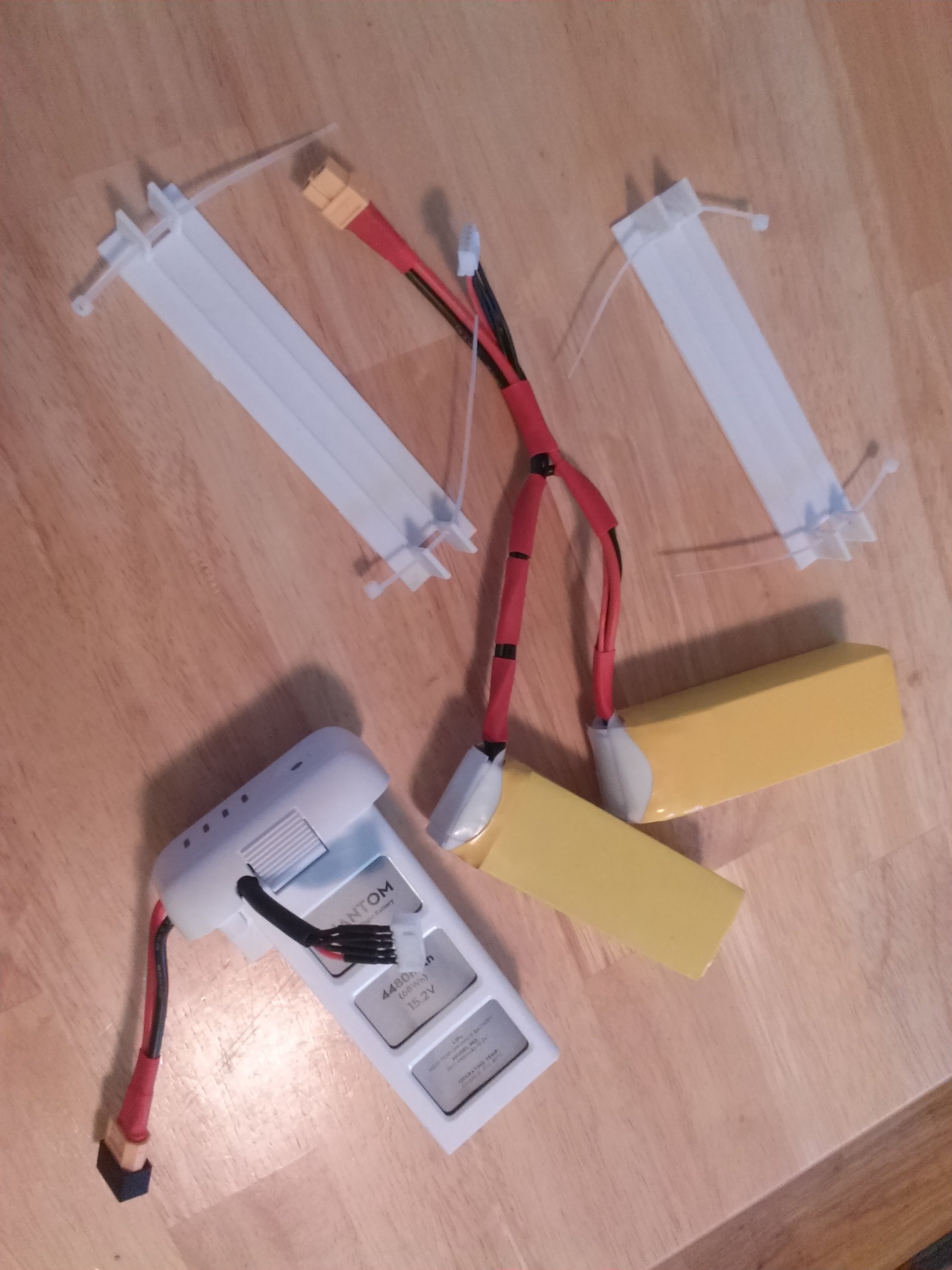

i got my 2nd / backup phantom 3 finished up today. its a phantom 3 pro, phantom advanced cam and used some modified cf battery trays mounted to the landing gear. Direct power mod in the aircraft and it has the Horizon 5200 battery on it right now.
Hey maxwell .. Any other flights with this battery mod? Is it something you are gonna leave on the bird, or did ya take it off??
I haven't had time to play with it lately. I got some more stuff in the mail this week, so I hop to get some testing done. I just got two more batteries, one is a DJI original and the other is a knockoff. So when I get some time this weekend I push it a little.
