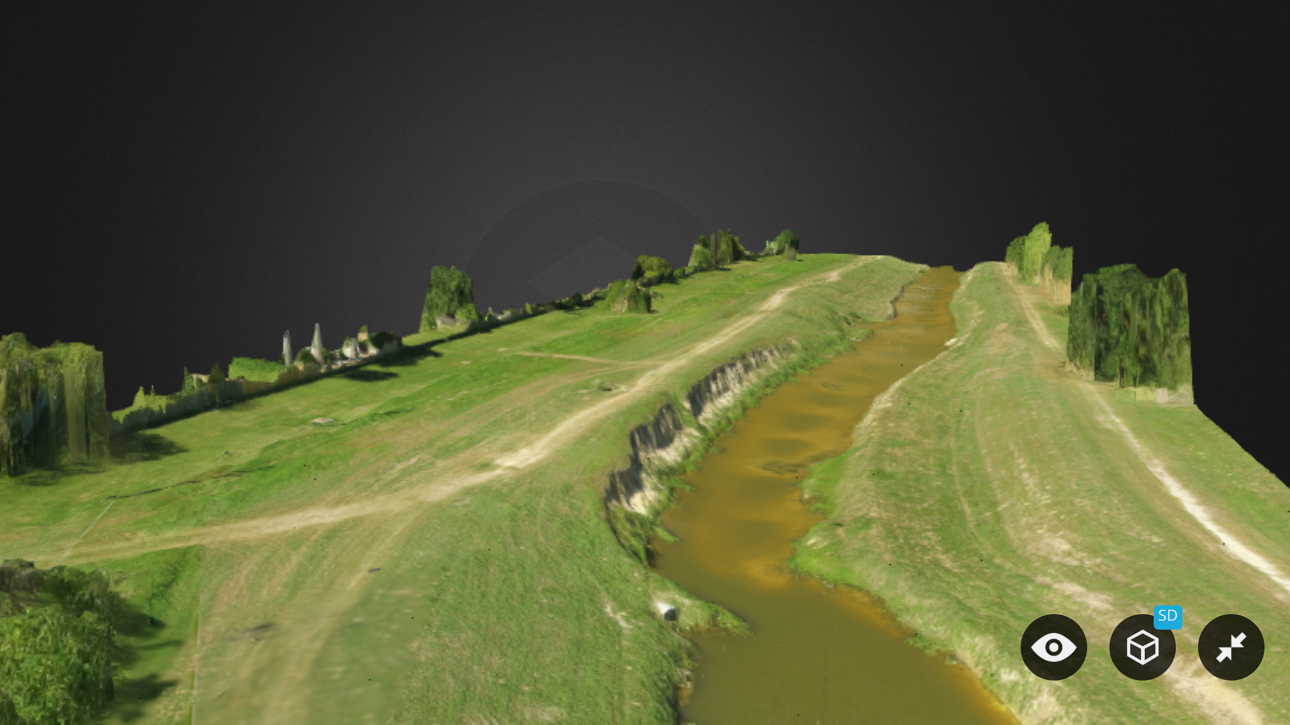

I downloaded the beta app, downloaded their FW to my P3A. Made a 5 acre map of a bayou comprised of 82 images taken at 120 feet. A little bumpy to learn at first. I had a glitch that wouldn't allow me to take off because it couldn't take a test photo. Works 1 out of 5 times when it does, it's impressive. Flew the waypoints very accurately and landed 8 feet from takeoff. I was blown away by the 3d model being that it was my first.
If anyone knows of 3D apps or software. Or stereopair sort of technology please let me know. Thanks DroneRookie
