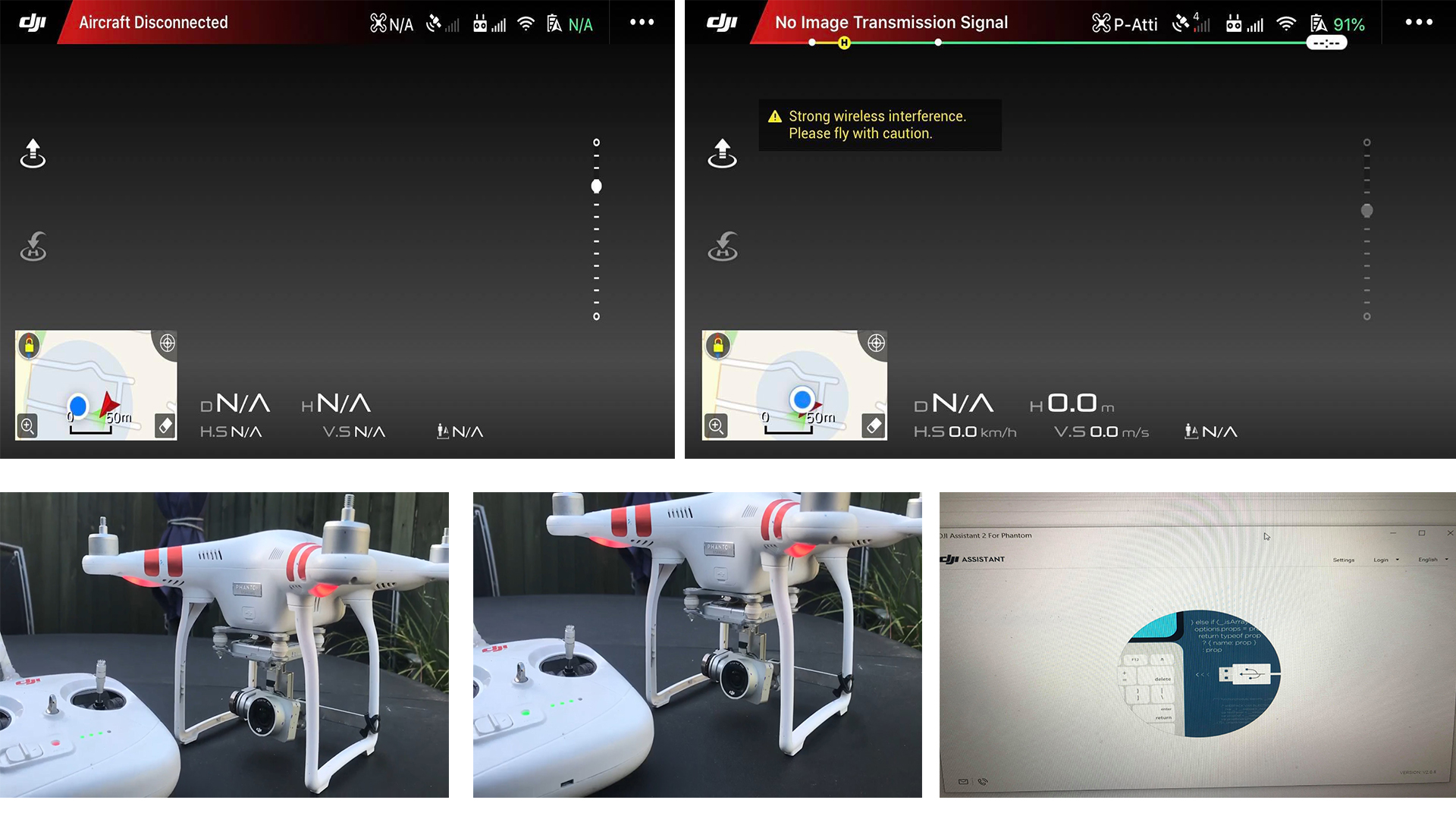

Hello everyone! I have trouble with my DJI Phantom 3 Standard after landing in 5 cm. of water. I was flying on a beach and the aircraft hard landed in about couple of inches of water, only the camera and half of the gimbal got wet tho. Two things happened - The aircraft stopped receiving video signal and the gimbal is not moving, second the aircraft disconnect from RC and every now and then it will connect just for few seconds and disconnect immediately after that. When the aircraft links to the RC I can start the motors and receive the "No Image Transmission Signal" message but then it immediately disconnects and I lose control again with "Aircraft Disconnected" message. The Gimbal status stays "Gimbal Disconnected". I tried to connect gimbal usb with my laptop but no connection was established. What should I do ? Thank you !

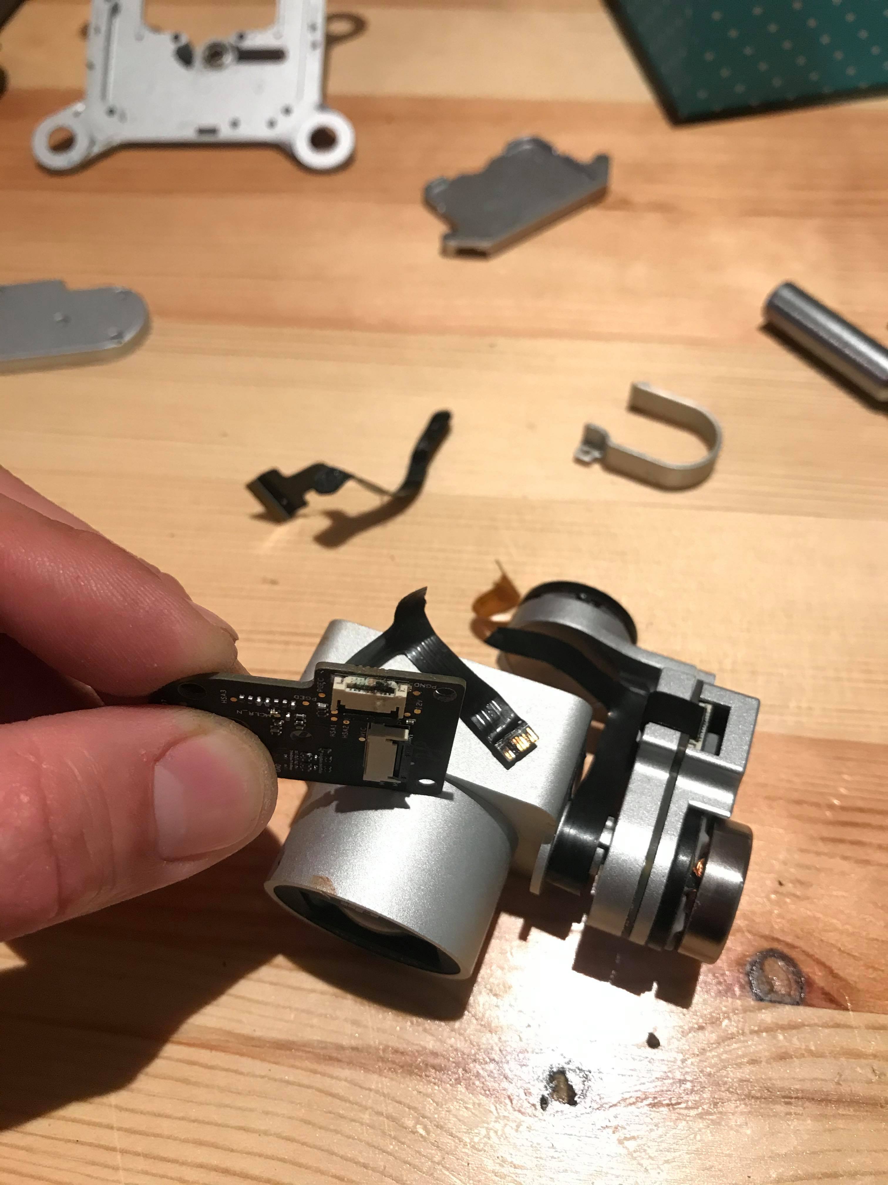

Just disassembled the gimbal. One of the connectors is melted and the flex cable fell apart. What is next ?

The prognosis is not good.
Seawater is death to electronics.
The damage is likely to get worse as corrosion spreads.
Yip shorted that out nice,,start with the new ribbon set ,,hopefully the damage stops at the plug unless you can see more damage on the gimble board,there lots of parts on Ebay etc and depending how much you can afford I would get one just incase,if it does turn out ok at least you get spare part which very handy,good on you to for getting in there for look,hands on best experience..also dont underestimate a half meter drop,,these phantoms not like it,but looks like you find the problem,

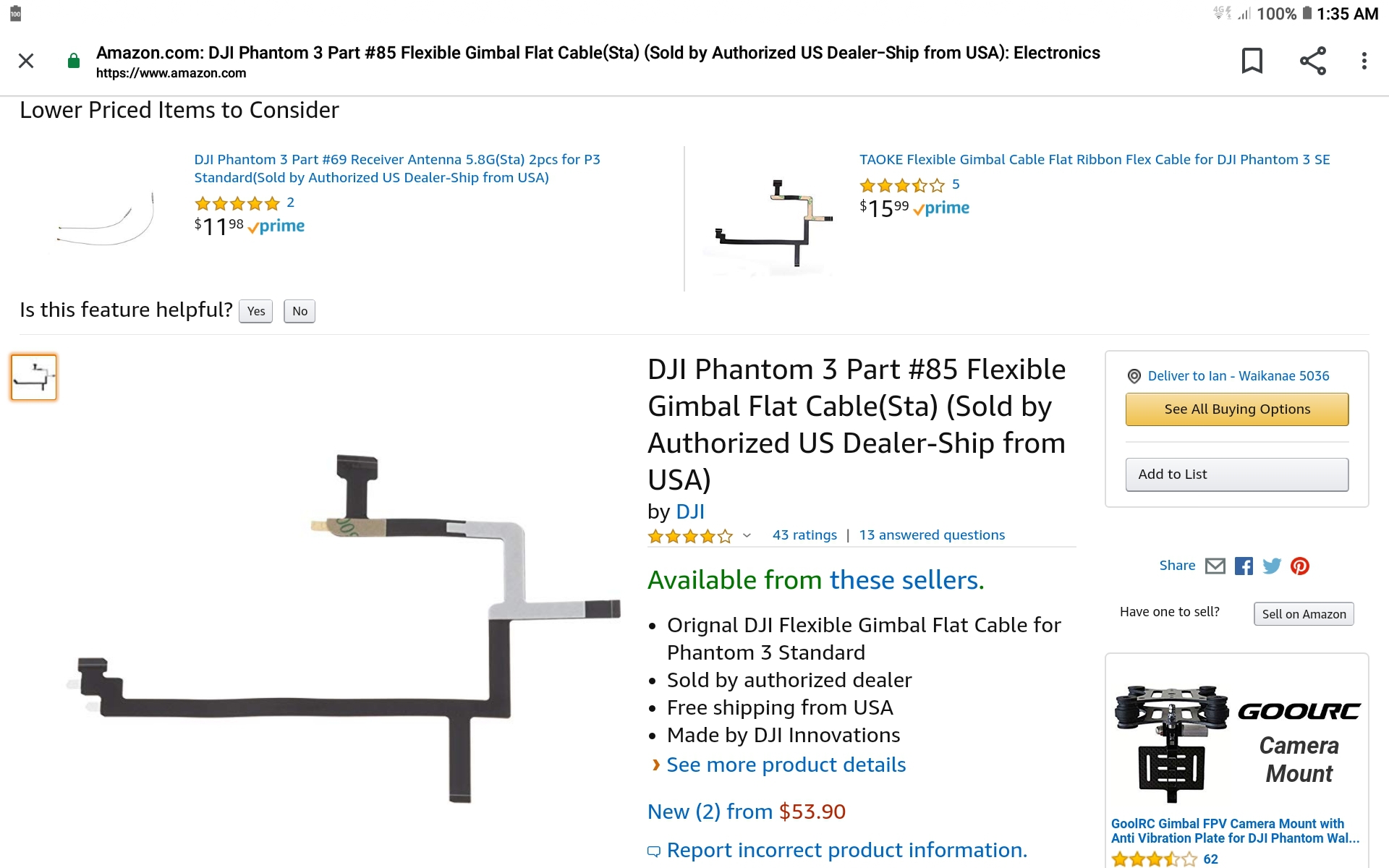

Still looking at ribbon sets,,but search on Amazon you should see,,if I dont find,its late here or early ,,

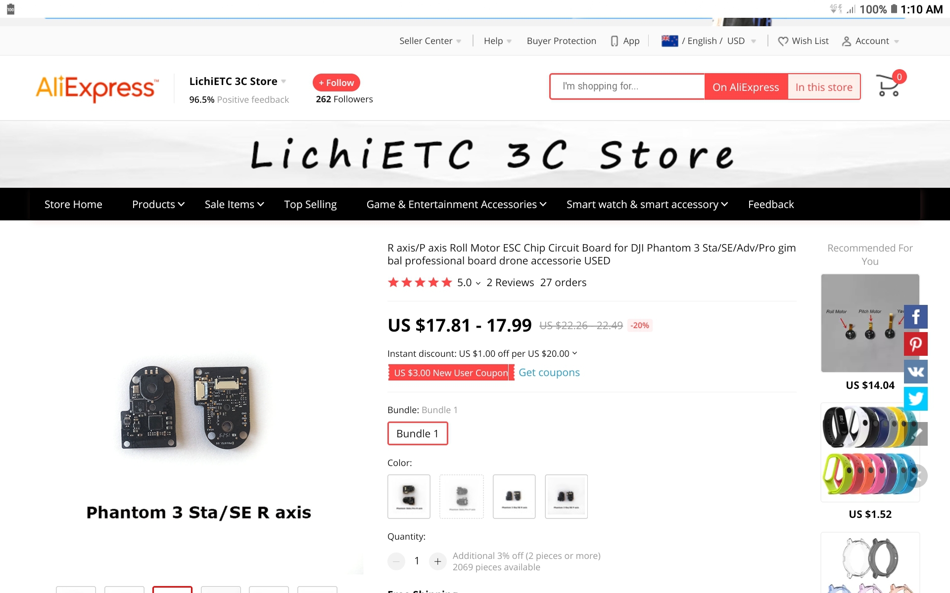

The ribbon cable is gone for sure, but can`t still tell about the small PCB with the melted connector. I ordered one from ebay, looks the same on the photos with the same serial numbers and all, hope it will work.
Still not sure from where to order the ribbon cable as the prices vary from $13 to $100 ... ?
