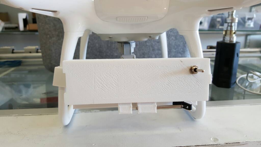

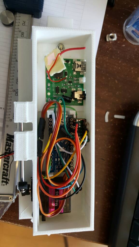

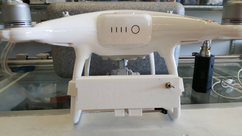

I wonder if you could use one of the back buttons to open the servo?
I guess you have to solder wires to the board?
No you don't need to
The drop mechanism I'm working on you need to stick a sensor on the front LED light and when you turn the lights on the servo release the mechanism
You can assign the back button to turn on or off the LED lights
No need to open the bird or unscrew any part of the phantom
