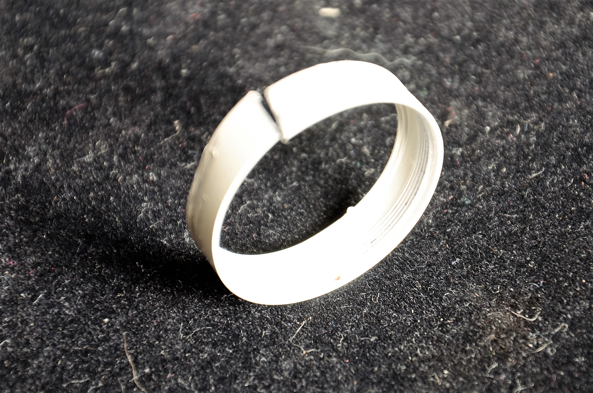

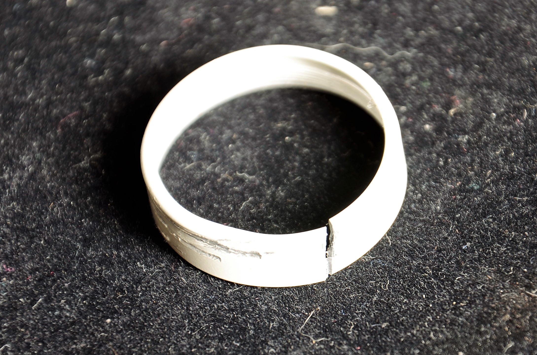

Purchased a set of Polar Pro ND filters for my NEW P4. As many of you know, the stock UV filter can be a little problematic to remove. Such was the case with mine. After viewing several You Tubes, and doing a search here, I attempted most of the recommendations. Nothing worked! This was the UV filter from ****.
I then had an epiphany. All that's needed is a small channel lock and a light rag on this baby. Once the glass in the filter shattered, I knew I was in survival mode. Went back to You Tube and tried a few more techniques,again to no avail.
Used a little WD 40 and left it overnight.
In the morning, nothing had changed. What I am about to say is deserving of your condescending and derogatory replies, but this is what I did: Delicate surgery with a Dremel. Put on a set of jewelers head magnifiers, set the tool to lowest speed with a small metal cutting disk. It was a successful Filterectomy! Camera threads were unscathed and the ND's twist on beautifully.
Lesson #1 Never use on a delicate camera, the same tool you would use on a John Deere tractor.
Lesson #2 Never give up

Everyone's experience with this may vary, since the assemblers at the factory may be using more torque on some units. Fortunately, mine was easy. As a machinist and a photographer, I've faced this issue hundreds of times in my career. Its not always easy. A few times I had to resort to severing the filter ring to relieve the tension holding it on. Most people may not have the delicate hand and experience to do this without causing further damage. Glad to see you did, double down.
Reactions: go-ahead-doubledown
Thank you for your kind comments. Yes, I would agree that the assembly process determines the ease in which these are removed. Judging from the threads and other posts I've seen, it's easy, or it's not.
