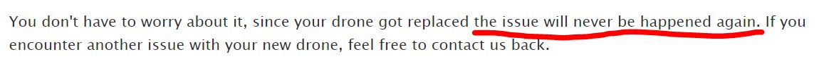

The first time, yes. DJI not only replaced the drone, they did it rather quickly. This time, they seem to be dragging their feet (go figure). I assume that this MAY be because they're taking my issue more seriously.
The first time this happened, DJI probably figured it was a freak incident. But here we are < 6 weeks later, and the same, exact thing happened again. So I'm going to guess they're looking at this a little deeper - maybe wondering "what the heck is this guy doing?" The thing is, I'm doing nothing. Literally. Zero RC input - a flat line in the .dat file. BOTH of these failures occurred above 250' AGL, and were automated flights. So it ain't me. And the bird isn't crashing into anything. And last time, DJI gave me this assurance:
Well....it "be happening" again. And, per their suggestion, I contacted them back. So far, dead silence.
I have generated an RMA for this incident, but haven't heard back yet.
Worth noting; I took advantage of the new, replacement drone and, after jumping through many hoops (including producing a comprehensive video) sprung for Care Refresh™. So I suppose if push comes to shove, I can utilize the Care Refresh™. But honestly, I don't believe this is a Care Refresh™ issue. Flat out, this is the fault of the propeller. Just as last time, the .dat file data clearly shows this. I guess we'll see....

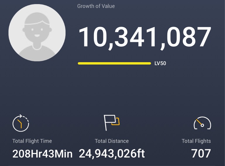

All of my own 700+ flights are at a constant speed of 30mph throughout, using OA and max throttle, solely because it easily maintains the most efficient speed for maximizing distance, and I have never had a DJI prop failure, and I usually use the same set of props on every flight. A rare batch of bad props seems the most likely culprit, rather than prop fatigue. Such anomalies usually get sorted out in the most recently manufactured parts. Good luck!

Well this new data certainly lends itself to the "bad batch" theory. If that's the case, we may never know for sure. I simply don't have the budget to send the failed prop to the lab for analysis. HA!
