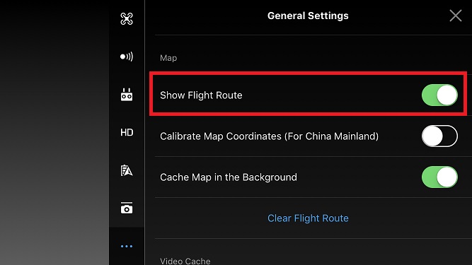

Ok guys, New Advanced user. All firmware updated. Using the Samsung tab A 7 which is recommended. Everything is working good except when I fly the little map box in the left corner of the display does not draw the flight line. It marks my home point instantly and all gps is working on tablet. Is it supposed draw the flight line? If so any idea why it does not show on mine? Thanks Mike
It does not draw a flight line for manual flying.
You should be able to see the flight path on the map if you enable the "General Settings" --> "Show Flight Route" setting in DJI GO.
