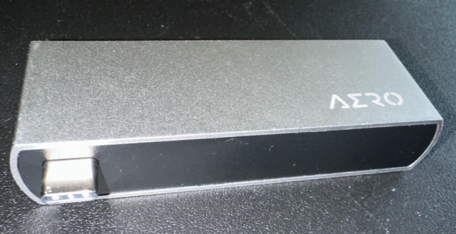

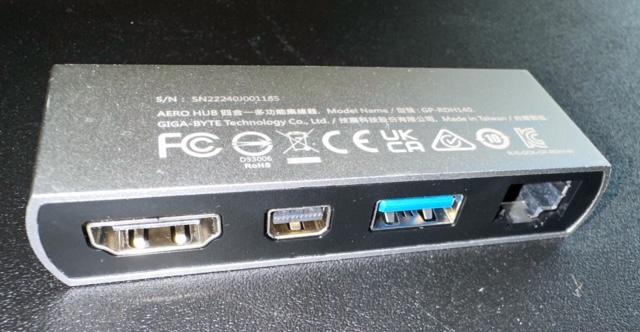

I have the p4pv2+ controller and have used Terra with it. You have to use a laptop with your controller but you can use the computer's USB-C output and an Aero Hub with the HDMI output. I've done this and it worked fairly well.
