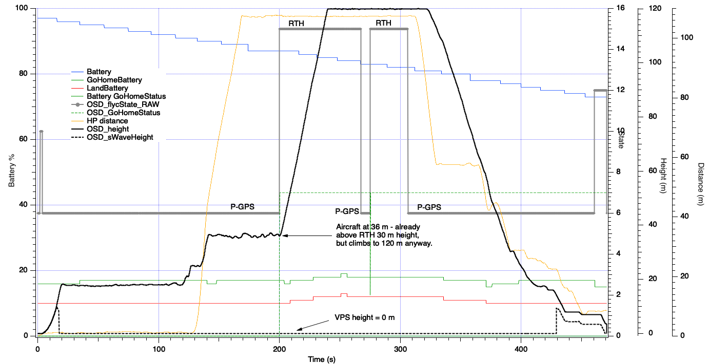

Yes - look at the VPS height. It's zero for most of the flight. The aircraft was above the RTH height when the RC RTH button was pressed, but notice that it climbed anyway until it hit the flight height limit of 120 m. The VPS height was confusing the FC, and it would not start the RTH until it had fixed that, which it never could because it stayed at zero.

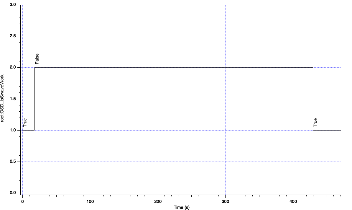

Comparing the data in these two logs with some flights with my own drone, I can't see any difference in the way OSD sWaveHeight is displaying.
His goes to zero when out of sensor range and so does mine.
In the data, the VPS height shows zero when the drone is on the ground and increases as the drone climbs to the limit of the sensors and then shows blank (not zero) when the drone is above VPS height, just the way it normally is.

In this log the VPS data don't go blank - they go to zero. That doesn't seem correct - at least that's not how I'm used to seeing them behave. My hypothesis is that it's climbing because it's seeing zero height above the ground, and it doesn't switch to cruise because of that. I'd have to dust off my P4 to test that however, if you think that zero for VPS height is normal when out of range.
The Phantomhelp viewer, seems to be able to tell the difference and shows N/A when the drone is higher than VPS range although the spreadsheet data shows zero when on the ground as well as up high.
Interesting. I'm not using PhantomHelp - I'm just reading directly from the file, and that shows zeros. I doesn't generally do that for out of range.
I don't understand the VPS zero height data, but looking at the sWave flag you are correct that it should be ignoring it.
