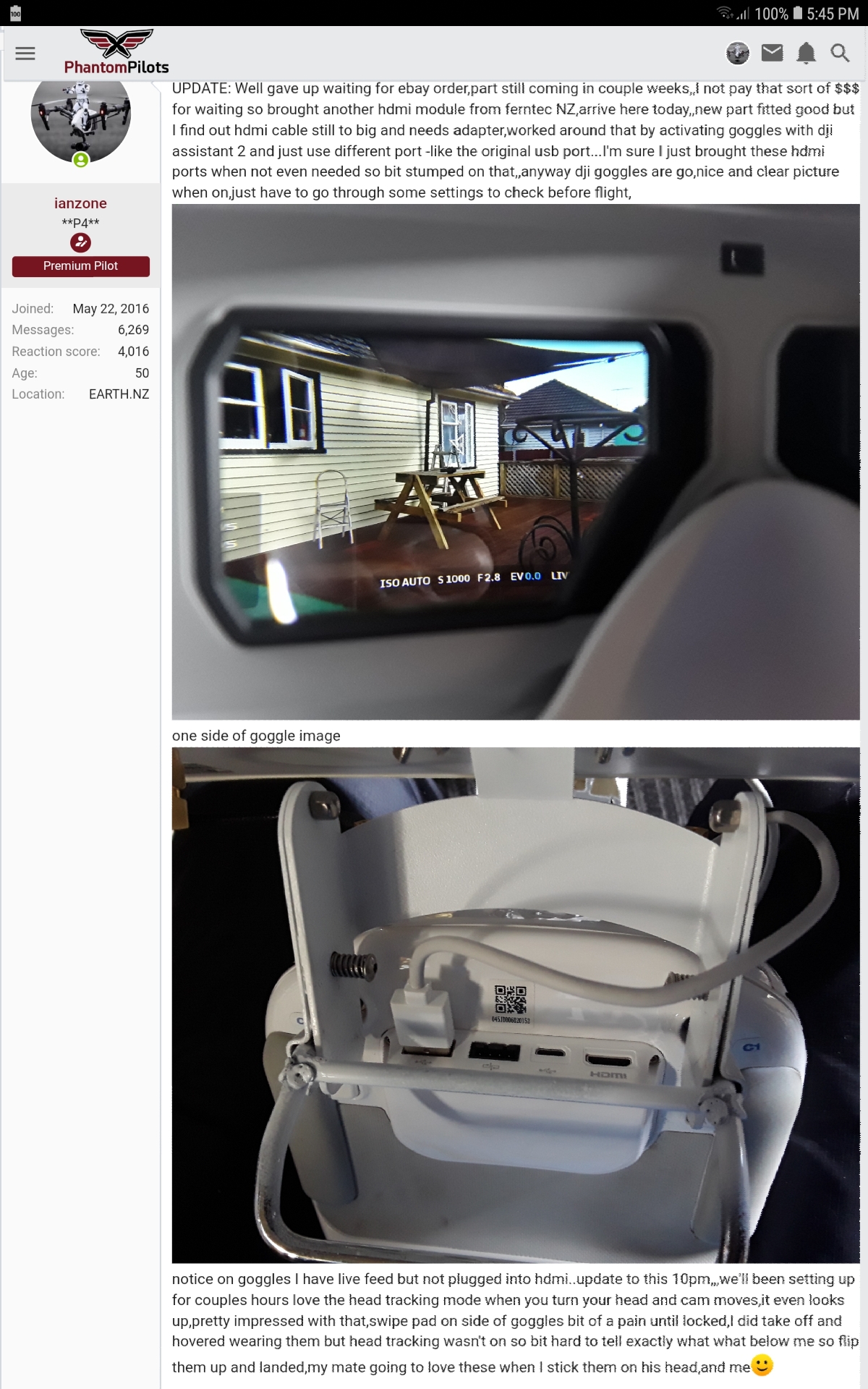

Just off my head I did have dji goggles but didn't like them,,,,I also upgraded my USB module but also had to use hdmi adapter in hdmi slot(mini USB on module ) and used other USB for device,,is this how your set up
This how I used mine before I got hdmi adapter
