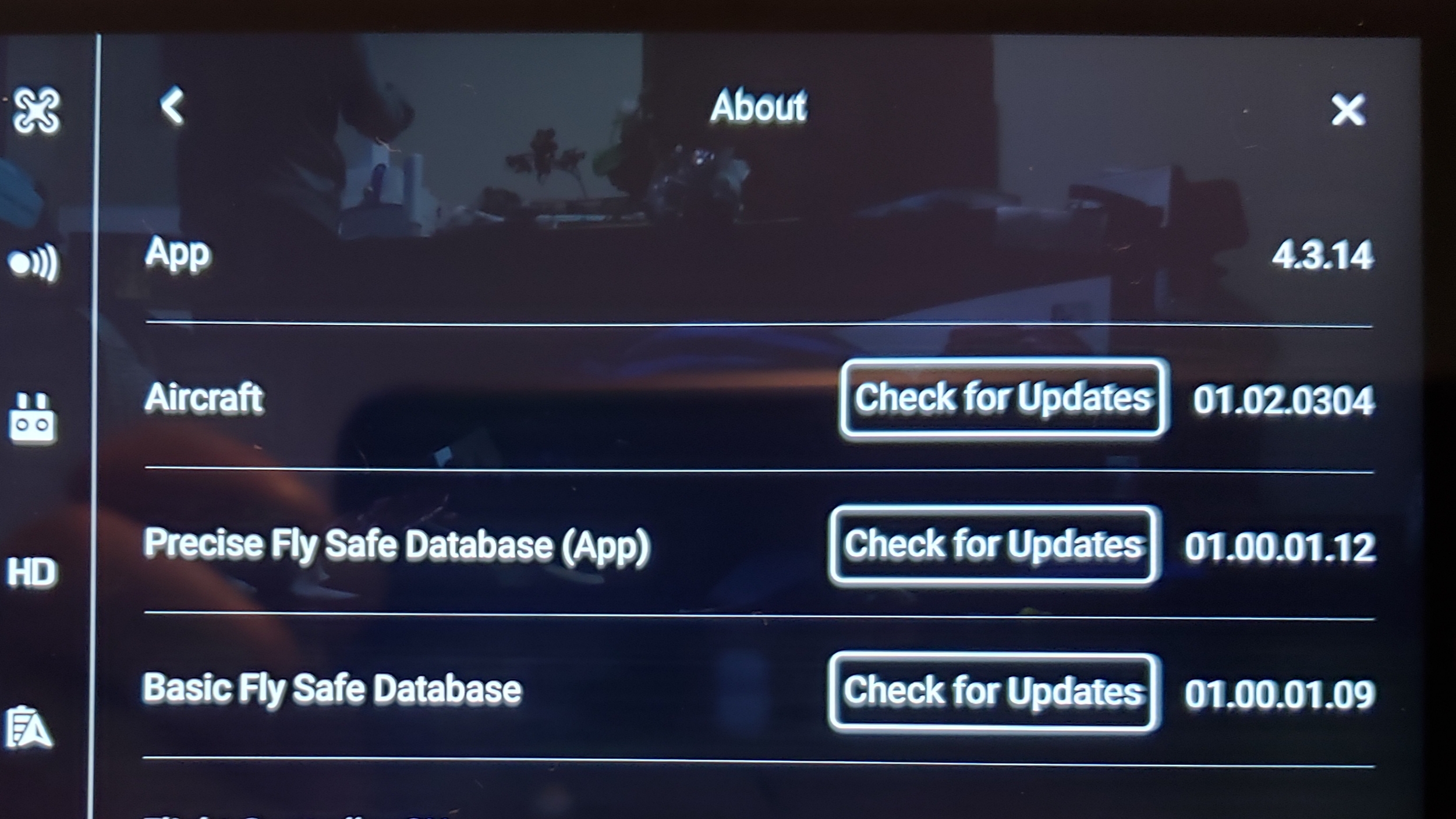

Anyway to know what firmware # came with the controller? Really need to downgrade the controller. Dji go on android won't see the RC.
Ok here is the whole firmware pic

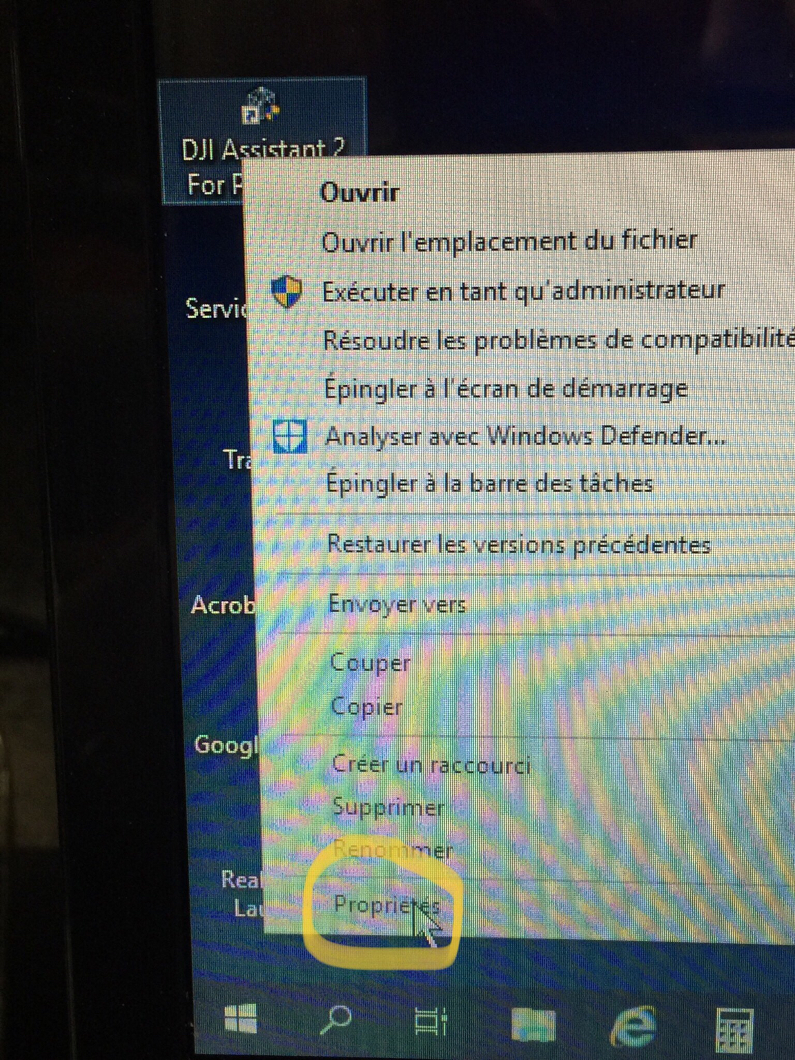

Corresponding to each picture:
- Mouse right-click on DJI Assistant icon
- click on Properties (last line)

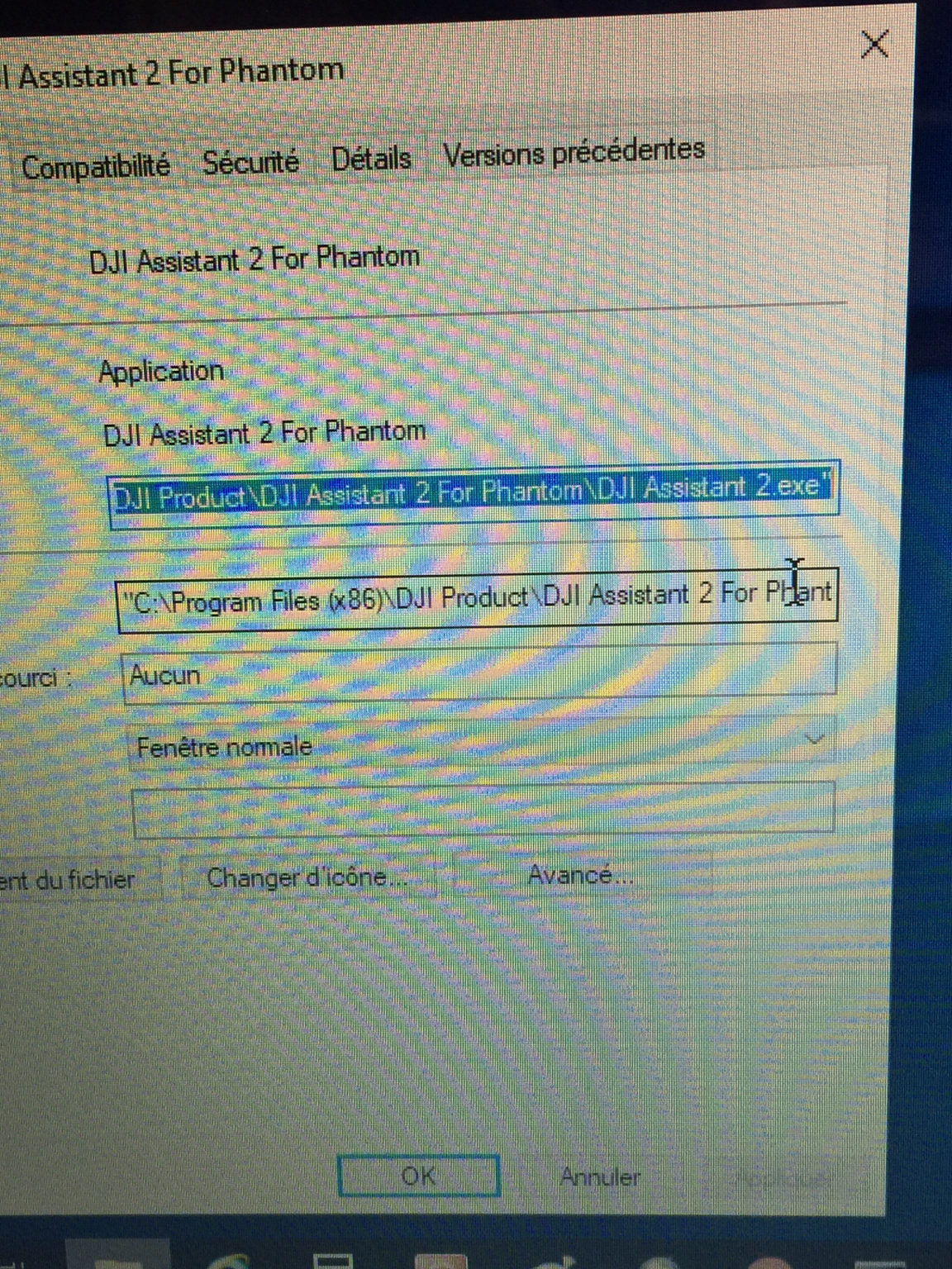

- copy the first line to capture the path where the program is : ctrl+c
- close this Properties Window

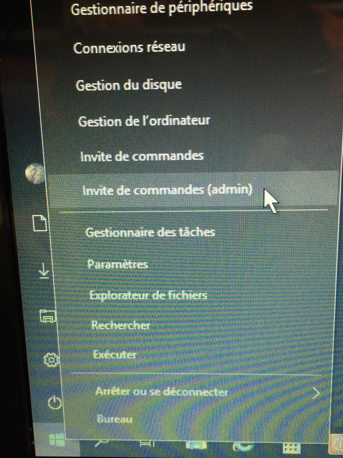

- mouse right click on taskbar Start button Windows icon - or press Windows+X keys
- choose Command Prompt (Admin)

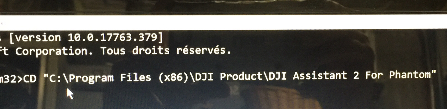

- type CD and path as shown in picture: ctrl+v to paste path within “ “ (See picture)
- as response, path is now shown in next line: you are in DJI Assistant directory

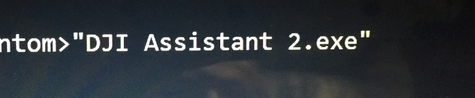

- type DJI Assistant 2.exe within “ “ and press Enter (name must be within ““) see picture

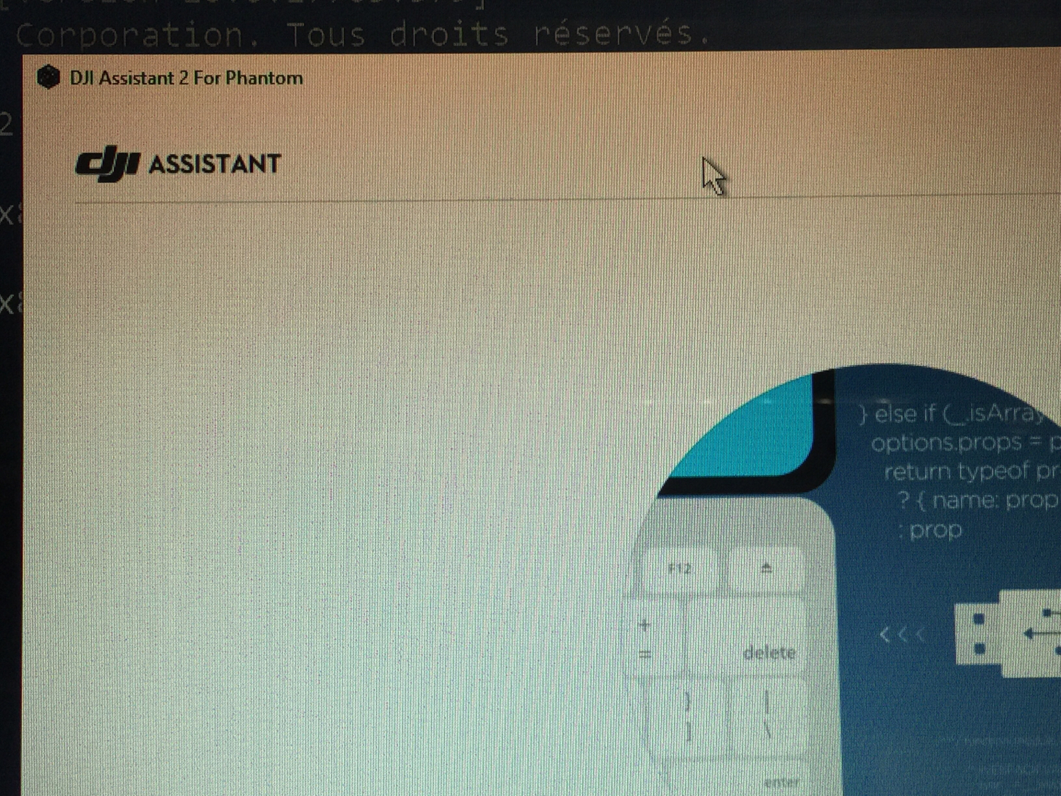

- after few seconds the DJI Assistant is displayed as I’m showing in last picture.

oh my it works!!! Thank you so much! Can I share your instruction?
Yes, this is not a cheat, it’s just to allow app running until digital certificate renewal is solved by DJI.
