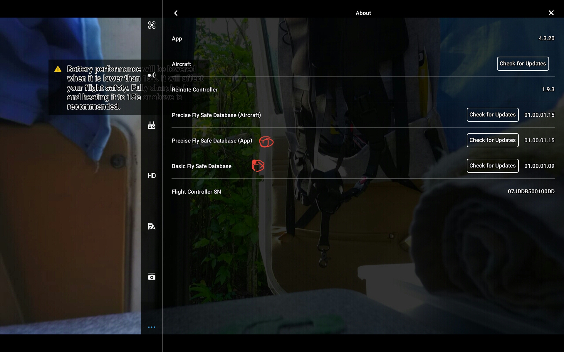

How do I update the geofence database without updating the firmware?
Could check for update here.I'm sure it one of these..well I think it one of these
