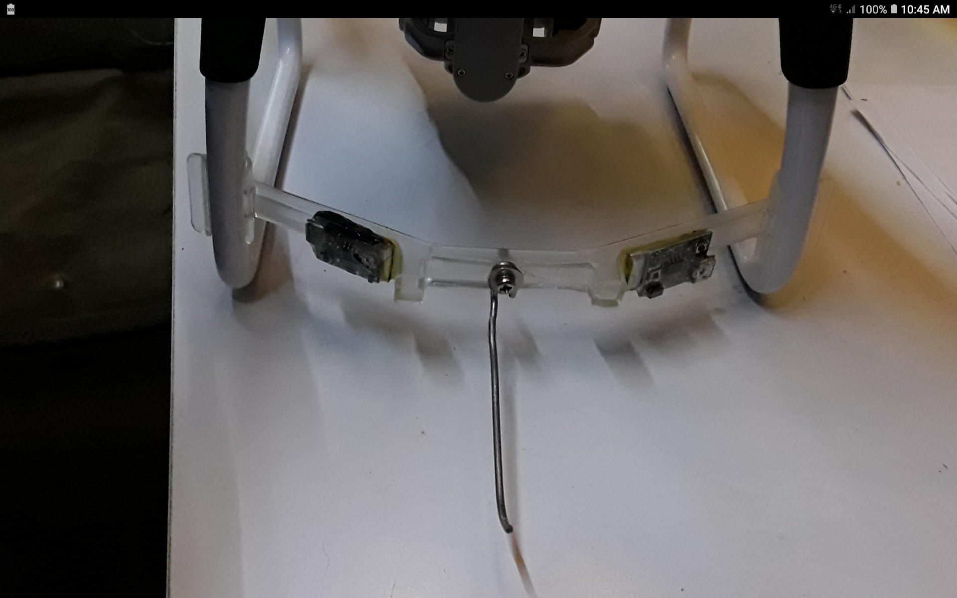

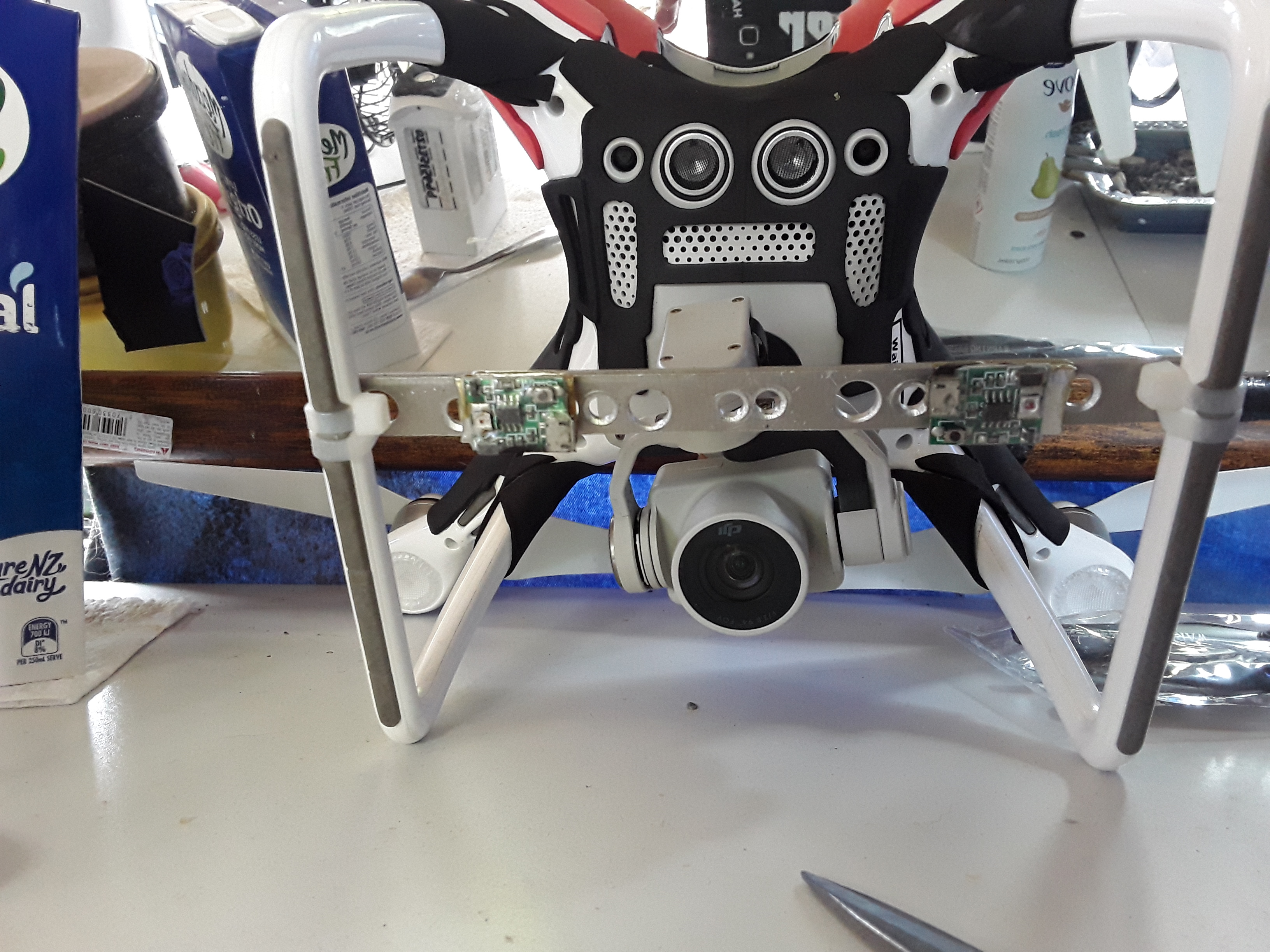

He's what I used...its picture was first invention, good if use light tackle or it bend and break...2nd pic is how drone is now,for fishing and line clip and swivel clips on alloy that I cable tied on,works very good...its also holding me strobes
Reactions: PVRNZ and Capt KO
