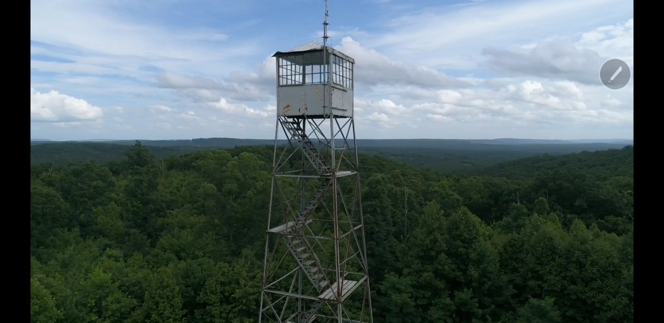

Not automated, all by video control. Also, looking to lanch 2x at a time, one for north property, one for south and have 2 established landing zones to prevent unneeded battery waste with return flights
Attached picture of tower for your viewing pleasure

That's a mighty nice looking tower. Have you launched from there before? I am guessing you might have compass problems launching from there with all of that metal around.

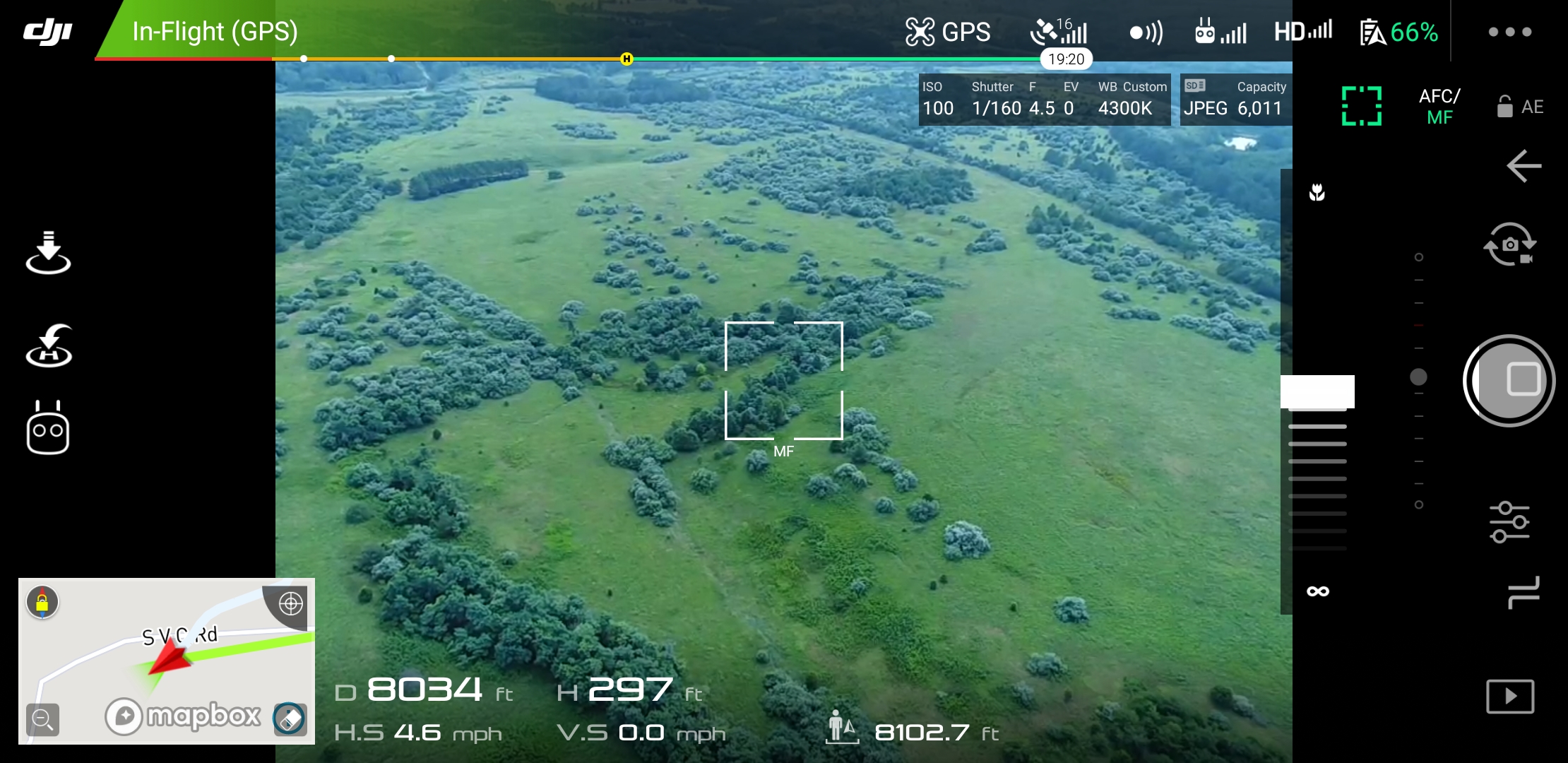

My personal record with a stock battery on a P3 Pro is about 4.1 miles --- but that was under ideal conditions where it was absolutely calm, and I barely made it back to the launch point with only 2% left on the battery. I was also using the FPVLR dual-amp booster kit to get a solid FPV signal the whole way out.
I would say getting 4-5 miles range is going to be tough unless you get a battery mod that will get you an extra 5-7 minutes on the flight time, and you are also flying under calm conditions. Otherwise, I'd think about fixed wing foamie where you can get 45+ min. of flight time.

Here is a screenshot from a stock distance test today. Ordered some windsurfers and ill try that... I may need to contact titan drones also! Thanks
