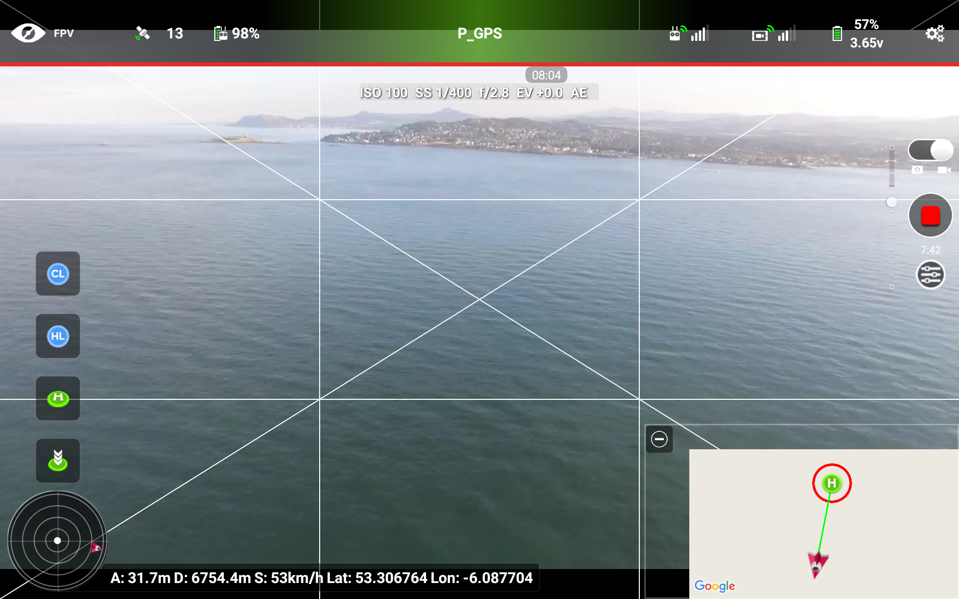

Here is a screenshot from a stock distance test today. Ordered some windsurfers and ill try that... I may need to contact titan drones also! Thanks
Either was windy or went out in sport mode? Start the test later in that battery ?? Usually in p mode i can be out between 18 to 20,000 ft with 66 % left...that is if i start with 100% and cruise straight out.

I turned at 65, will try 60 next time - no wish to lose it in the water though
6754.4 metres or 22,160 feet outbound and 13.51 km / 8.39 miles return - landed with 8% - won't seek to best this
