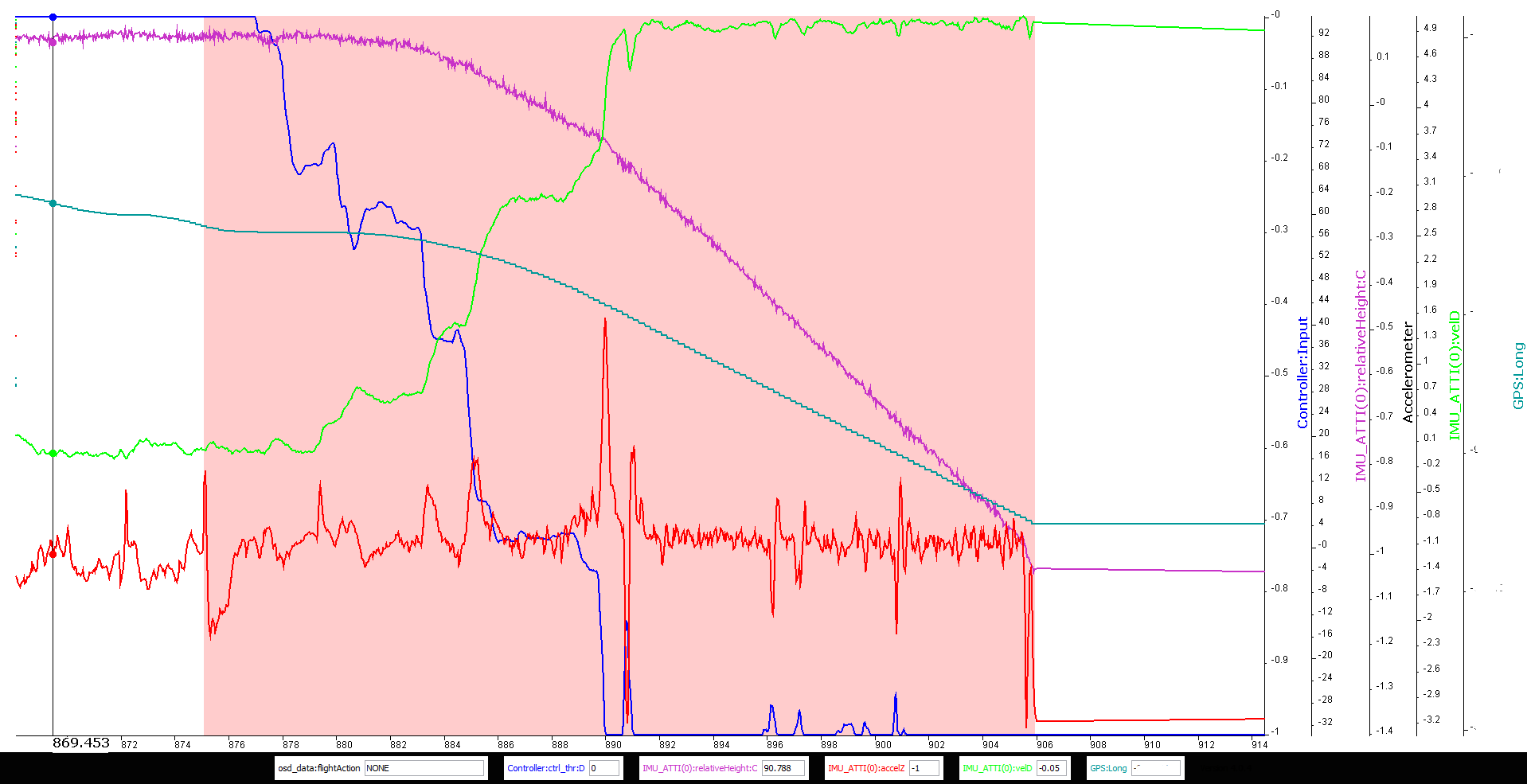

One of my pilots flying a mapping mission (GS Pro) and P4Pv2 went into "Smart Power Go Home" mode. P4P was about 0.25 mile from PIC when in it went into RTL. As it was returning, he applied down throttle to bring it down as it returned. (This is somewhat standard procedure.) I think he didn't have it in site and flew it into the ground.
I pulled the DAT file from AC. I extracted the data using DatCon.
Can someone verify that the Controller:ctrl_thr: D represents his stick input?
RTL started at 875.104sec
Ground impact at ~906 sec - battery was ejected.

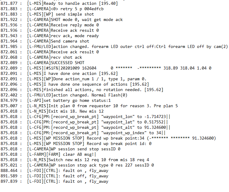

There are also 3 "fly_away" messages in log (see screenshot below) that occurred during the decent.

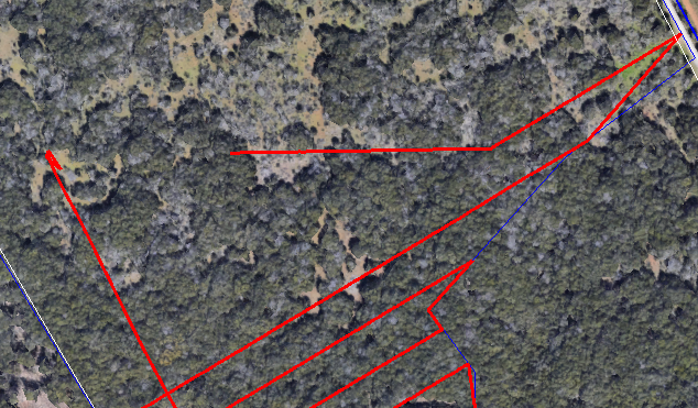

Trees have been cleared since this image was taken.

Controller:ctrl_thr: D is the thrust setting that is being used by the FC. Almost always it's the just the control stick input. However if the P4Pro is being flown by a WP mission the control inputs used to implement the mission can be found in the serial_api_inputs record. So in this case Controller:ctrl_thr: D will be a combination of both serial_api_inputs:sdk_thr_z:D and the RC thrust input (which doesn't appear in the P4Pro .DAT).
Looking at your chart my guess is that Controller:ctrl_thr: D reflects just the pilot input. If it were under mission control I would expect it to be constant - at least step-wise constant.
Can you provide the .DAT? I'm kinda interested in the fly away messages in the eventLog stream.
Thanks. Sent link via DM.
