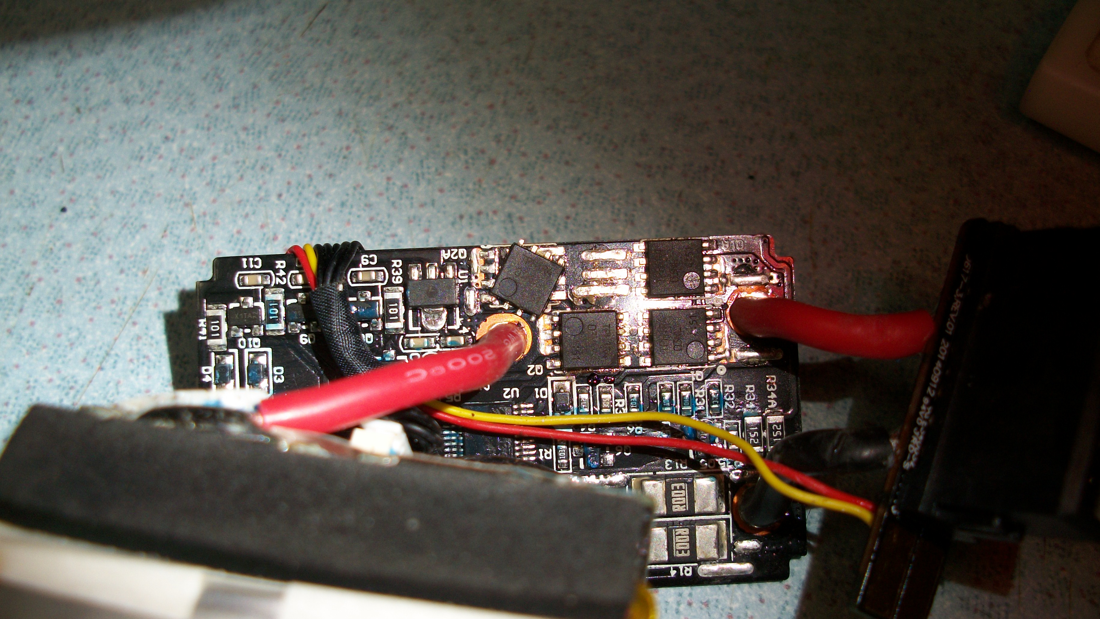

Now on to what I have learned from the dissection. which is that there is nothing physically wrong with any of the cells and the problem is in the stupid not to smart circuit of the battery. Just like the problems with the p2 batterys mostly all stem from which is the stupid bad idea smart circut. The area that was getting ripping hot was all up on the very top and no were near the cells them selves. But when I opened it up and looked around inside the circuit board one component on the top of the upper board was so hot that it would of gave me a nice burn if i touched it for more then a split second. Tho on closer inspection it was actually some thing else on the bottom side of the board were the heat was coming from and it was so hot that the part had actually soldered its self and it slide and turned almost 90 degrees from were its supposed to be positioned. Tho what i cant say for sure if it happened during the discharge OR if it happened during the time I first tried to charge it after. My guess is that it got hot from the initial charge being that thats when the most amps are being applied and tapers down as it gets more charge in the battery...
Even tho I am not an electrical engineer what ever this part is or does( I'm suspecting its a diode of some kind) But what ever it is I know that THIS is not how it should be on the board. lol But for snits and giggles tomorrow. I'm going to try and see if I can resolder it back on right just to see if it will start taking a charge again or not. If it does then I can find some use for the battery some place or if not I can still use the cells for some thing some place. So its not a total lose either way.

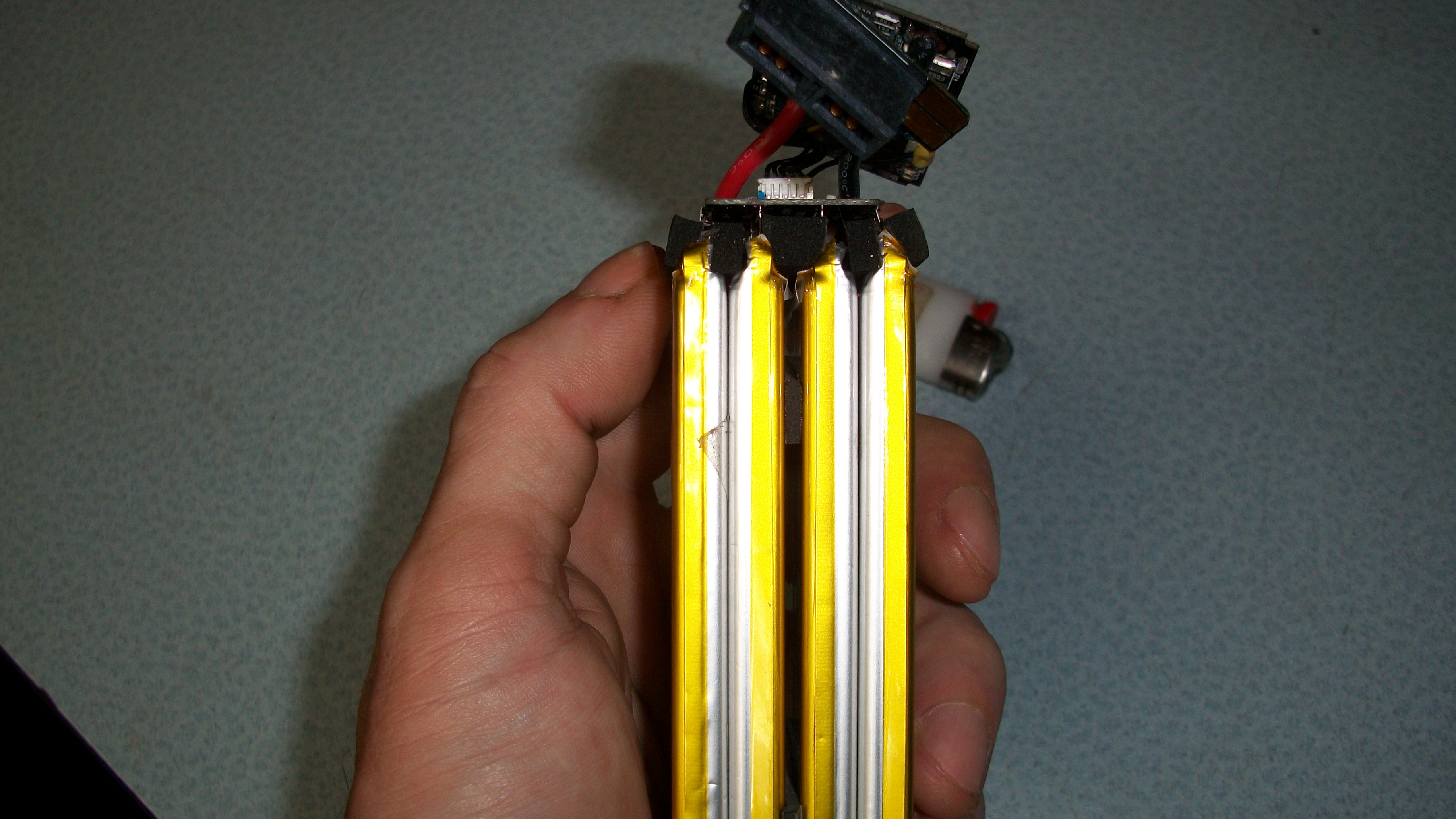

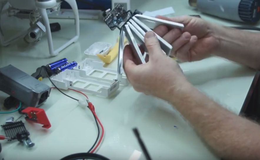

Now to any one thats been wondering if the p3 batterys are a real 4 cells instead of being a 2x4 like how the p2 batterys are not really true 3 cells and are really 2x3's I can report that the p3 is really just 4 cells.
and some thing else I noticed was also different about these p3 battery's that I noticed is different then the p2s which is the gray sticker thats wrapped around the outside of the cells that you can see when you look threw the cage.. on the p3 its not really a sticker and is infact 2 pcs of thin gauge sheet aluminum. Now I dont know if they changed to being metal instead of paper for some sort of heat sinking effect or if they some how thought that it might help hide some swelling. Or even to just give it some more protection then just a paper sticker could to prevent punctures and what not. Tho i suppose it could be a combo of all of them.
Even tho I am not an electrical engineer what ever this part is or does( I'm suspecting its a diode of some kind) But what ever it is I know that THIS is not how it should be on the board. lol But for snits and giggles tomorrow. I'm going to try and see if I can resolder it back on right just to see if it will start taking a charge again or not. If it does then I can find some use for the battery some place or if not I can still use the cells for some thing some place. So its not a total lose either way. View attachment 28427
