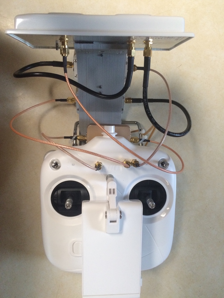

Is there anyone around that does the DBS mod (i.e.: send the controller out for them to do it - charge for the equipment and for the mod itself)?

Yeah,send it out to me, I'll do this to it!

MaxxUAV does it for $100. But honestly I think most people can knock it out... Go slow and research.

If you buy from MAXX UAV, Jake throws in a set of Antenna Pass Through's... These take one of the hardest parts out of the install... Drilling the stupid holes.
I like the plugs because if PUSH CAME TO SHOVE, you COULD, put it back to stock assuming you didn't "clip" the stock cables inside, like DBS does, you some how save the stock antennas.
Buy from this guy Alaska... His customer service is the best. No one better. Plus he has the "pass through" plugs that eliminate the need for drilling your remote! YIKES... No turning back after you drill it.
Yeah but if were talking about the PIII standard remote pass thru plug is not going to help, because you'll have three SMA connectors to hook up to the DBS panel and the PIII standard remote obviously only has one antenna port
Yeah,send it out to me, I'll do this to it!View attachment 48981
