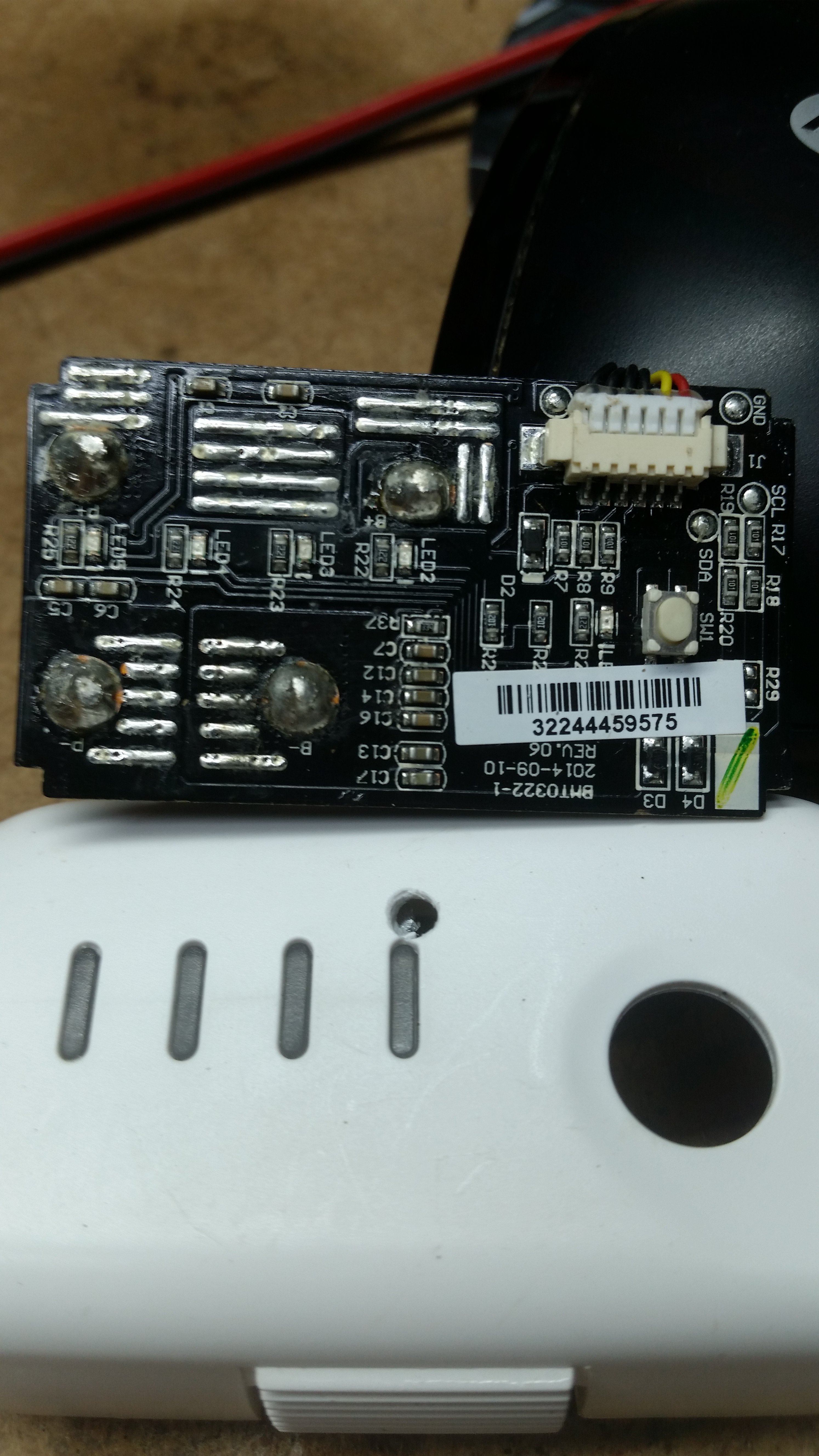

So I popped the cover off (search these forum for how to do that), found the MINUS (-) batt input is direct to the 6 cells, and found the + actual batt terminal is big solder blob right above the exposed batt health led #4. If someone is is interested and really wants pix, I can post them.

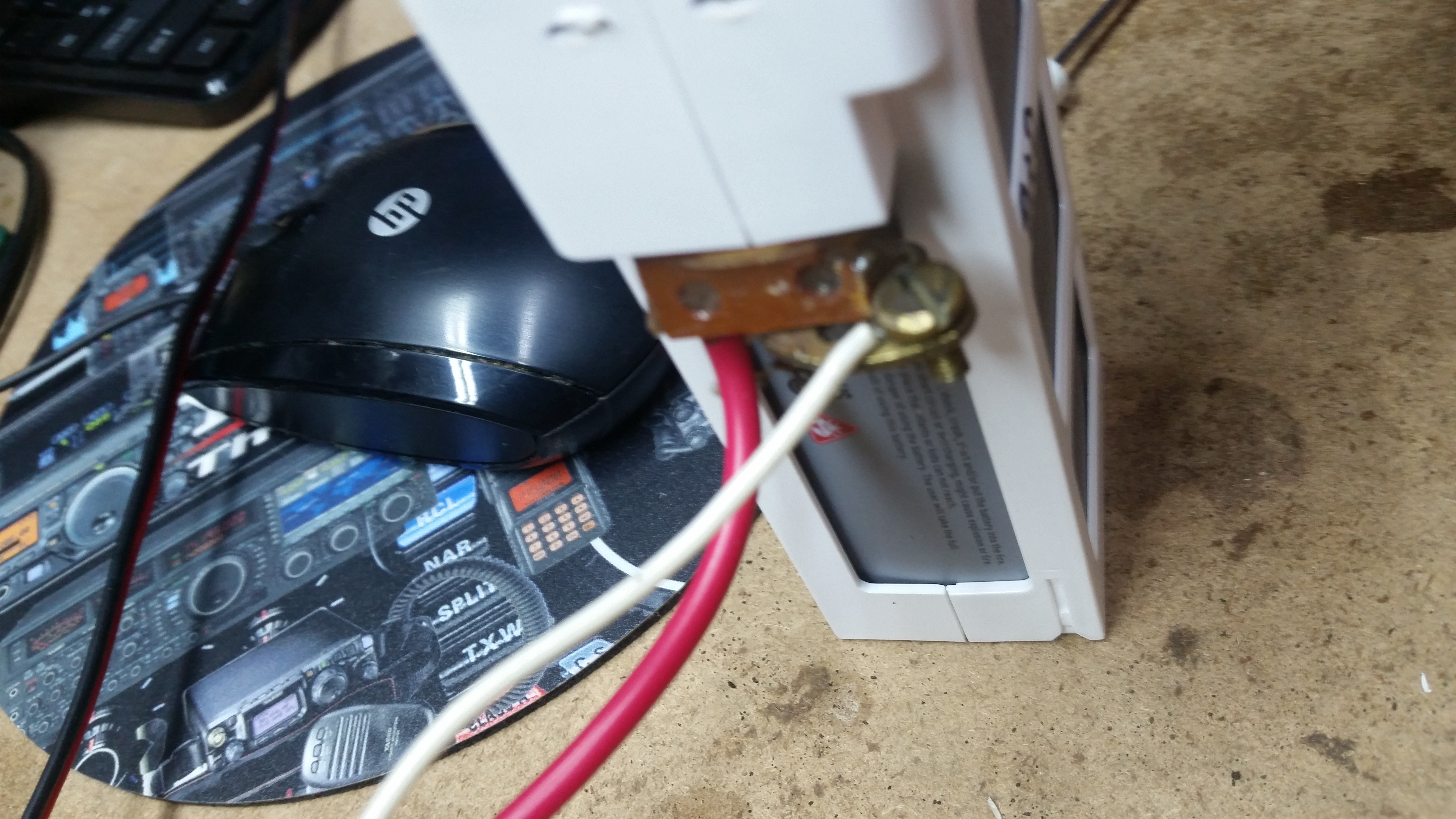

So I put my lab supply to - batt terminal and then other lead to this direct +b terminal... start cranking up the volts... current begins to rise... by 4vdc current would go to 10amps if i let it. Of course I would not. I kept current around 2 amps... watched vdc come up... 4, 6, around here the RED fault led came on! 8, 10, at 10.5vdc or so the fault lite went off and the green first bar came on! I continued for a bit, then disconnected from direct batt cells and let my smart charger take over thru normal 2 batt terminals (after turning it on with 2 button pushes!)... It took off!

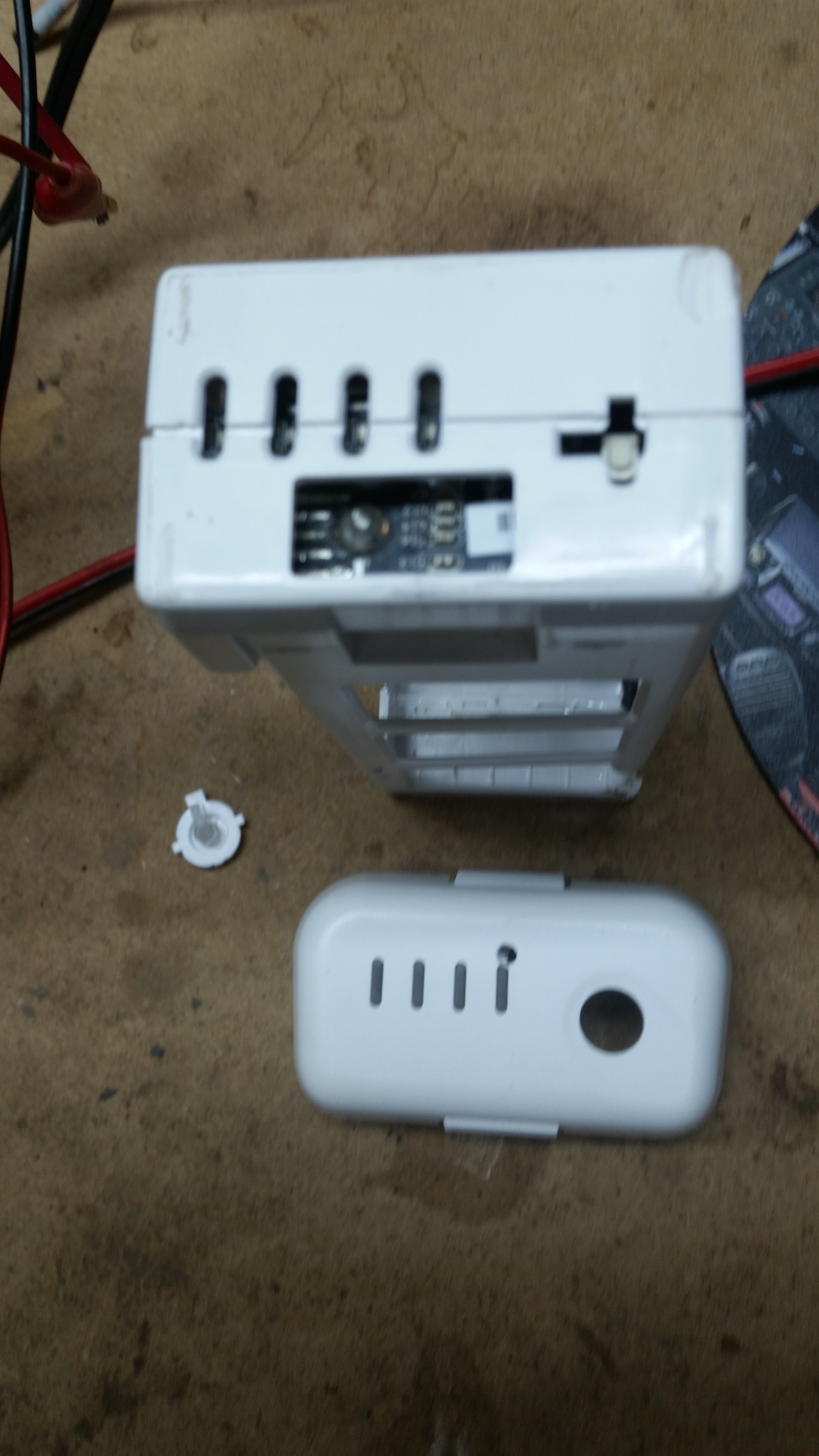

So P2 batts can be jumped by drilling a small (I used 1/8" drill) right above the 4rth (full charge) LED -- CAREFULLY.
I attached some pix showing this.
The minus pin of the batt connector goes directly to the cells. The plug (red wire in my pix) does not - it goes to cells thru series FET switches. So when cell volts drop too low to power the uprocessor, the series FETS never turn on again so you cannot charge a dead battery.
Idea is to drill a tiny hole right above the 100% charge LED - this gives you access to the raw cells + terminal - see pix.
Then assuming you have some sort of variable power supply, you have access across the 6 cells (2 each in parallel, then these 3 sets in series for 6 total), you can try to charge the cells...
