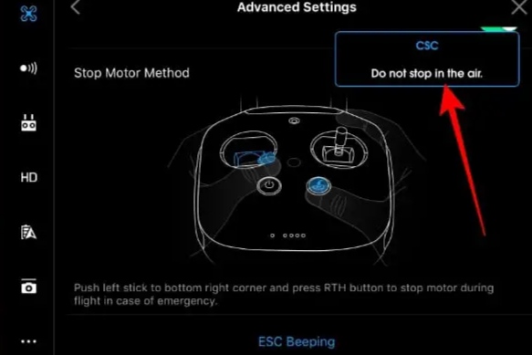

i was performing an expirement with csc.. ive selected "do not shut motors midair" in app and then started motors up (performed in a controlled enviroment.. do not try it) hit csc and guess what.. it worked even if i had chosen not to shut motors..
cant understand why app tells you that its not gonna shut motors midair if you hit csc in an emergency..

correct.. ive chosen "not stop motors midflight" in app.. and seems that dji had fooled us.. two in app choices.. csc or not csc but drone reacts same in both.. cuts motors midflight if you perform a csc..

well.. if you ve chosen "do not stop motors" and hit csc it does shut them down even if its not supposed to according to the app

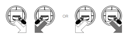

That's what I understand too. And I'm assuming he is doing this:
And not this:

As I remember pushing sticks down and in the corners won't stop the motors in the air.
ive put left stick down and in and pressed rth.. it stopped the motors.. ok??
what if you ve chosen in app "do not stop motors midair" and csc works?? thats what im tryin to talk about.. an app flaw as drone stops the motors even if you ve chosen not to..

the whole expirement was about the app whitch makes people believe that csc wouldnt work if they check the option "do not stop motors midair"
i believe that pilots have to know that safety features work whatever they choose for that case.. motors are goin to stop whatever their choice was..
my objection is about a lie in the app
Absolutelly agree. The firmware is misleading in this case. But the result is what it should be.

even if ive checked "do not stop motors in the air" on app.. csc works as there wasnt such a choice.. i dont know why dji is making people think that it doesnt work..
I havent updated in many years so I can’t personally confirm, but my understanding since that option was added is that it prevents ONLY the two stick CSC method from stopping the motors in flight. The stick plus button method, being a much more deliberate (far less accident prone) method, ALWAYS remains a means to stop motors in flight for emergencies. It sounds as if that is what you did, so in my understanding of the app options your Phantom performed as expected.

hello.. ive tried the old way csc (nobody have seen the attached log 🙄) checked in app "stop motors midair" tried and again checked "not stop motors midair" it didnt work as its fw says to stop motors only whith stick down and in and rth button press..
its clearly a language misspelling.. ive seen someone who wanted his bird down right away as it started raining and for some reason pressed rth.. he crashed wondering why that happened as he had chosen the in app option "not stop motors midair" .. care covered evereything but we stayed with the question why there are two options if the csc order is the same in both situations.. if you choose "not stop motors midair" theres a pop up message saying that if you do a csc nothing is gonna happen to prevent an accident.. go figure..
... ' ive seen someone who wanted his bird down right away as it started raining and for some reason pressed rth.. he crashed wondering why that happened as he had chosen the in app option "not stop motors midair" ....
In the situation you described. he wanted to get the bird down as soon as possible so he push the left stick down (in a hurry the stick easily slips to the inner corner) then he pushed the RTH button - and here we are. The drone reacted as it should.
This is what we are talking about in the whole discussion here - you can not cancel this safety measure! The option in the software is misleading, yes, but with no harm. Who right-minded would do that midair with no reason, just to check it?
