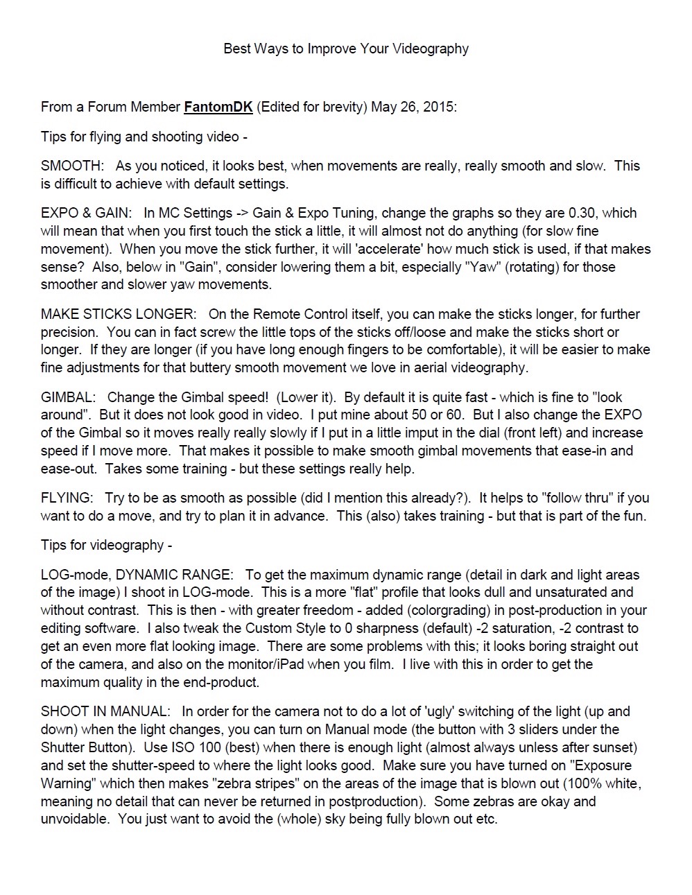

I loved the video....your doing great....I tweaked my video setting and reduced the sensitivity on the flight control sticks of my P-3SE 4K....Now my videos are buttery smooth...For one you can make the sticks longer.to slow the throw....they unscrew and their a small lock nut below the upper part so you can raise it and lock it back down with " fingers only " theirs also a setting in the right control panel that will customise the sticks movement However i like the extending of the sticks better its easy to go back to the normal setting all the way back down and locked with that small nut !....Try that and Good luck on all future drone flight and Videos too.

This really Helped make My Videos "Buttery Smooth" !
