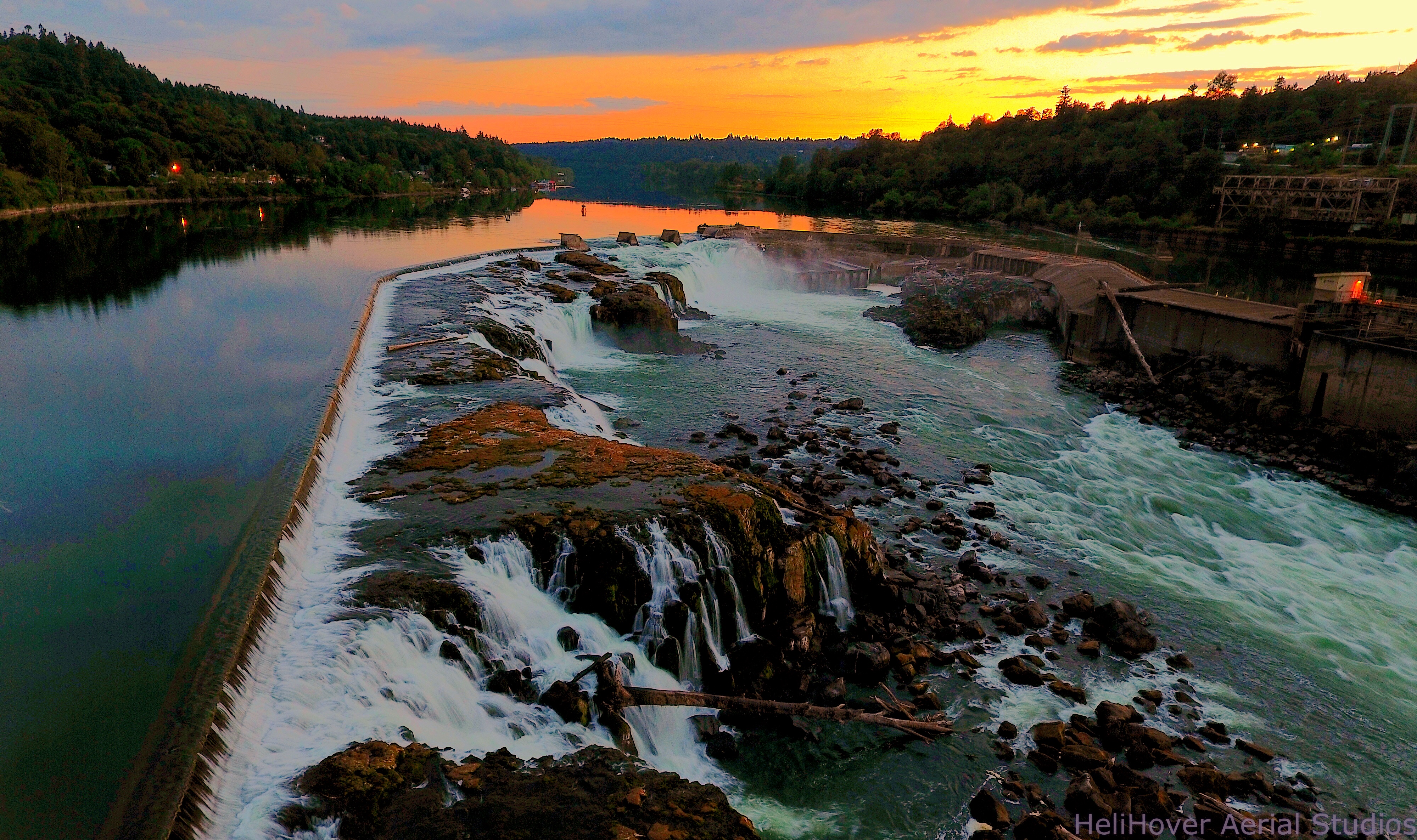

This is Willamete Falls in Oregon City, Oregon. It's about 5 mins from my house and I love shooting here. I'm working on a pretty cool video right now, but it definitely won't be finished anytime soon:). Here's a still I got a few weeks ago.
I agree that it looks like a high ISO and some funky color grading but I LOVE the night for day stuff that the P4 does quite well. This looks sort of surreal and I dig it. Nice work.

the colour is bit grainy and you can see the red dot from the photos, did you using a high ISO? still looking great though ..
I am still struggling as well, when i am taking photos from my drone.[/QUOTE
There's no ISO here. It's a t 100. This pic is way over edited. It's a fun pic I like to show. The grain you see is from editing. But thanks for the compliment's guys! Keep em up!
