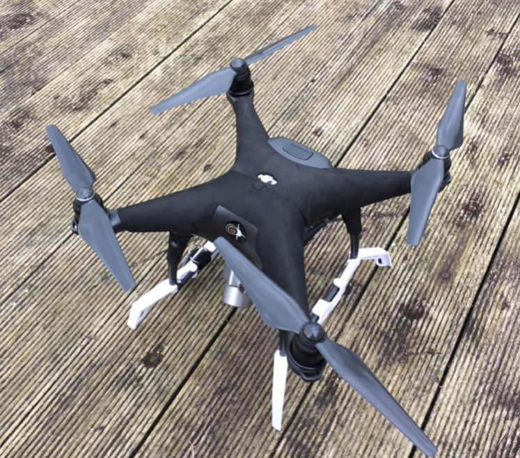

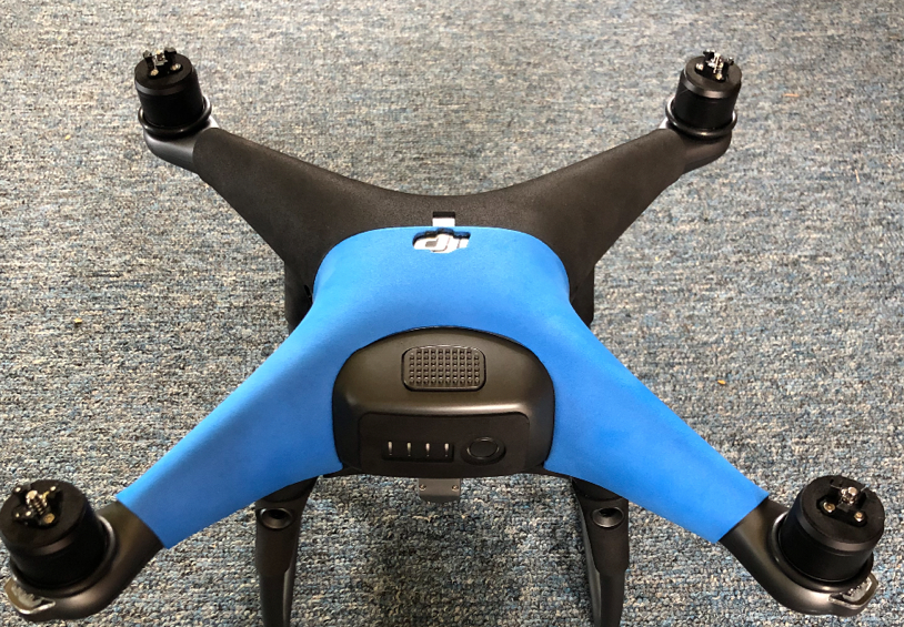

Depending on where the crack is , you can seal that up caulk and than wrap that up with the Phantom Wet Suit to give the Drone some added protection and protecting the crack.
The Obsidian looks amazing with the Wet Suit and offers some extra benefits as well.
