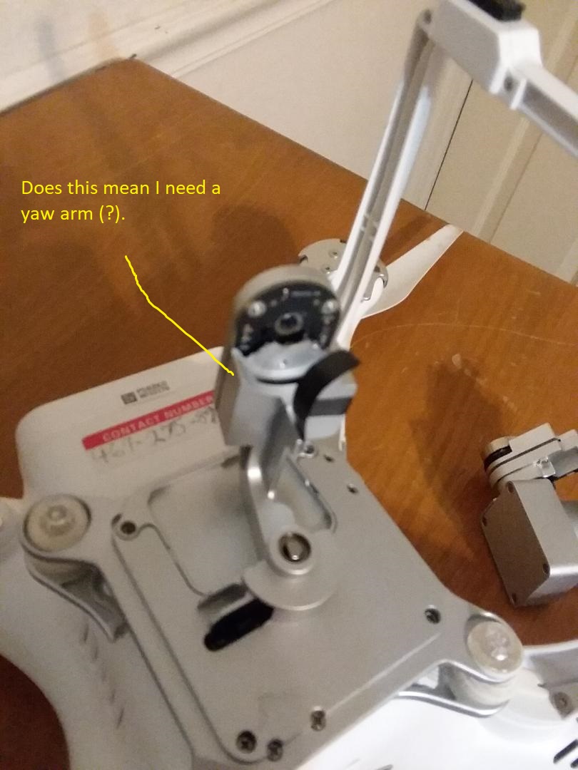

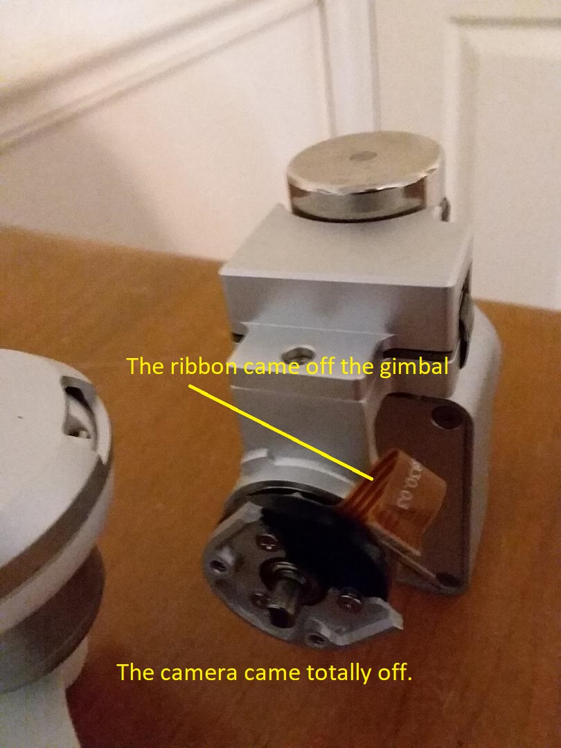

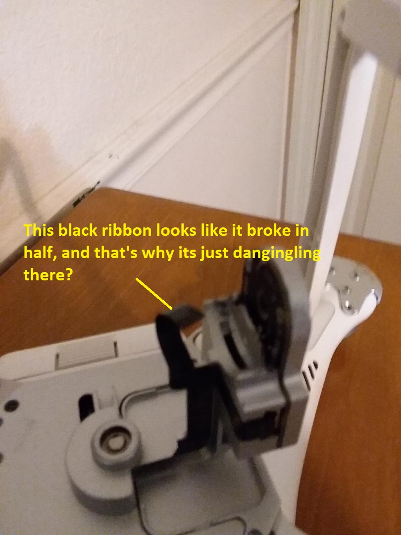

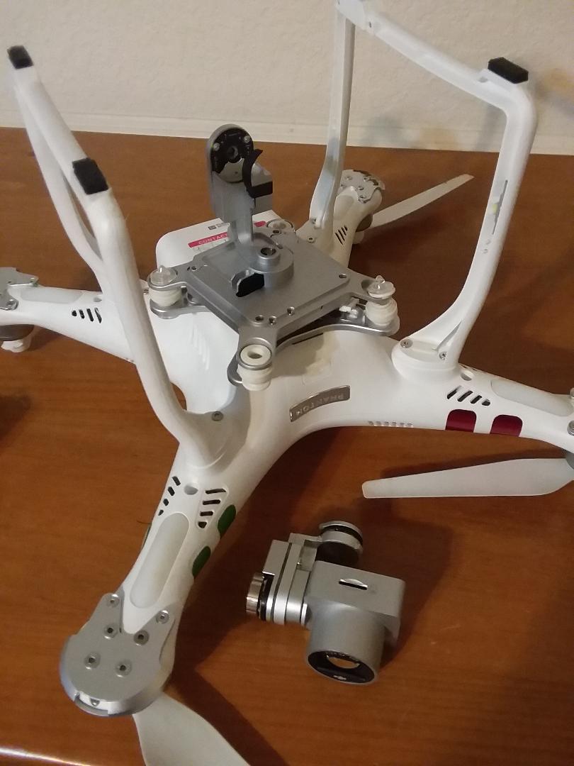

The nice guy helped me get it down, but the 35 foot drop did the damage shown in the posted pics below. Battery is fine and the drone still does light up when I power it on and the familiar beep. But the camera came off and the gimbal took some damage. Also the mounting plate and the Yaw arm (if I called it by the right name).
So, I wanna fix (try to at least) myself. Based on what you see below, do any of you have any thoughts? I am pretty sure I will need these, so I ordered them:
Do you guys have any other suggestions based on what you see below? I tried to label each picture with what I saw damaged. Should I buy one of the YAW kits on amazon? Also, the wire that came out, I wonder if that's hard to get back in the gimbal (I labeled it one of the pics below). Lastly, the ribbon thing...anyone got any experience putting it back in, or do I need to buy a new one?

I have viewed your damage and I recommend sending it to DJI,I had the same problem you have now and I worked on the system(camera) for 1 year with no accomplishment.Dji will fix it and it will work like when it was new.The videos on this repair is not as easy as they make it look. I wish you the best luck in your journey!!
Repairing yourself?
I have had mine apart farther than what I see in your pics.
It really depends on the person, the worst of it for me, everything is so small and the 50+ eyesight really sucks and my hands are not small.
Your tablet has a data log until you lost signal, might have something important. The file that has all the data, is on the Phantom, your going to need your Phantom operational to retrieve that, or remove the BlackBox SD card from the main board, it is glued on.

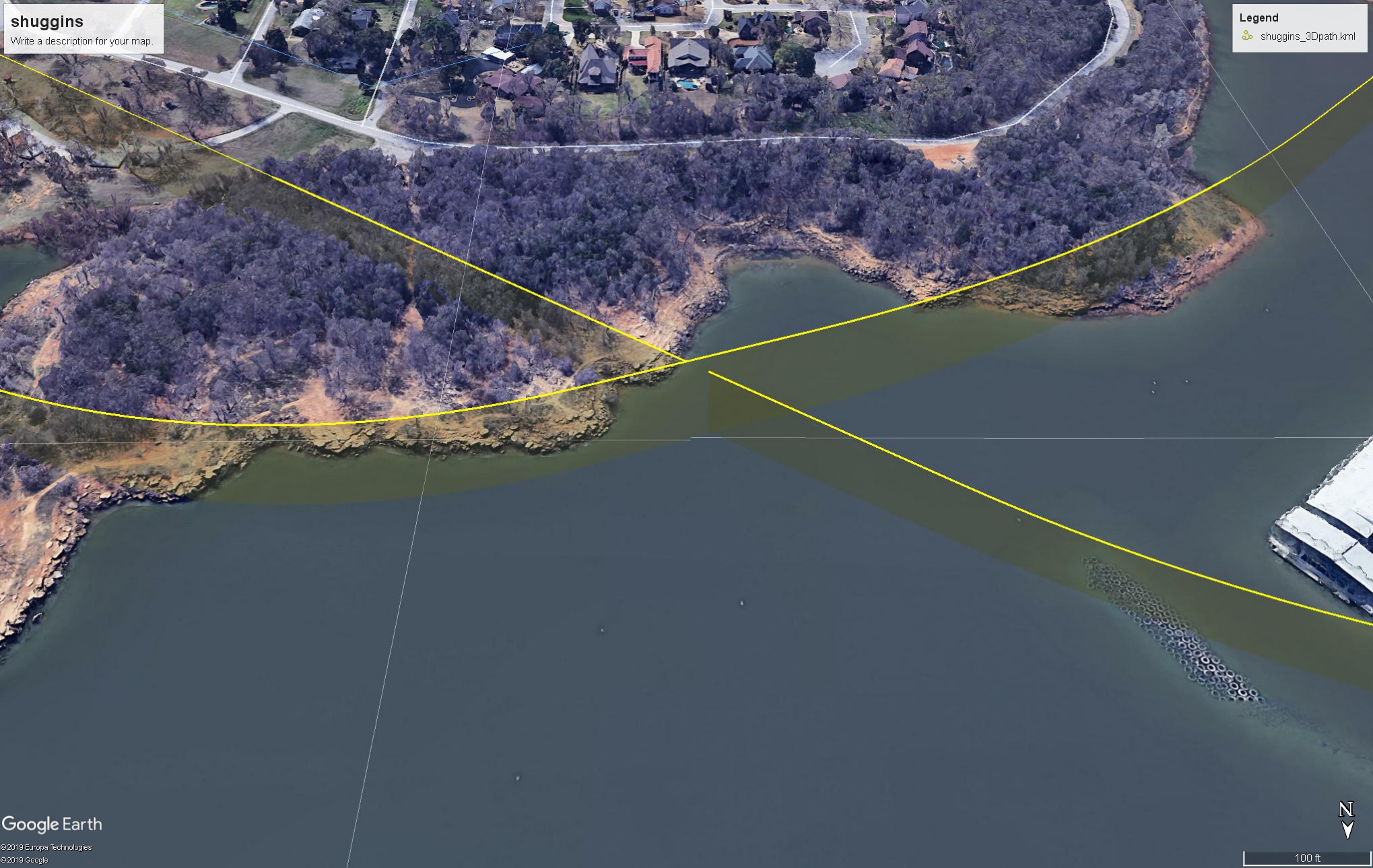

I would look to see your Litchi mission. Share it on the hub like this.

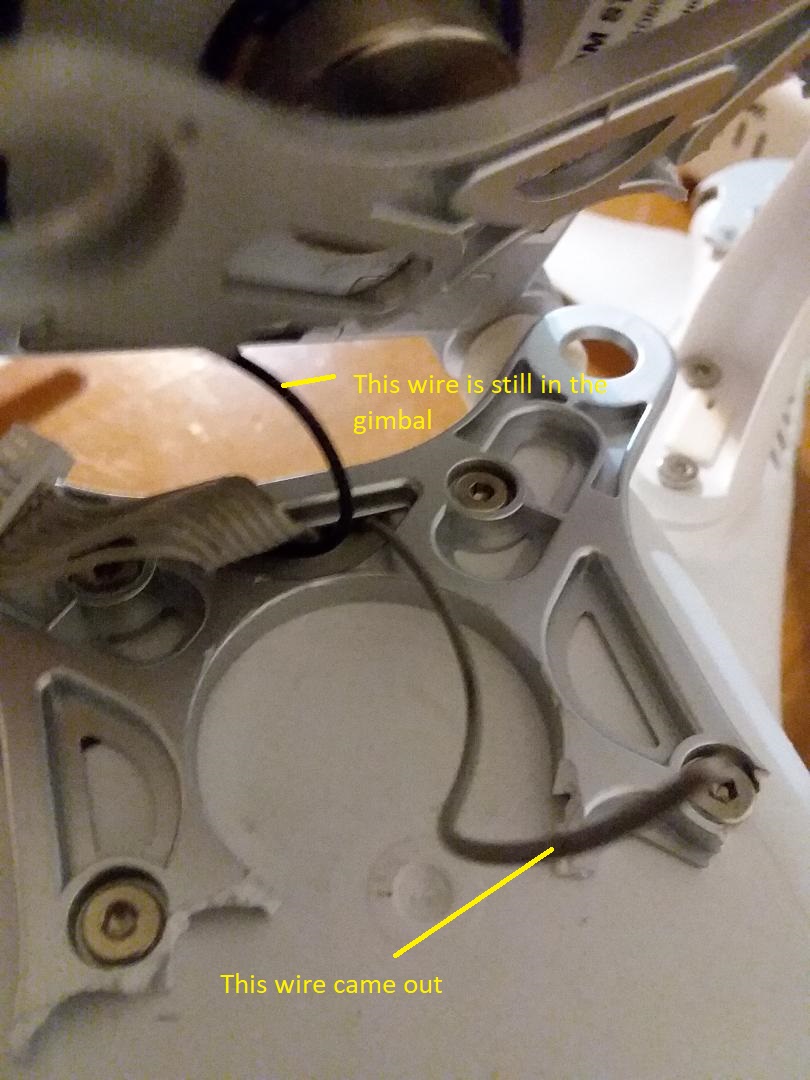

Thunderhorse- yep, I found that out the hard way. I got the replacement parts in this afternoon. The gimbal mounting plate was easy. The black and gray wires with the gold connector at the bottom was brutal! I could not get them on...and when I do, they pop right off. And, they are TINY! My 50+ year old eyes are straining. I've been at it for 6+ hours now. Maybe I need to step away. I have a torque screw set , tweazers, etc....so, I think I've got what is needed to pull this off...except patience.

Quick look at the mission, it didn't record anything?
Unless you manual started it.

Did you start the mission at wp# 10?
Because WP#1 is 17' below that.
Wp#1 through Wp#6 is set at 98'
98'-17' is 81' anything it could it hit a 81' ?
I'm still looking for more.
Rod
Oh No,
WP#9 is 52' - 17' = 35' above Location of WP#10
If you insert a WP 1/2 between it is 88'

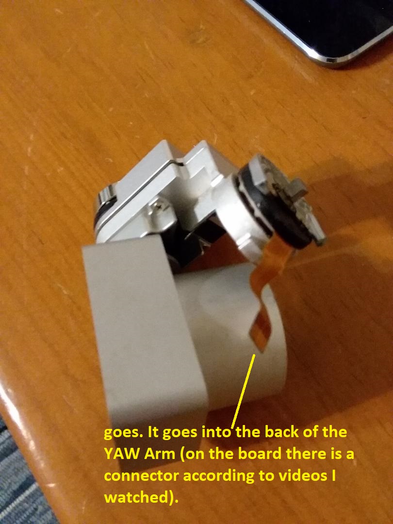

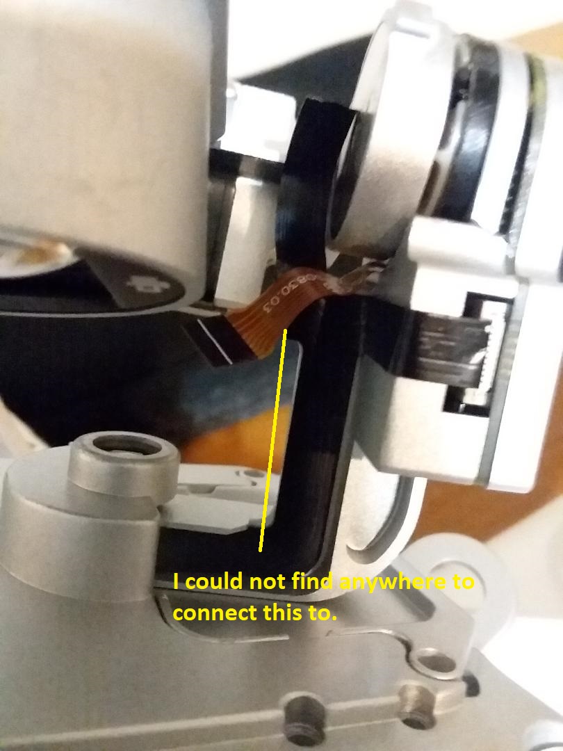

I put the new gimbal mounting plate on reconnected the black and gray wire like shown in utube video, tried to put the ribbon back on the connected, but there's some ribbon coming out of the gimbal motor (if that's what it is???) and I couldn't find anything to attach it to. None of the videos mention what this is? I attached a pic... do any of you guys know what this is for and where it goes to? I still tried to turn it on and Go 4 app says "Gimbal disconnected". So, I think this brown thing needs to connect somewhere (lol, I'm clueless).

The mission that you posted has an action at WP#2 to start recording. But all your waypoints but WP#8 are curved, any actions will not take place.
The AC never makes it to the WP.
So did the Phantom hit the tree between WP#9 - 10?

I think your going to have to take it part a little farther.
I'm pretty sure that cable is suppose to be inside the gimbal, I have been in there also. ;)

WOW. I think you nailed it. My newbie approach, I swung WAY too wide (away from that boat dock) on WP #9 and on it's way to #10, it hit that tree. Also the curved thing on waypoints: I thought it was just so the turns are smoother and cinematic. I thought if you didn't do curve, the turns would be "jerky" looking. Also didn't know with "curved" waypoints it cancels out any actions on the waypoint.

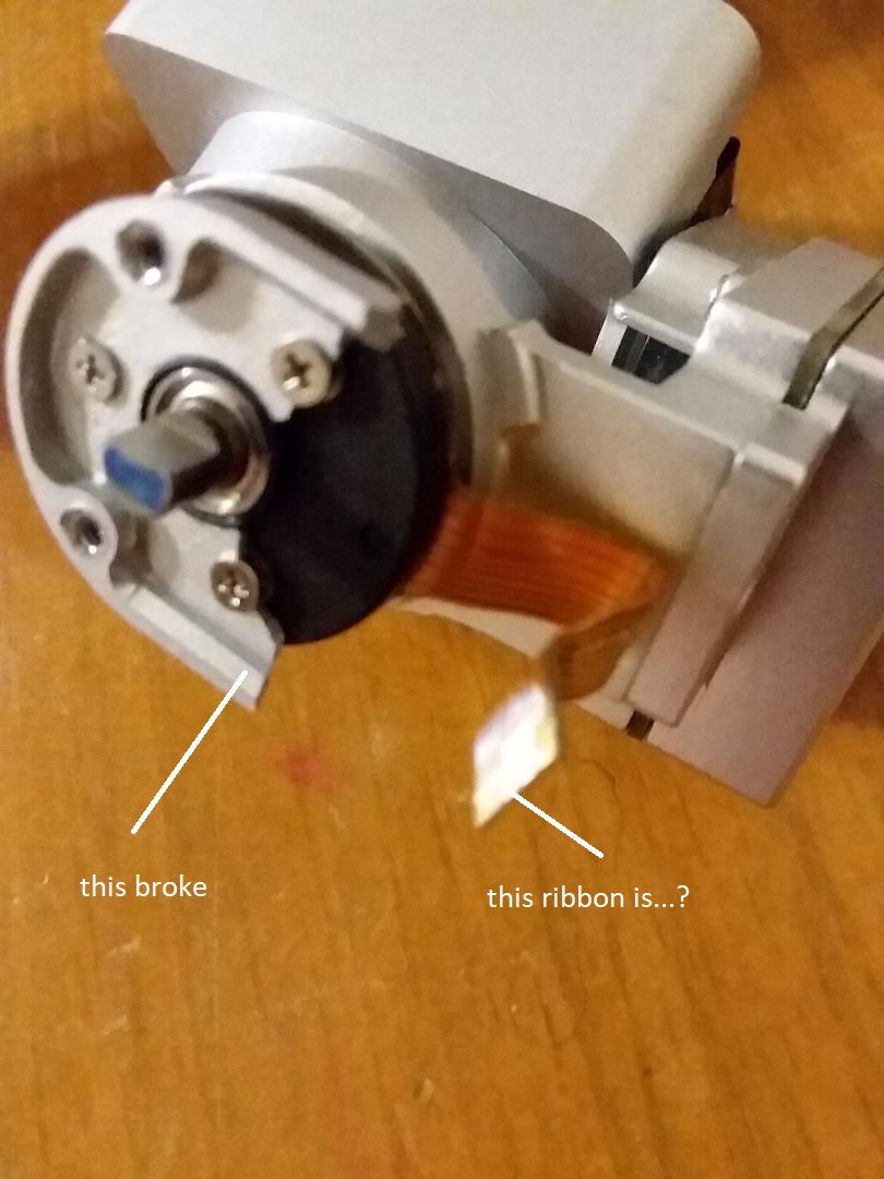

Well, I did take it apart further. I attached two pics. I think based on what I see in the pics, I'm getting the "Gimbal disconnected" because I need to buy a new ribbon for it....the black ribbon snapped in two (agree?).
I think something like this? I saw examples in the videos on utube that show how to put it on (lol, I'm in for a real treat with that!!!!).
This is a knock off flex ribbon for $11.99
Here's a real DJI flex ribbon part for it for $53.90 (!)
I'm a glutton for punishment, I guess...but it'll be something if I can pull this off.

Yeah, I bought one of those, I think I used it but I don't recall if it was on a P3S or P3A.
I don't remember if they are the same. :rolleyes:
Your pictures are kinda blurry, or does that look normal to you. :)
The second picture looked like there was copper showing and I didn't think it was broke. Then I realized it is the same color as the table. ;)
Rod
Ha! Yea, I do see things blurry these days. So was it hard to put on the flex ribbon replacement? The videos make it look pretty involved. I'm going to try at least!
Based on the bad reviews of copy-cat flex ribbon cables, I paid the high price for DJI OEM. It should be here by Friday.
