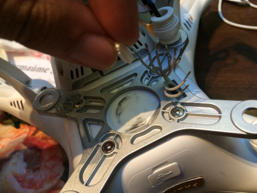

    The gimbal cable got torn off the shaft connector. I will stuck the metal pins in the connector - but don't know the right position (which pin is 1; which goes where). Please, help. ImageUploadedByPhantomPilots1439399062.565102.jpg

    The first wire on the ribbon cable closest to the front, goes in the no 1 hole in the plug, closest to the front.
