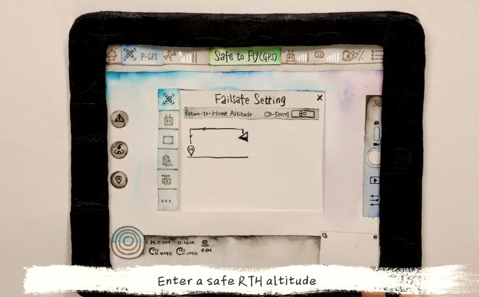

The RTH setting is in meters regardless of whether you have the app set to metric or imperial. This being the case, unless you converted, entering 100 as the RTH altitude would equate to ~328'.

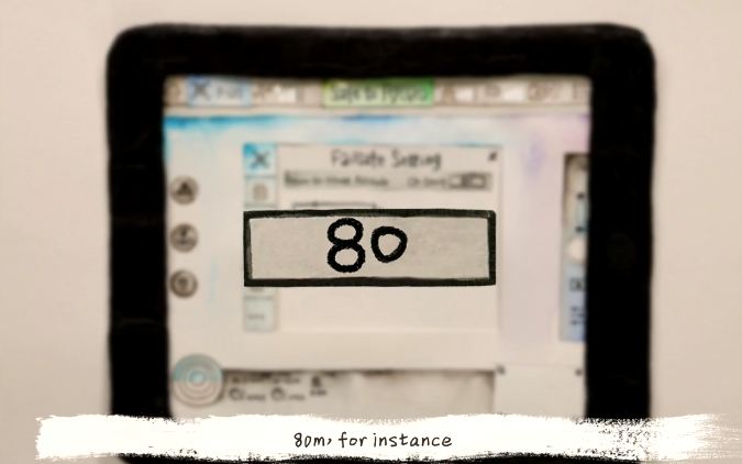

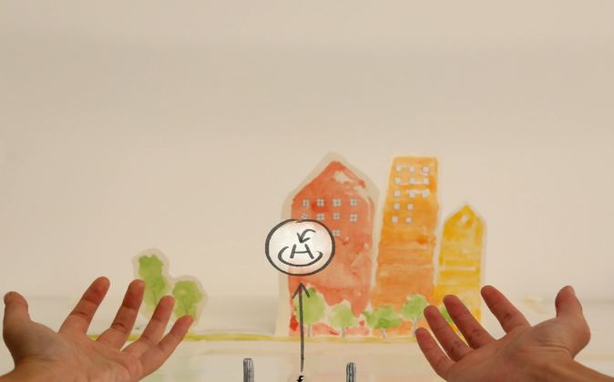

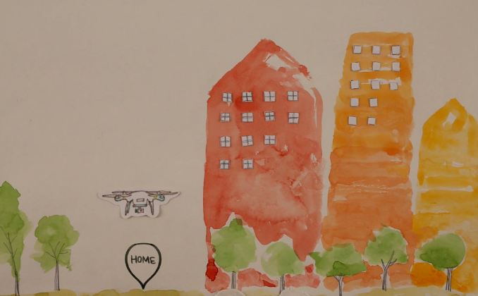

Go to the DJI.COM web page, select SUPPORT and then PHANTOM 3 and the select TUTORIALS. DJI made a video regarding return to home that explains this clearly what occurs when signal is lost. DJI - The World Leader in Camera Drones/Quadcopters for Aerial Photography

Since we can't post video, here are a couple of small snippets from the video that relate to this thread. Just scroll through them in order to get the gist.
View attachment 45229 View attachment 45230 View attachment 45231 View attachment 45232 View attachment 45233 View attachment 45234 View attachment 45235 View attachment 45236 View attachment 45237 View attachment 45238
