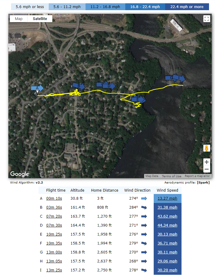

Long story short, I completely underestimated how windy it was aloft, and once it reached an elevation of about 80' it was a losing battle trying to get the drone to return home. My lack of flying experience certainly didn't help either! Attached is the flight log. It'd be greatly appreciated to hear any insight/advice! Thank you in advance!!!

As on the map you could brought it down much closely to the home point thus easier to be found or maybe fly it to the HP. The wind at lower altitudes was also strong but much less than in higher.

At least it wasn’t a Mavic Pro 2 @ $2000.00! $400.00 is not fun, but much easier to swallow than $2000.00. If there is 1 thing that is/has become obvious, the Mavic Mini is not adverse weather friendly. And I should say@ 249gr, it want intended to be.

Today (SI) we have an interesting situation where the ground wind is 15 km / h, but gusts at 70 m above ground level exceed 90 km / h. It's "just perfect" for so-called "fly away" situations.

The best thing to do in a case like this is to get to a lower altitude where the wind is not so strong. Keep an eye on the distance reading. If it is still increasing...force the drone to land. Point your camera down and look for a clear spot. Someone's back yard is better than the lake. Go as low as you can and hit Auto-land. That way if you lose signal, it will still land. If you don't hit Auto-land and the drone loses signal it will automatically go into the Return Home program. Which means it will go right back up high into the strong wind. Then you are screwed.
