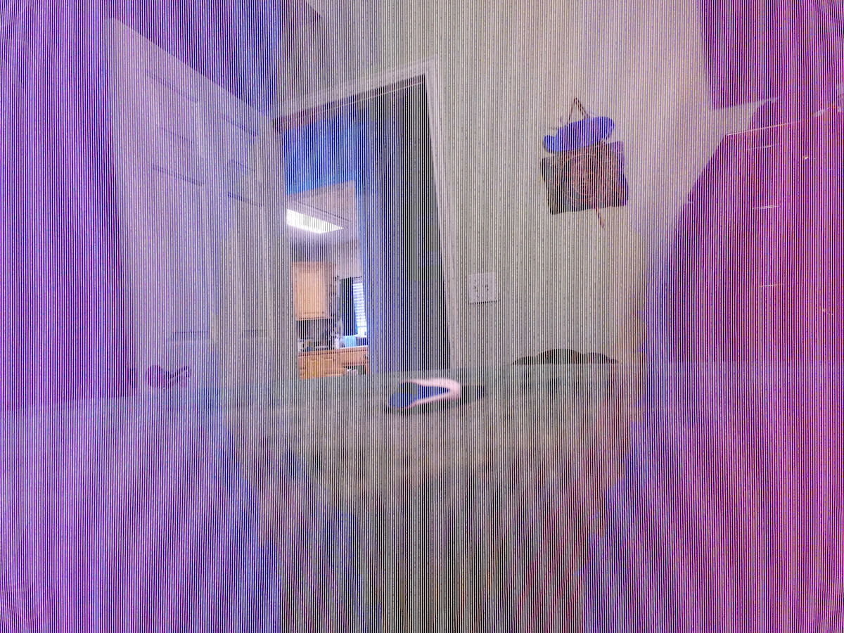

    Just ran a test on the camera. It looks fine in photo mode monitoring on my iPad. However, when I take a still it has a bad moire pattern across the image. When I switch to video mode I get bad vertical lines across the screen. I can record though but the vertical lines are on the recording. When I reset the camera it goes back into photo mode and again looks good on the iPad but I get the same bad results on the still image.

    IMO you should look for a camera-gimbal replacement after you have tried a ribbon cable replacement. -- just no way to assess the damage to the internals of the camera and gimbal.
    That picture is strange-- have seen on of those previously with those characteristics.
