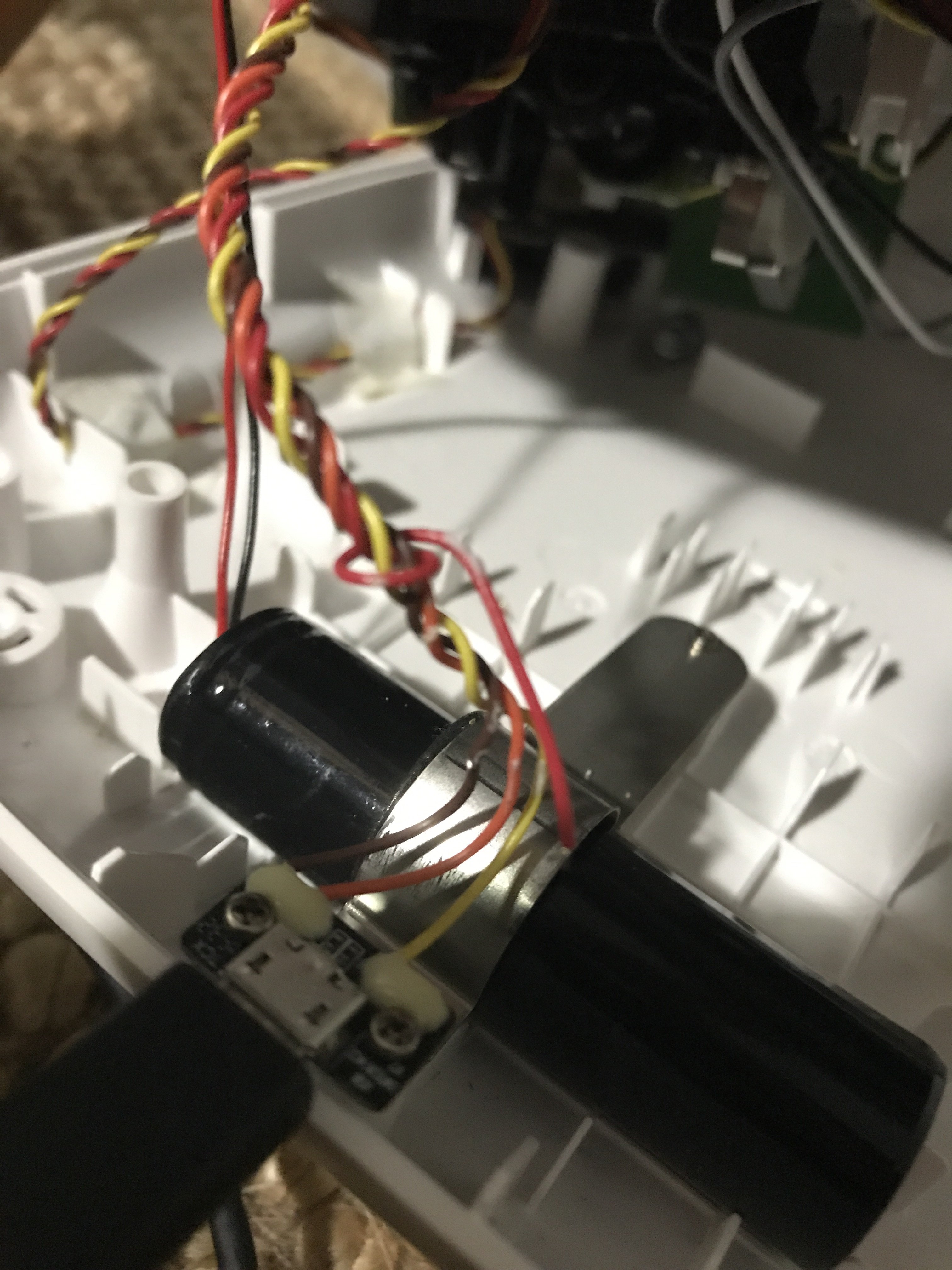

Hey guys... just installed the argtek range extender and after steady work i finished but noticed my controller wouldn’t charge. I inspected it and found a loose wire.. I need it fixed so I’d there a way to stick it back on or where could I buy a replacement (pictured below)
Thanks
(Wire is RED)

Looks like a simple fix. Carefully remove the hot glue from that area, trying not to disturb the yellow wire. Re-solder the red wire back in position, and re-hot glue the red wire.
I’ve tried this but it hasn’t been working... at this point I’ve invested a lot of time and need it working in a couple of days... is there a link to a replacement part? Thanks
I’m not aware of any vendors selling any P3S controller/transmitter batteries. Perhaps others on this Forum may have a source on this subject.
Anybody out there ever changed a P3S battery in their controller? Chime in !!
