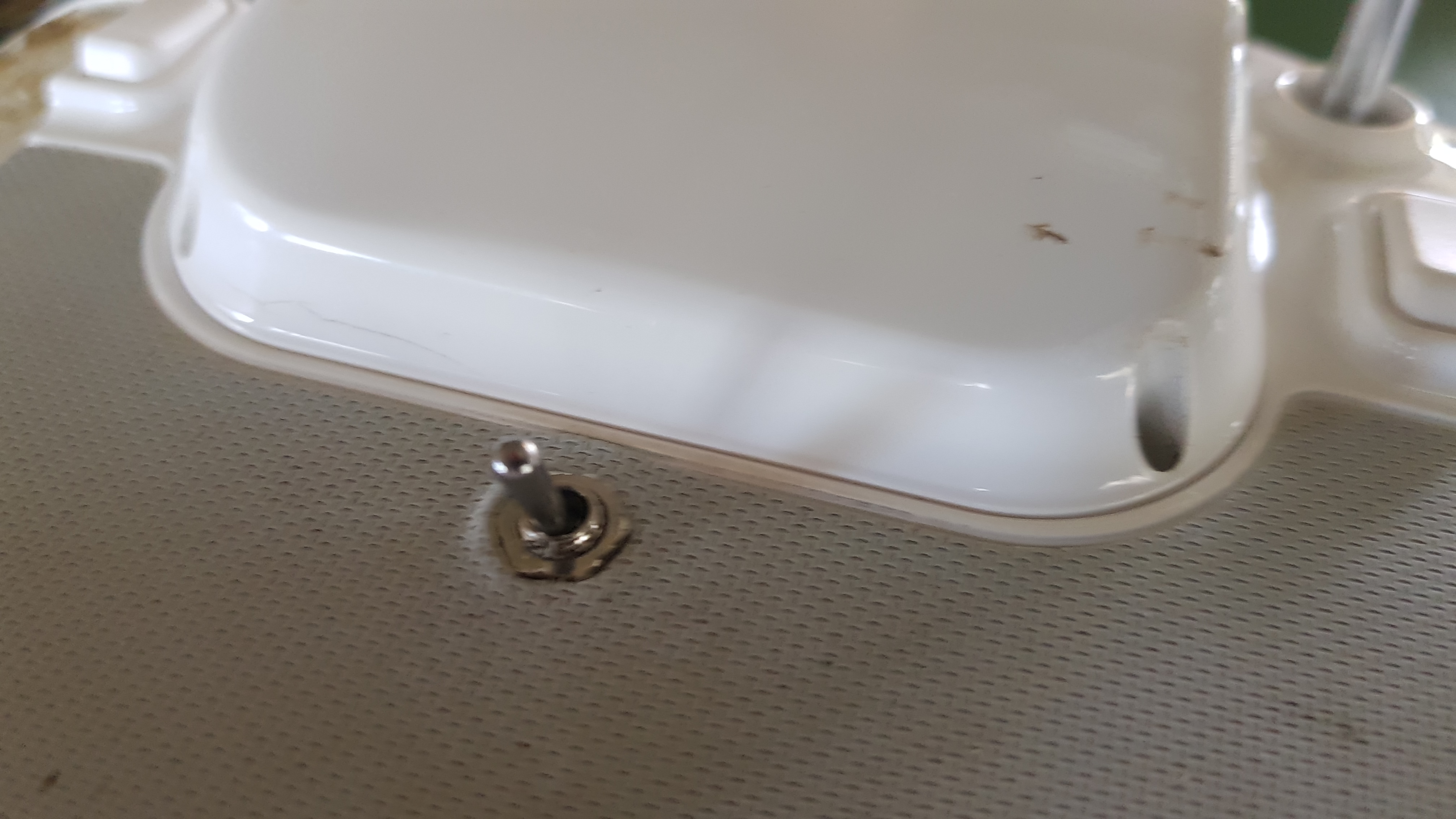

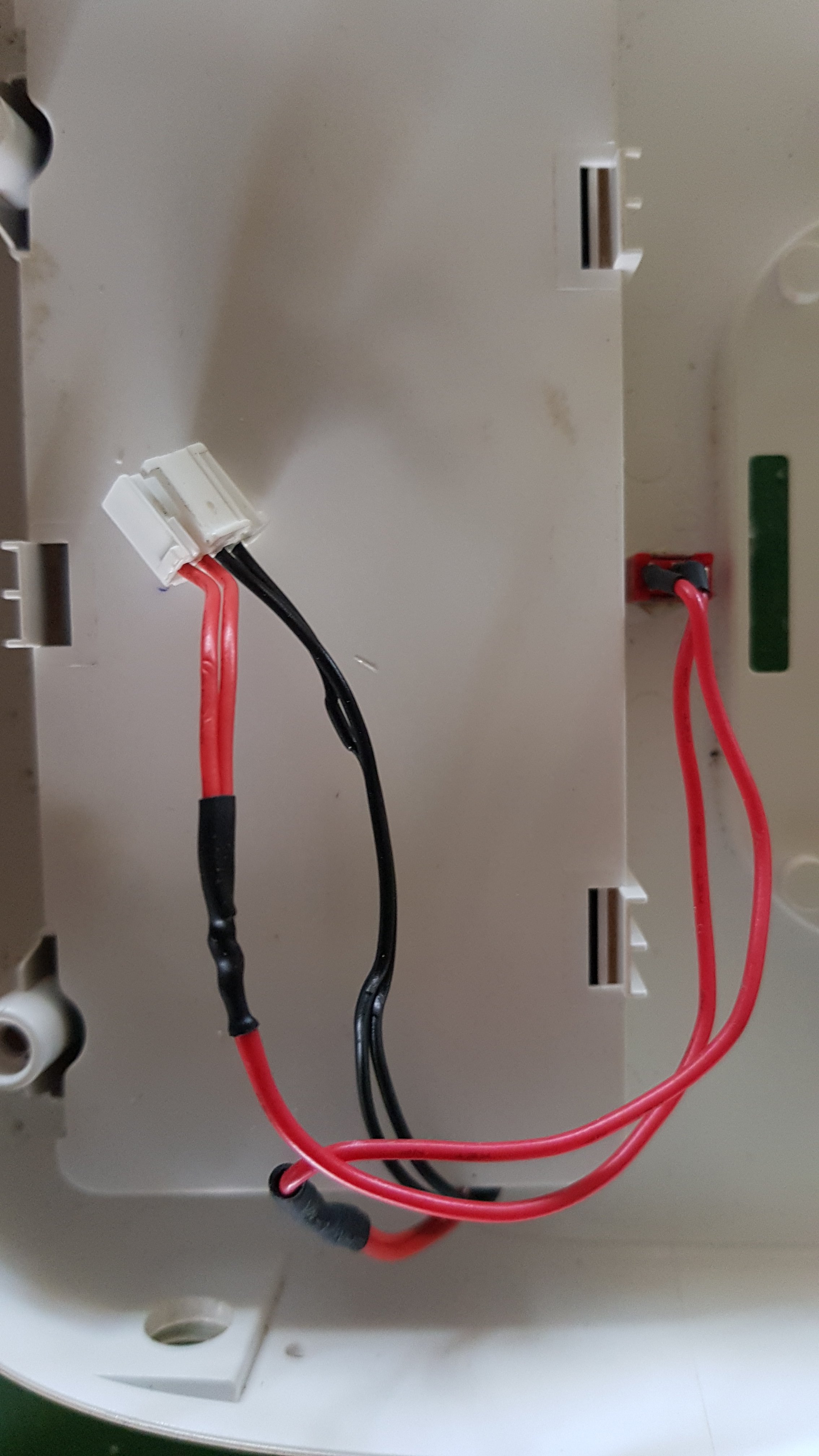

I'm on my 5th reflow of the 8 legged gas gauge voltage regulator chip.....the one next to the last led. The last reflow I had the heat gun at 375 degrees c and held it on that little sucker for a count of 20.
As I have been finding that the problem seems to return after the rc has been sitting for a few weeks got to thinking its constant voltage present all the time eroding or corroding the voltage reader chip so after some deliberation fitted a switch to the positive battery wire to the rc. See pics for this experiment. Just a small toggle switch and a simple figment to the back of the RC between the output board and battery. I turn this off when not in use so no power to the RC. Its a RISC that it could be switched off in flight but the location of the toggle switch is reasonably protected by the bulge in the battery compartment and the output module on the back of the rc.
A small slider switch would have been better but hard to cut a square hole. The plastic body of the rc was thicker than I thought ....well made.
Working well so far.
Hope this helps ones that are having to do multiple reflows and G'day from Australia
