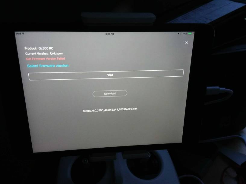

I have the gl300c. I have taken it apart several times and checked all connections. Disconnected the battery several times. Have tested the battery with a voltmeter and it is showing 7.5-7.8 volts on both cells. I've tried all button combinations that I can. The only combination that I get any result from is c1+shutter and c1+ shutter+record. The only result I get from that is the controller will power up while I am holding either of those combinations. The app will only respond to the controller while I am in the downgrade firmware mode. (See pic)

Yep, this is your issue. Now you should get deeper this way. Why you can't do that?
Since the controller is accessible in recovery mode, there's a good chance that re-flashing it would make it work.

Ok how do I reflash it?
