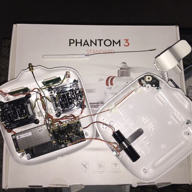

    Just tried to take my controller apart, and ripped the battery wire. Any place to get a new battery for the controller?

    Just what did you rip ? The wire's out of the connecter or the battery .
    Got this from Data's post ImageUploadedByPhantomPilots - DJI Phantom Forum1440724824_621054.jpg If you didn't rip them from battery seems you could fix it .

    I ripped a couple wires out of the connector that attaches to the circuit board. I think I'll try a local battery store and see if they have something that will work.

    Without you showing a close up picture of how it came out of that connecter I don't know what ta tell ya .
    All the ones I have pulled out can be put back in .

    Hello
    Dirk invited me!
    Ok if you broke it here I can help
    [​IMG]
    First the white connector is
    Molex #51021-0200 ( 2 position )
    This part might be ok?
    Secondly:
    The crimp pins inside are
    Molex #50079-8000 ( terminal connectors )
    They require a special crimping tool, about $20. ( engineer PA-09 ) eBay!
    I have plenty of these parts, and would be glad to supply you with them, but they are TINY and very hard to get right!
    Option 2
    Send me your battery with broken leads, and I can fix it for you, up to you? You'd have to cover shipping, but I'll do the repair for free! Let me know!
    If you want to tackle it:
    I use
    ( DIGI-KEY )
    1) 51021-0200 ( 2 position ) X1
    2) 50079-8000 ( terminal connector ) x10 ( buy multiples, they are small, and easy to damage ) few pennies each!
    Tool
    eBay ( $20+ )
    ( engineer PA-09 )
    The little pins are kinda hard to do, first cut wire so lengths are EQUAL, next, strip wires back 1/16" back,
    Place terminal into pliers, then slide wire in, first crimp INNER CRIMP, crimp to wire, NEXT, crimp outer crimp, crimp to insulation, once both done, slide the pins ( tooth up ) into plug end ( make sure polarity correct ) that's it, plug the battery into Tx, go have fun!
    Let me know, I'm in Florida!
    Jerry
    J Dot

    **** J Dot - You're awesome! (and Dirkclod too of course). The battery guy I took it to got the wires back in for me tonight. I put it back together and everything works, so I think I'm good to go. But I REALLY, REALLY do appreciate the time you took to provide such a great detailed reply and the generous offer of your services.
