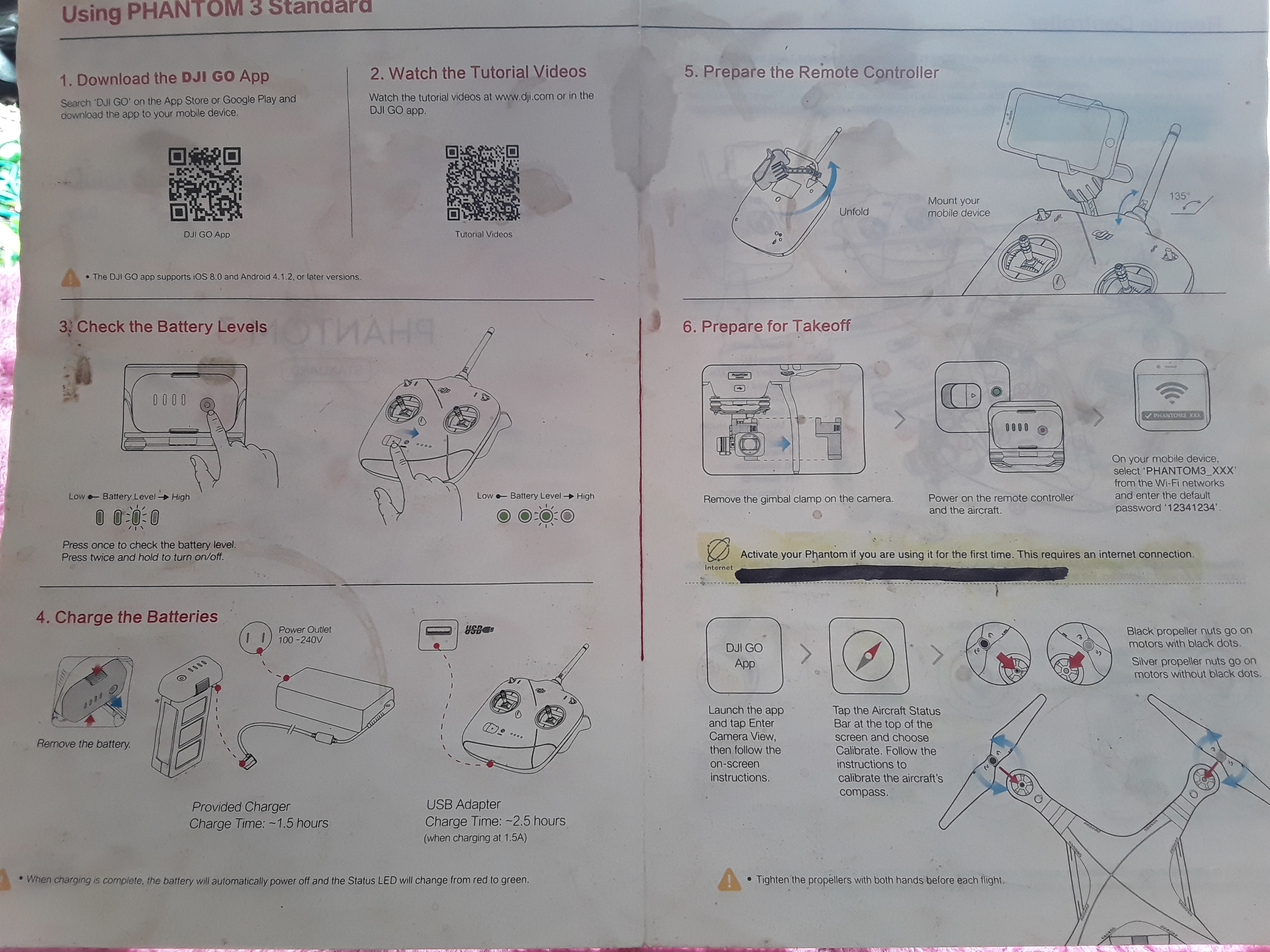

OK it's creates it's own wifi,,,,,do you have quick start guide booklet,,,explains from start to Finnish,,,also there should be manual aswell,,,sorry for sounding like dad but it will keep you in the air,,

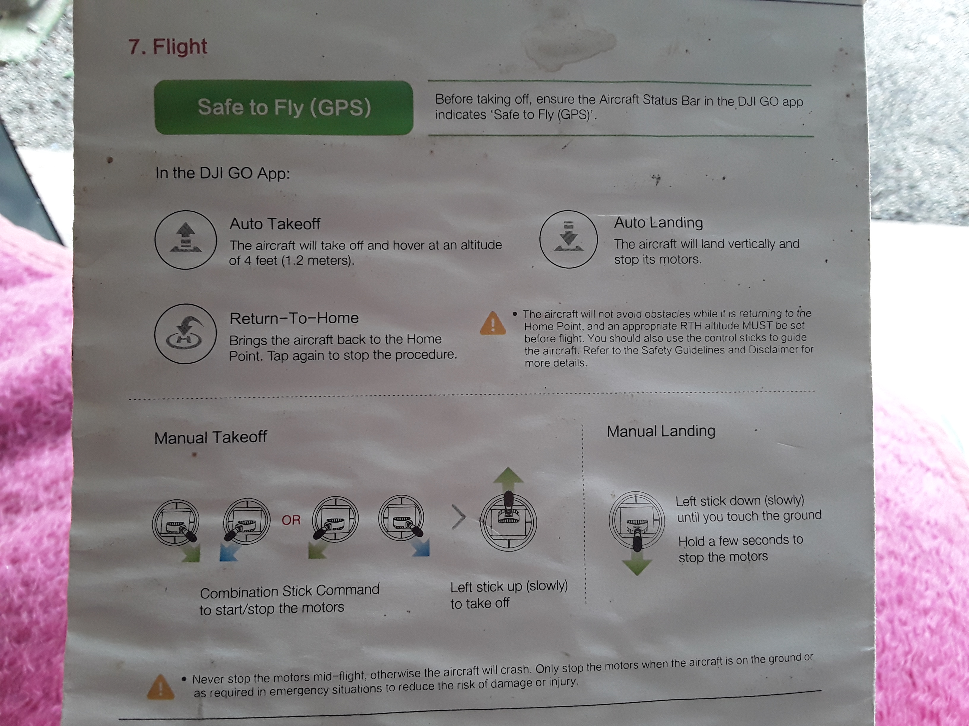

Here
Method in English
Turn remote on and device on,,,,turn drone on,,,,turn wifi on and it will search and save,,,,open app when cam logo blue click on and should have cam view....go through all settings in app like rth height , lost signal behavior etc,,,and don't fly till it says home point updated or good green gps..

Method in English
Turn remote on and device on,,,,turn drone on,,,,turn wifi on and it will search and save,,,,open app when cam logo blue click on and should have cam view....go through all settings in app like rth height , lost signal behavior etc,,,and don't fly till it says home point updated or good green gps..View attachment 109337
