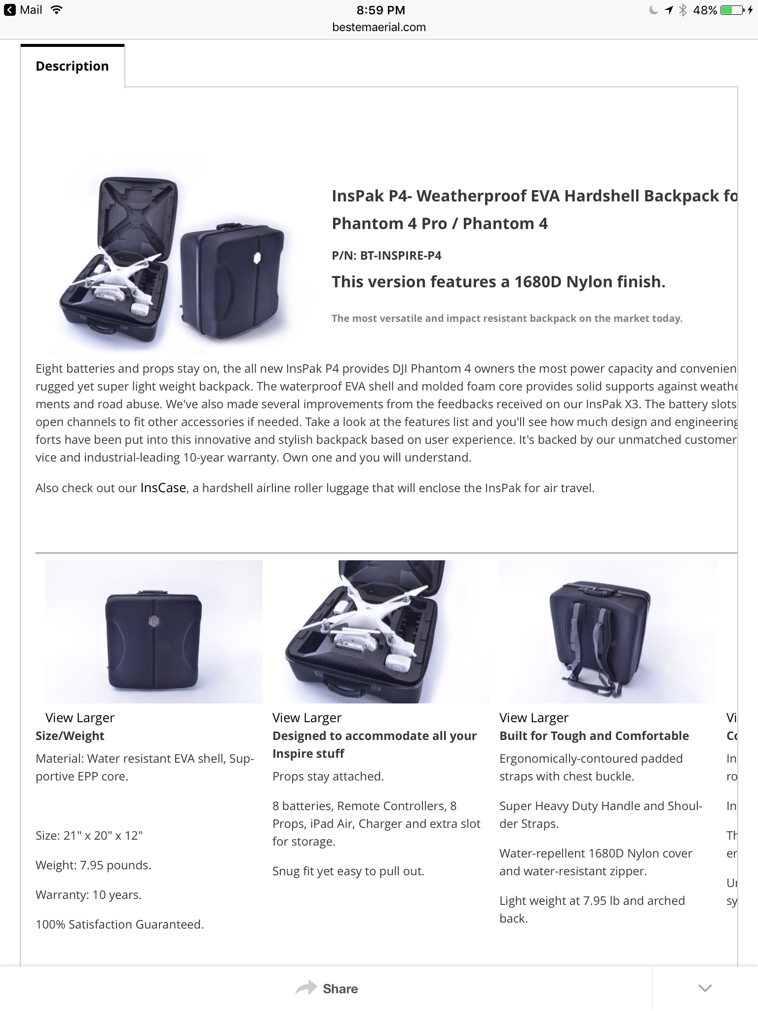

However, upon closer inspection, the video is very misleading, as the online description of the case says: "Snug fit, yet easy to pull out." That doesn't sound like easy to fly out of. The extra 8 batteries have to be removed from the case to launch from within it, as seen in the video, as they will certainly throw off the compass. Also, the video has been reversed in post from the launch, showing the landing. No way you can land it properly back inside the case. It's also for the P4 from last year. Compatible fit with the P4P bigger camera, needing more clearance room to calibrate the camera at launch, inside the case, is dubious.
This is the exact text on the site, so I'd be very disappointed if I can't take off from it with batteries and all other stuff but I'm sure it can be done,

Here is the text from the site and link to site below
Your drone can take off directly from your backpack as it is stored with props and batteries attached;
Fits DJI Phantom P4 / P4 Pro;
Only 7.95 lb and measures 21" x 20" x 12";
Spacious interior for extra accessories;
Super Heavy Duty Handle, Shoulder Straps and Chest Buckle;
Best Backpack for your DJI Phantom Drones - PhantomPak by Bestem Aerial
If you read the description below, in your link,
"Snug fit yet easy to pull out."
That's a contradiction to me....:confused:
It also says "Designed to accommodate all your Inspire stuff!" :eek:
They clearly need a better proof reader and copywriter!

That pic shows how it sits higher then the batteries so im sure taking off wouldn't be an issue, you would still need to power it on and take of gimbal guard if u use it, but if it takes off no worries I'd consider leaving the gimbal guard off and just need to power it on take out the controller and good to go

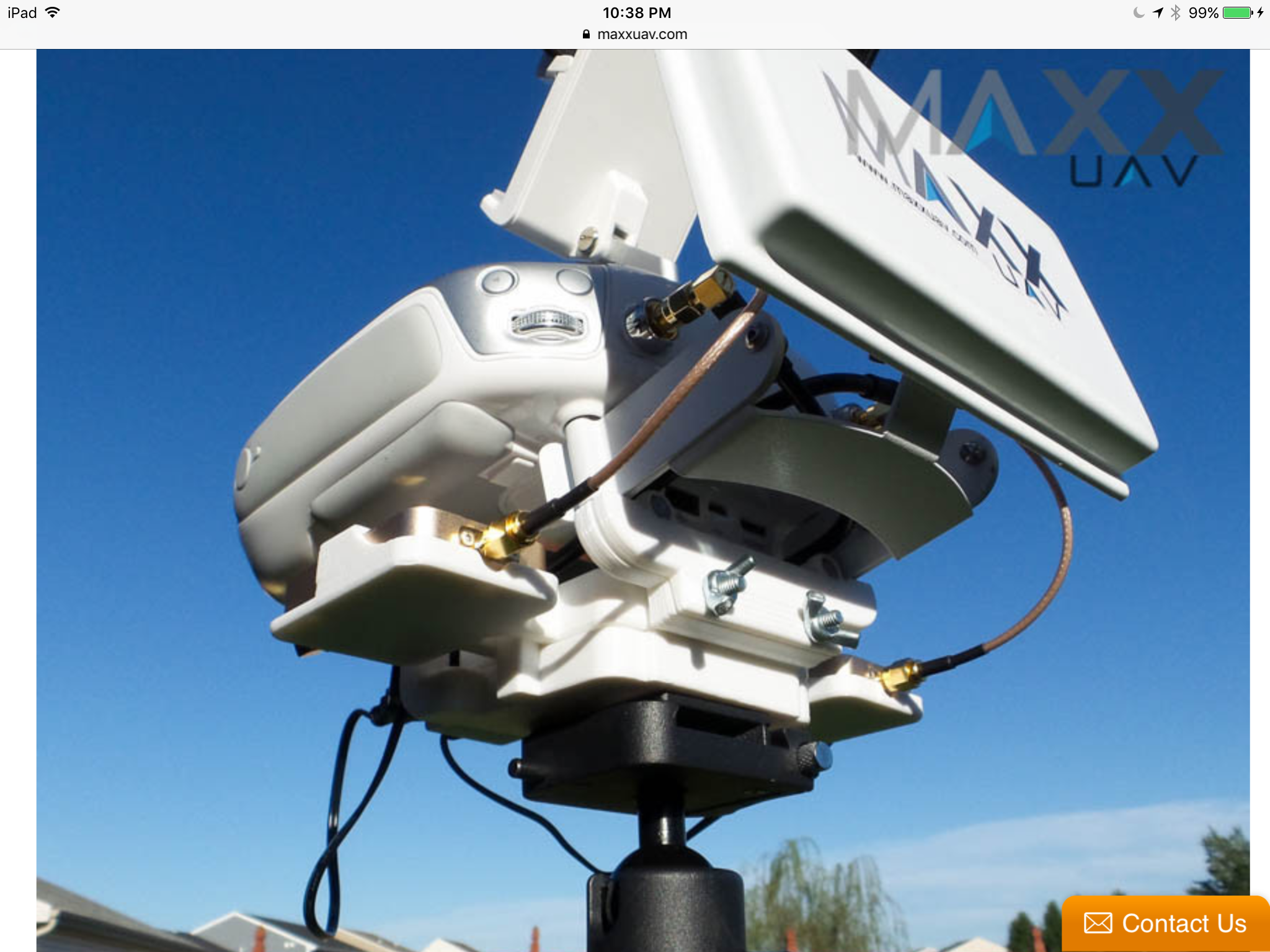

Here is a pic from Maxxuav.com of the DBS-02 boosted antenna on the P4 controller mounted on a tripod, minus the iPad. I have to use a transmitter tray to hold mine, supported around my shoulders, instead of a tripod. It's very heavy!

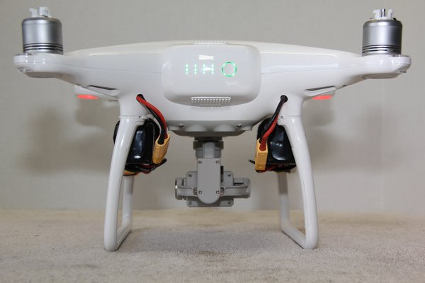

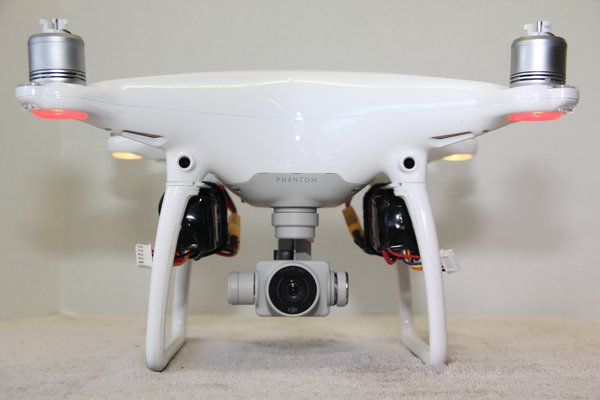

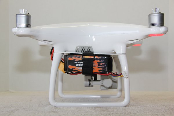

Here are three pictures showing the P4 battery mod and the mounted batteries from FPVCustoms.com

Paul at FPVCustoms.com modded two P4's for me to accept external batteries and did my P3P battery mod to two internal batteries. I have nothing but good things to say about him and his work. Adding two external 2800 mAh MaxAmp batteries to the P4 added about 50% or 8 minutes to the 16 minutes I was getting last year at full speed in P mode. So, 24 minutes total. I get that same 24 minutes now at 30mph with the P4P battery and don't have the hassle of externals. I considered a battery mod for the P4P to increase the flight time to 30 minutes, but have yet to get a P4P that I know won't need a camera replacement to fix the 4K 60fps video glitches. Until a firmware update fixes those, a warranty hardware replacement remains a distinct possibility, which would be a problem, after the battery mod. So my P4P remains "uncut" for now! Latest firmware may have fixed it. Still waiting for the early reports!
