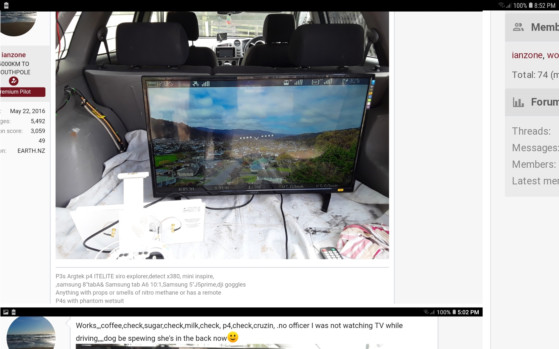

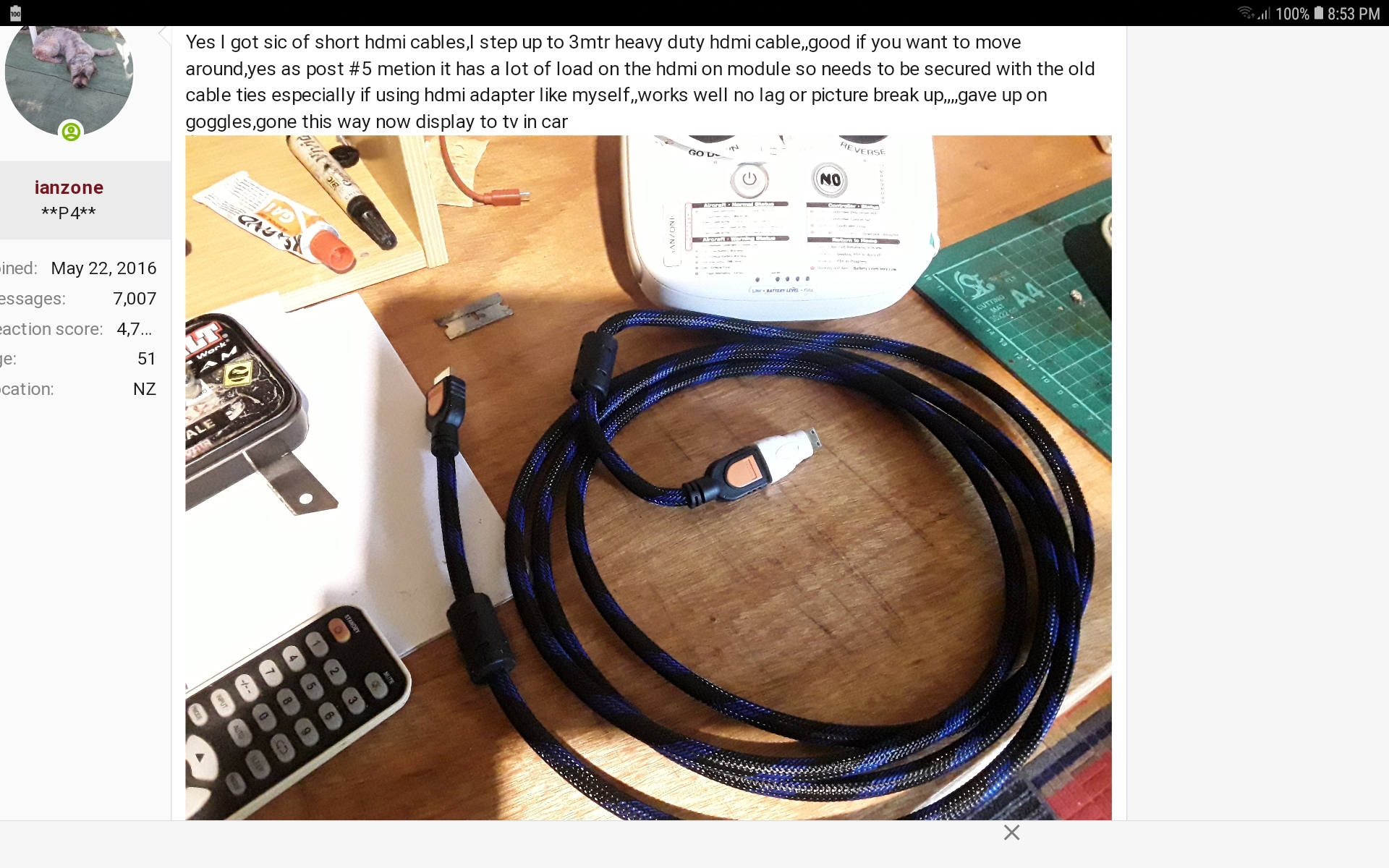

Trouble with what you ask is phantom can only have one remote linked at any one time,,the Inspire drone can use 2 but not the phantom, you can get long hdmi cable nowadays,, I use a 3mtr from remote to TV in back of car while back which gave me bit of room to move around,,you can get longer ones,,these worked well,depends how far you want to walk

Thanks ianzone. Yep, that's my plan at this point. I have a nice 10 meter HDMI cord (with fiber internally) that I will use in the way you've described. But boy would it be nice if DJI had incorporated an ability to configure the controller for "receive-only" mode. That way, an infinite number of controllers could receive the video downlink from the Phantom without having any effect on the flying control. Virtually all military radios and RF comms equipment have "receive-only" settings that allow this sort of thing. Doing so with the standard (Lightbridge 1) P4 controller would give us legacy users some of what Lightbridge 2 allows - without the whole daisy-chaining or "primary-secondary" scheme used by Lightbridge 2. Oh well, I suspect that DJI would not consider retrofitting such a capability via firmware update as it would reduce the incentive to upgrade to newer hardware. Would be nice if someone knew how to "hack" a receive-only capability into the legacy controller. Hope you have a great day.
