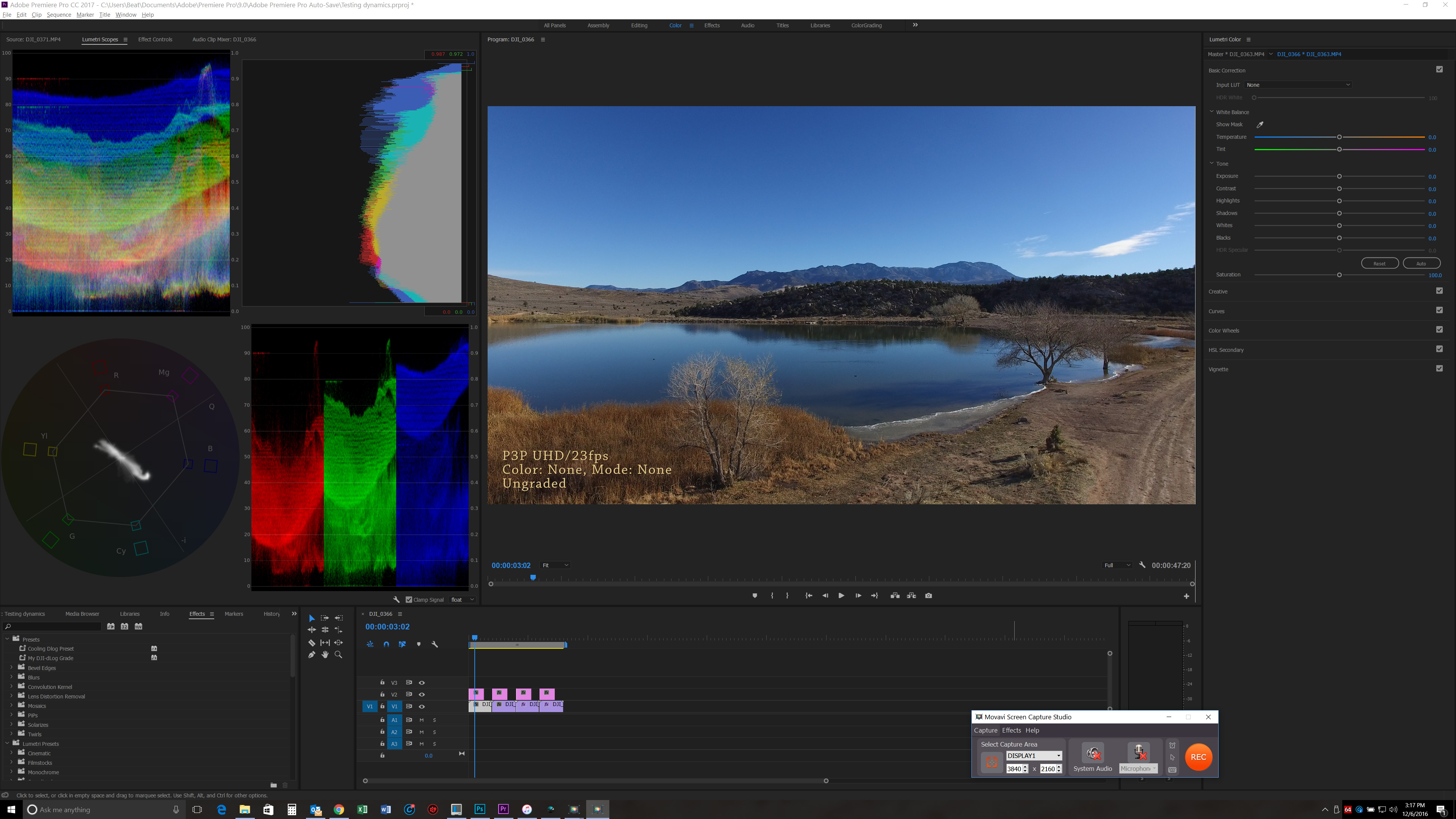

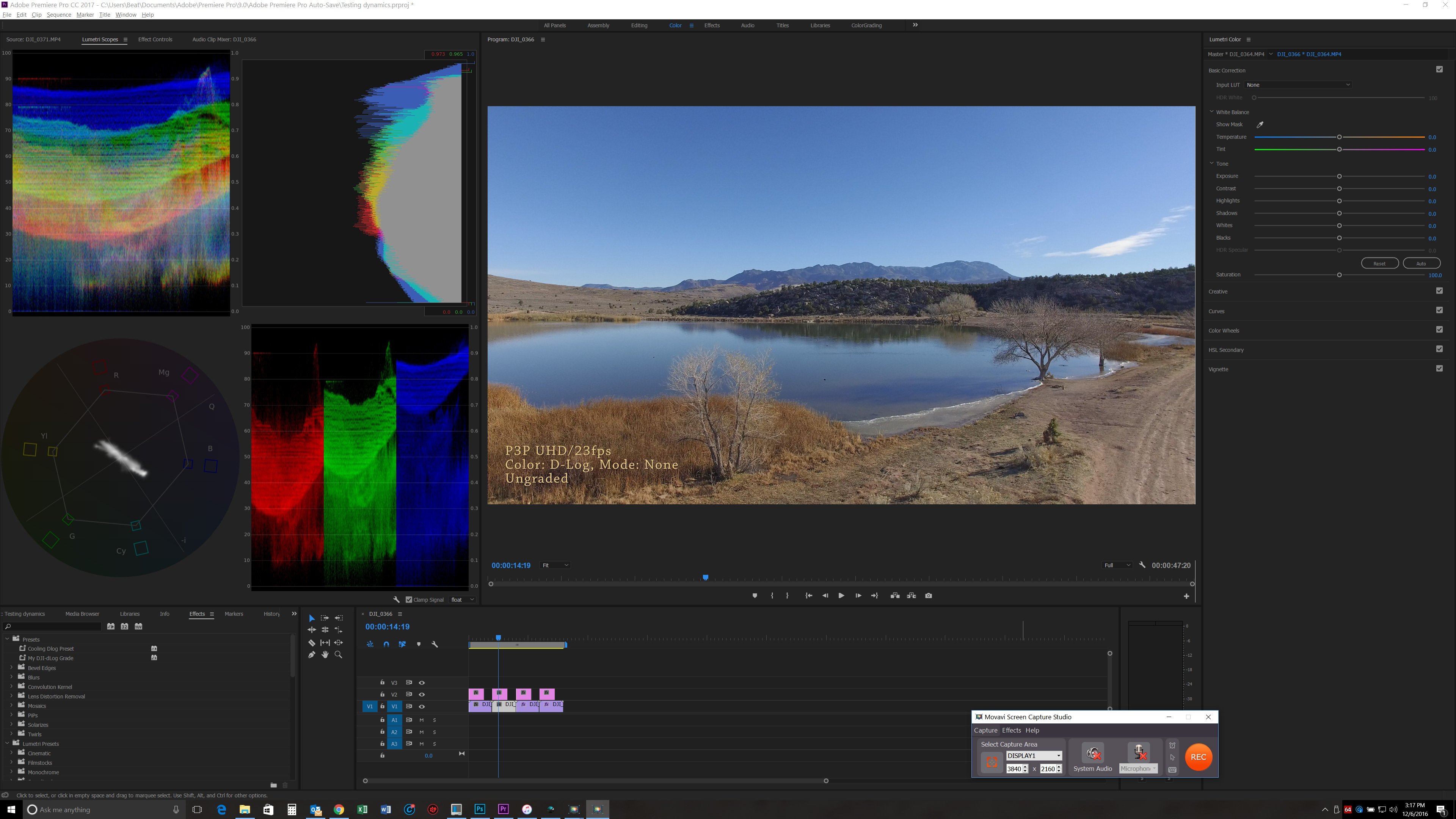

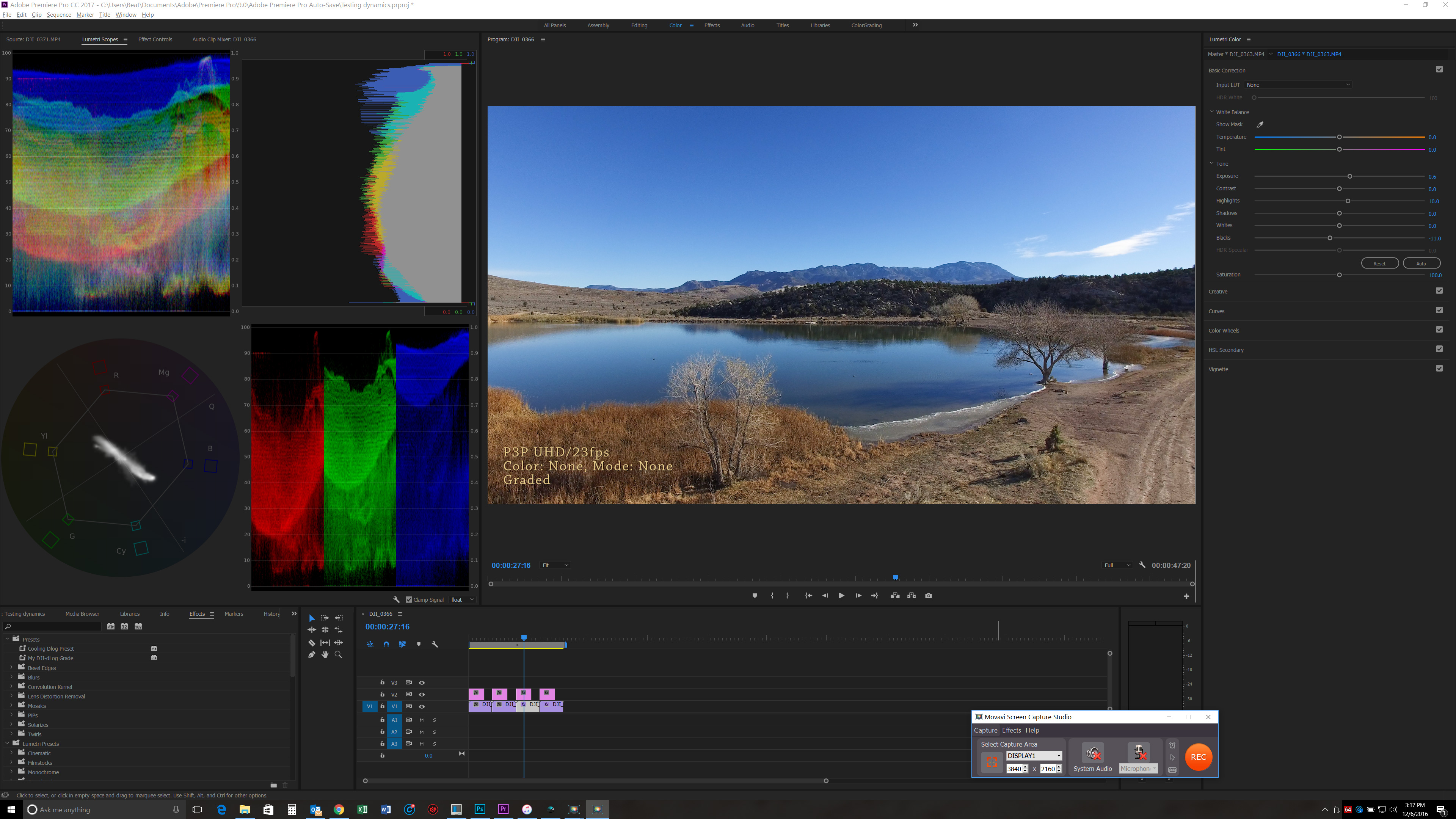

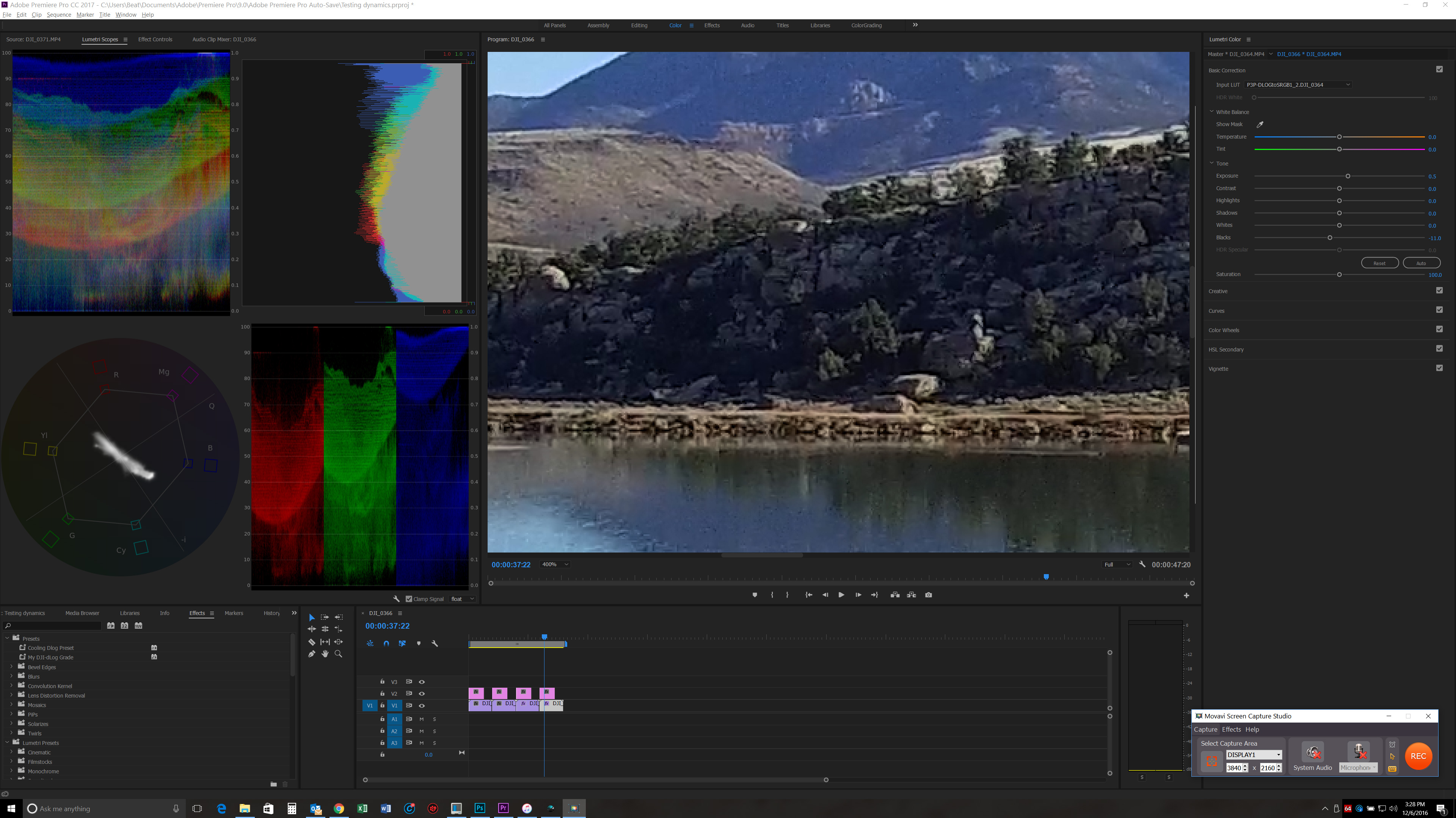

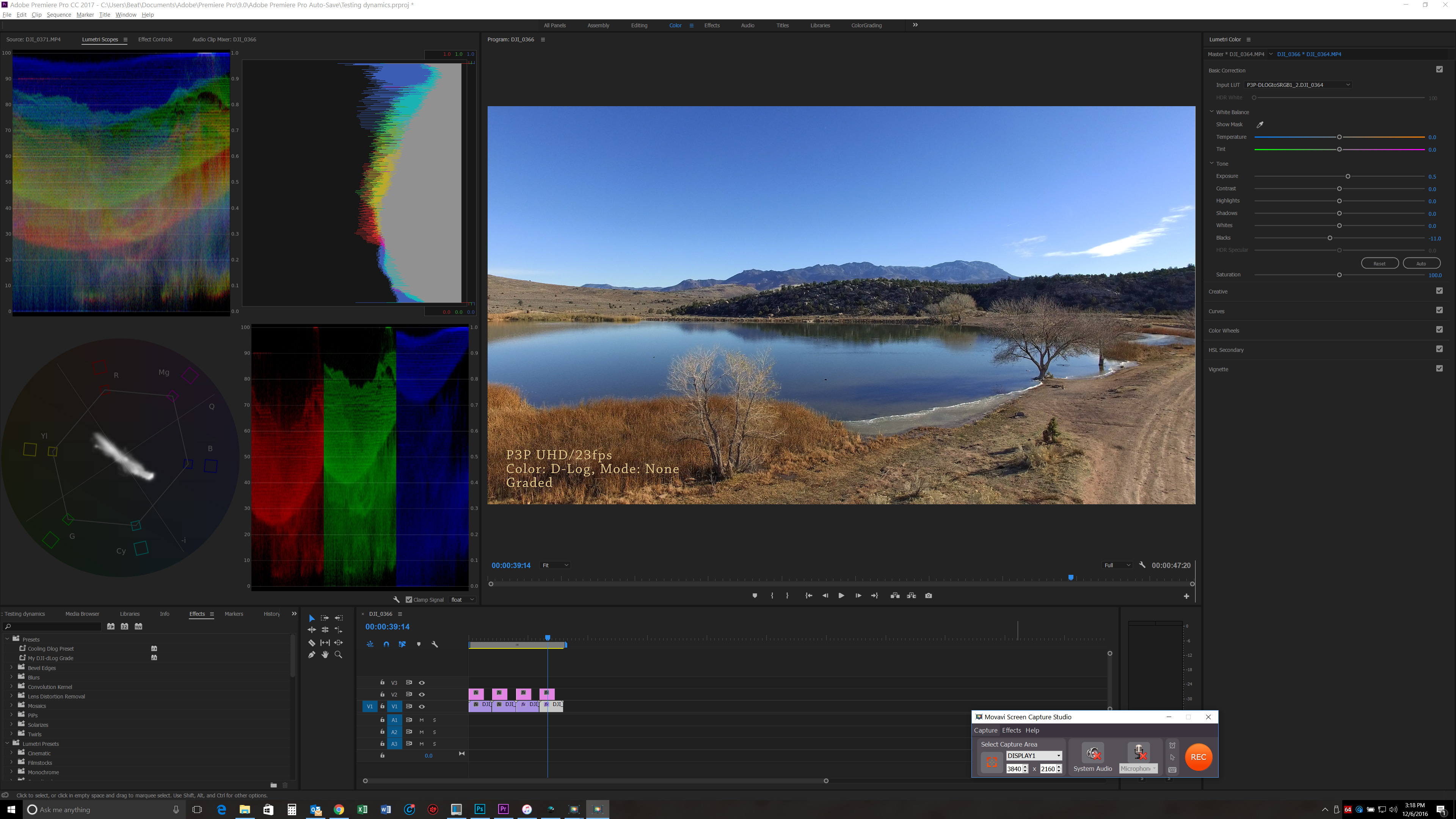

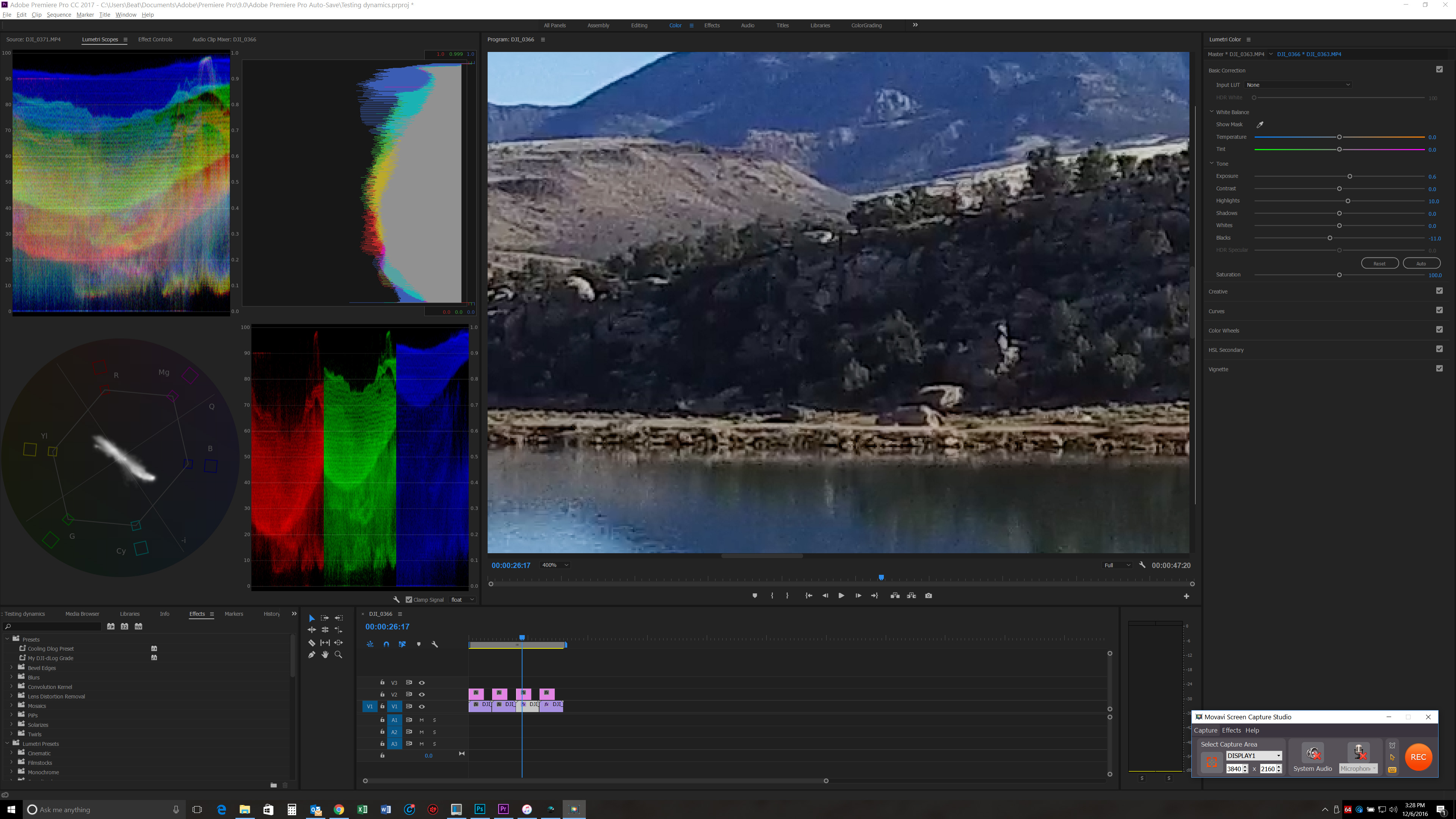

I have been using dlog pretty much for all my shots. I do not have a P4P yet, so my observations are using a P3P. I found that among others, dlog reduces the amount of noise in the video and the attached series of screen shots will demonstrate just how much mid-range detail is enhanced by using dlog along with the DJI provided LUT to undo the dlog compression and subsequently grading the video. The attached examples show 2 clips taken within a minute of each other in very bright late morning light using UHD (2160p) at 24fps. I used no filters. The first clip is with Color:None, Mode:None and the second is with Color: Dlog, Mode:None. I created 6 screen shots with both clips in Adobe Premiere Pro. The first two show the clips ungraded and the next two graded. The last two show a section of each blown up to 400% to demonstrate the effect of using dlog on difficult lighted areas.

Thanks for the effort.
I think your graded None shot is the superior one, looking at the curves and histograms and the picture. They are similiar, but the None is better IMO. In the 400% crop I can see a minor difference between d-log and None, but none of them is better than the other. They are equally bad, not because of your photographer and editing skills but because of limitations of the P3P camera.
Thanks. That's a good word. Thanks for the speeding up the learning curve.
