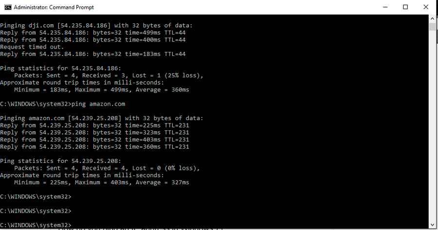

I've wondered if these messed-up updates could be caused from lost packets off the DJI server leading to a corrupted BIN/Firmware file being installed?
For fun, I pinged the DJI website and Amazon and found the DJI site will often give me "Lost packets" (25% loss) where Amazon is solid with no lost packets like below:
Good stuff.. I byte of data loss on a firmware update is considered a failure. I was monitoring my network throughput I/O, noticed last time I attempted a firmware update, I received a failure to connect to FTP or connection dropped. This is where I confirmed what I suspected the firmware is coming form the DJI FTP site. If this is the case, then ANY procedure or update process will fail.
I would want to ascertain the FTP site to test connectivity on an average.
Interesting..
While that is possible, I don't think it's a likely cause. File transfers are pretty robust these days. If a packet gets dropped, the process that requested the file basically says "hey, I didn't get that last packet, please resend". That much is handled in low level code and the DJI programmers don't need to worry about that. What they can also do is calculate a checksum value for the file. Kind of like a fingerprint of the file. The checksum is sent over before or after the file is sent over. Then the downloaded file is compared to the fingerprint and if they don't match up, then the file is corrupt or has been altered.
What is more likely the the problem is that there is a bug in the firmware update itself or the upload to the AC is interrupted, leaving it in a fragile state.
