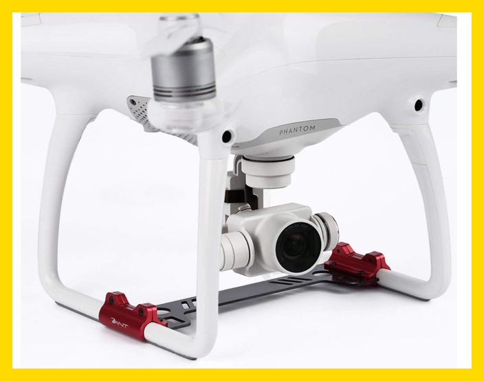

When I bought this, it seemed like a good idea.
Protect the camera, gimbal, etc.
However, recently I was flying in front of a house and decided to fly over it, (no line of sight, just monitor) and descended into the back yard. My thought was to do a 360 of the yard.
Next thing I knew, I lost electronic and visual connection with the bird. I ran to the back yard, thought I heard a prop sound (couldn't really tell, as I am hearing impaired) and there was my P4 V2 (one month old) against the house on the ground with 4 snapped landing gears at the bird. 2 of the blades had mud on them. Cannot recall if I had turned off the warning sensors, but I must have. Stupidly, I had exceeded my skills.
In thinking about all of this, I am wondering if the Carbon Fiber Landing Gear/Gimbal protector didn't give too much rigidity to the landing gear causing the snapped gear.
What do y'all think of this accessory? When my P4V2 returns, should I reinstall?
Thanks to all of you experts! Fly cheerfully!

Some drone insurance policies require a gimbal protector for the policy to be in force. I have found that using external landing gear AND the gimbal protector give some protection. However, I use the snap-on gimbal protector not the rigid one you displayed. It is hard to say if the rigid gimbal protector was at fault for your broken gear; it would depend, I suppose, on how the drone hit the ground? If the rigid gimbal protector was putting any stress on the landing gear due to incorrect fit that would certainly not help.
I think it’s genius by the Chinese- produce all this stuff we don’t need but can’t help buying. In a decent crash it will be a waste of time, on all other occasions it will just reduce flight times and interfere with aerodynamics. It may well also confuse the vps.
If the gimbal protector is set too far aft of the camera it will interfere with the vertical navigation of the drone. You will get a message on your screen stating that the vertical sensing is not functioning properly and to land immediately. You should do exactly that! I almost lost my P4P due to its inability to slow its descent vis a vis the messed up vertical sensor. At first I thought the drone was “settling with power”, a helicopter event but possible with a drone. Not so! The gimbal protector is very light and produces little parasitic drag in comparison to the protection it offers to a very sensitive and expensive part of the P4P.
Sorry to read this,,I did recent buy a plastic one just for protection and seemed to make me p4 bit unsteady when desending to land,even at height coming down almost goes into a very untidy motion so took it and fly normal again coming down,must have been disrupting aerodynamics I presume,as post #3 metion good crash and all is history,,,just my experience with it some might work ok,,,I think the idea is to always land in safe flat area,,,,yours as a assesory (can't spell that word) looks nice but mayby that's it...these items might not have been tested properly before sold,just like led props,just there for looking at or even storage,,sorry again for your mishap

How much does it weigh? How have you established the drag is negligible? Each to their own. I think the best benefit they have is looks... maybe they could stop the grass smearing your skylight filter also.
I try's the plastic snap on I like the extra protection but every time I try to fly with it I have to land it seems to interfere with the downward vision sensor and I get the error msg vision sensor error land immediately. I land restart p4p and problem goes away. I wish I could figure out away to use it without it interfering with the sensor. Although I can't adjust it foreword because I also use landing gear. Yet even removing landing gear and adjusting the it towards the front would expose the camera to the point that having it on would be almost useless

I ended up cutting mine down, to avoid the sensors, literally in half, leaving the semi circle on the gimbal side,
Mine was this type though.
