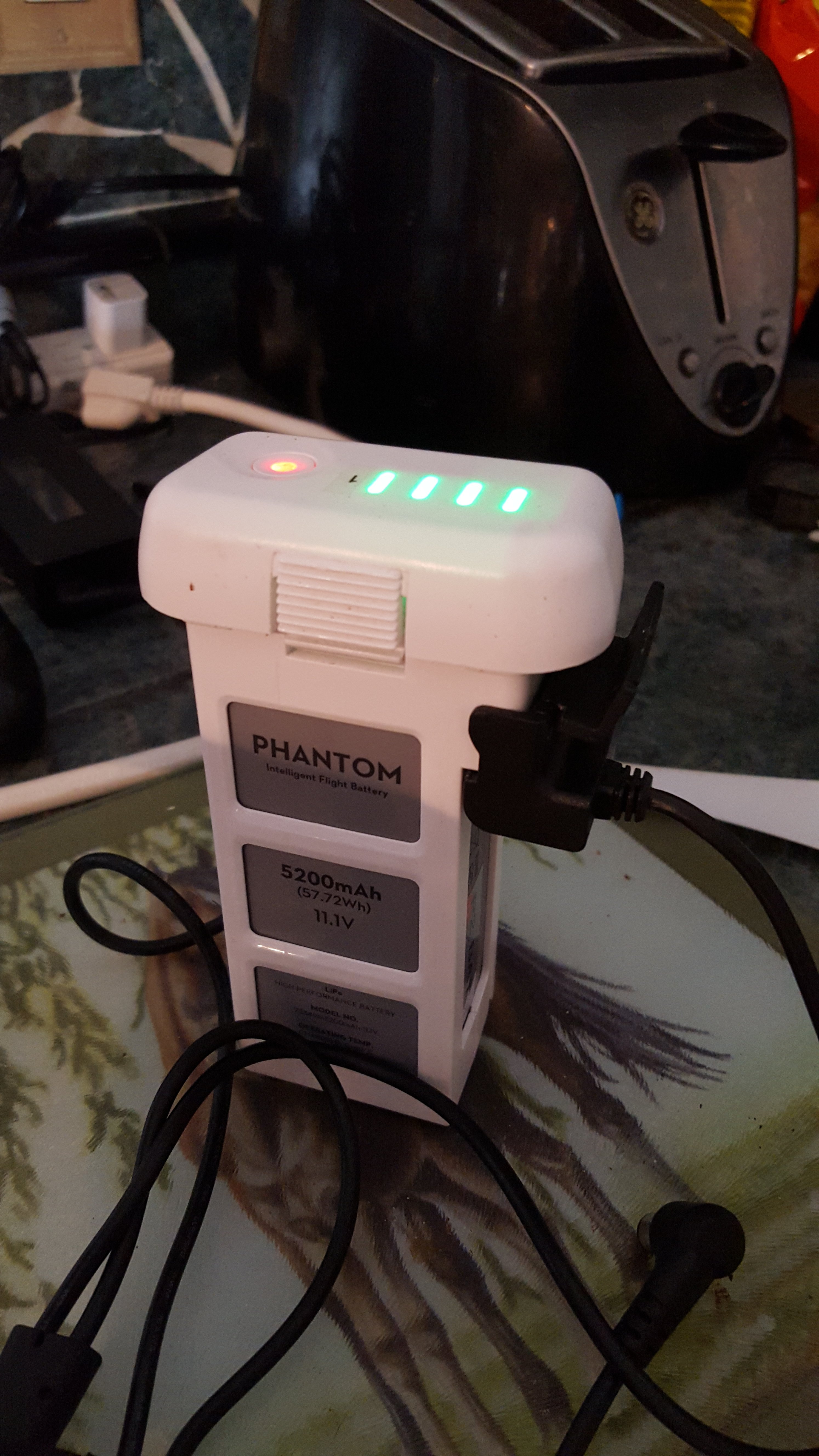

Ok I can't get any more definitive then this. My P2 charger is on the bottom, my P3 charger with support for charging the remote in the middle and the new 100 watt charger bought today from Best Buy and labelled "P3 100 watt charger" on top.
All, I repeat All fit on my P2 batteries. I am not saying that they should be used to charge P2 batteries. I did use the one in the middle and it seamed to charger P2 battery from 25% to full in about 40 mins.
