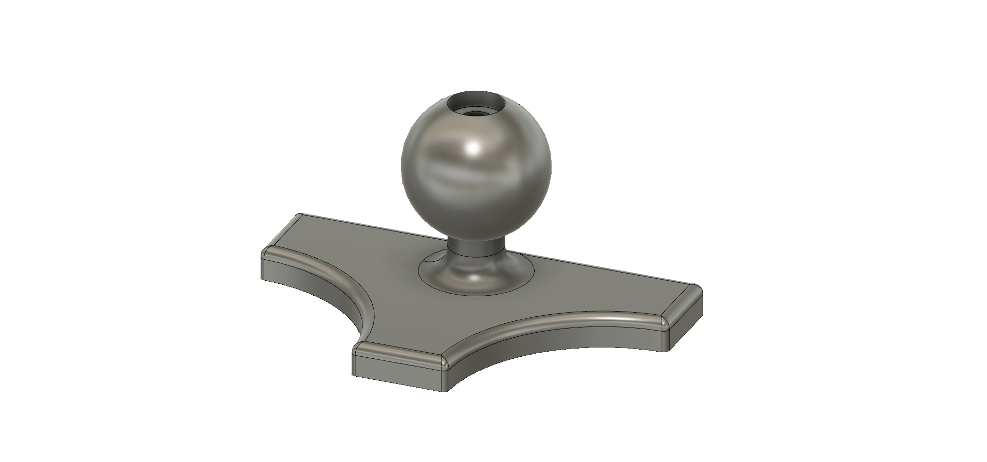

Can anyone do a 3D design for 1" Ram-Mount ball on Phantom 4 Pro Controller?

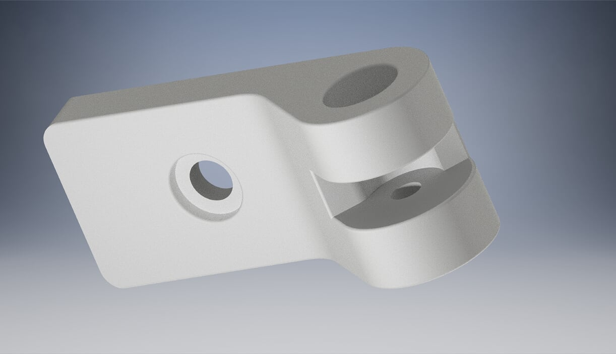

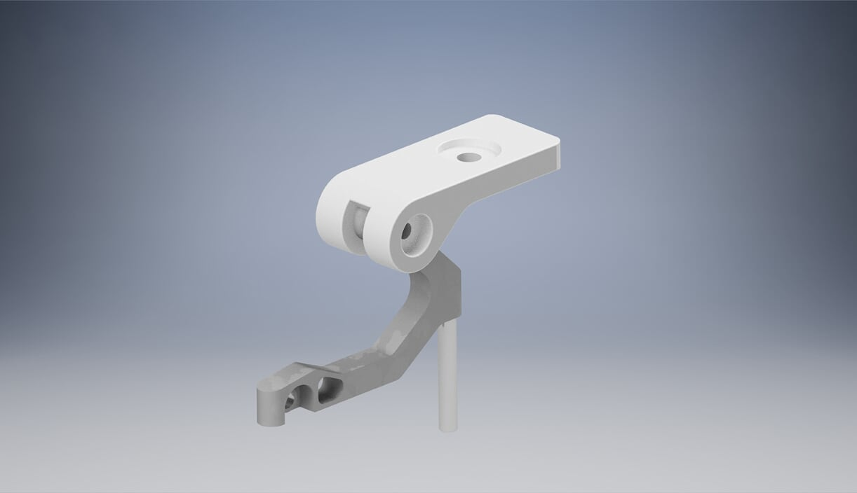

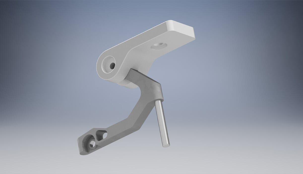

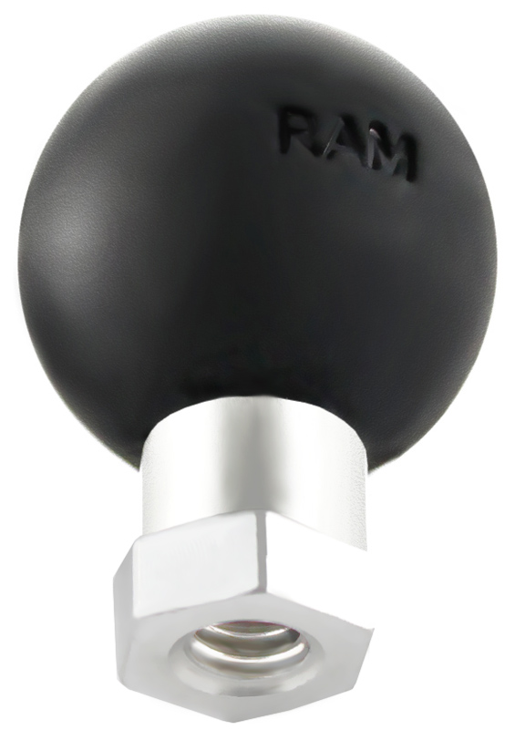

That's cool. Here is another option. I didn't model the ball but it would ideally be used with the rubber Ram Mount ball with female threaded fitting. The advantage this one has is that the weight and forces of the display are spread over the two original mounting points. The disadvantage is that it puts the whole assembly up higher. If I was doing this for myself, i'd just screw a ball into the top hole, like you are doing. If I was designing something for commercial sale, I would lean toward something like this.
I would be willing to play with that. As you said, I think it is going to be pretty high and and I think alot of torque on that one printed piece. If you send me the file, i will print it and test it. I did play with this in Fusioni 360 but I just can not figure out the concave bottom (loft function). Thanks again for your help!

Yup. Not at home right now but i'll package it up tonight. I didn't have the base size of the ram mount so I winged it. The rest should be pretty accurate.
That's cool. Here is another option. I didn't model the ball but it would ideally be used with the rubber Ram Mount ball with female threaded fitting. The advantage this one has is that the weight and forces of the display are spread over the two original mounting points. The disadvantage is that it puts the whole assembly up higher. If I was doing this for myself, i'd just screw a ball into the top hole, like you are doing. If I was designing something for commercial sale, I would lean toward something like this.View attachment 106260View attachment 106261View attachment 106262View attachment 106263
And it may not be too talll at all with the short connector:
