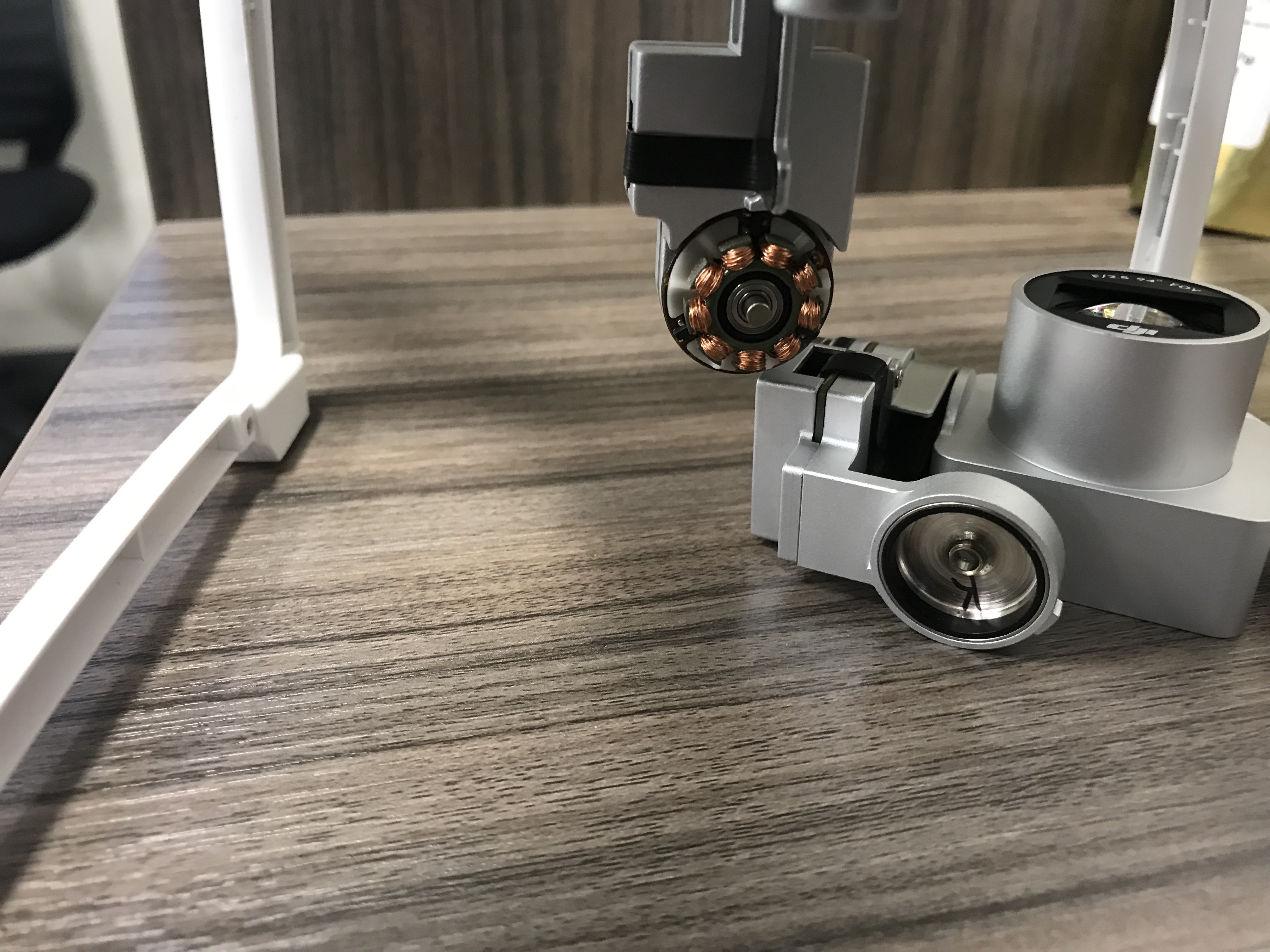

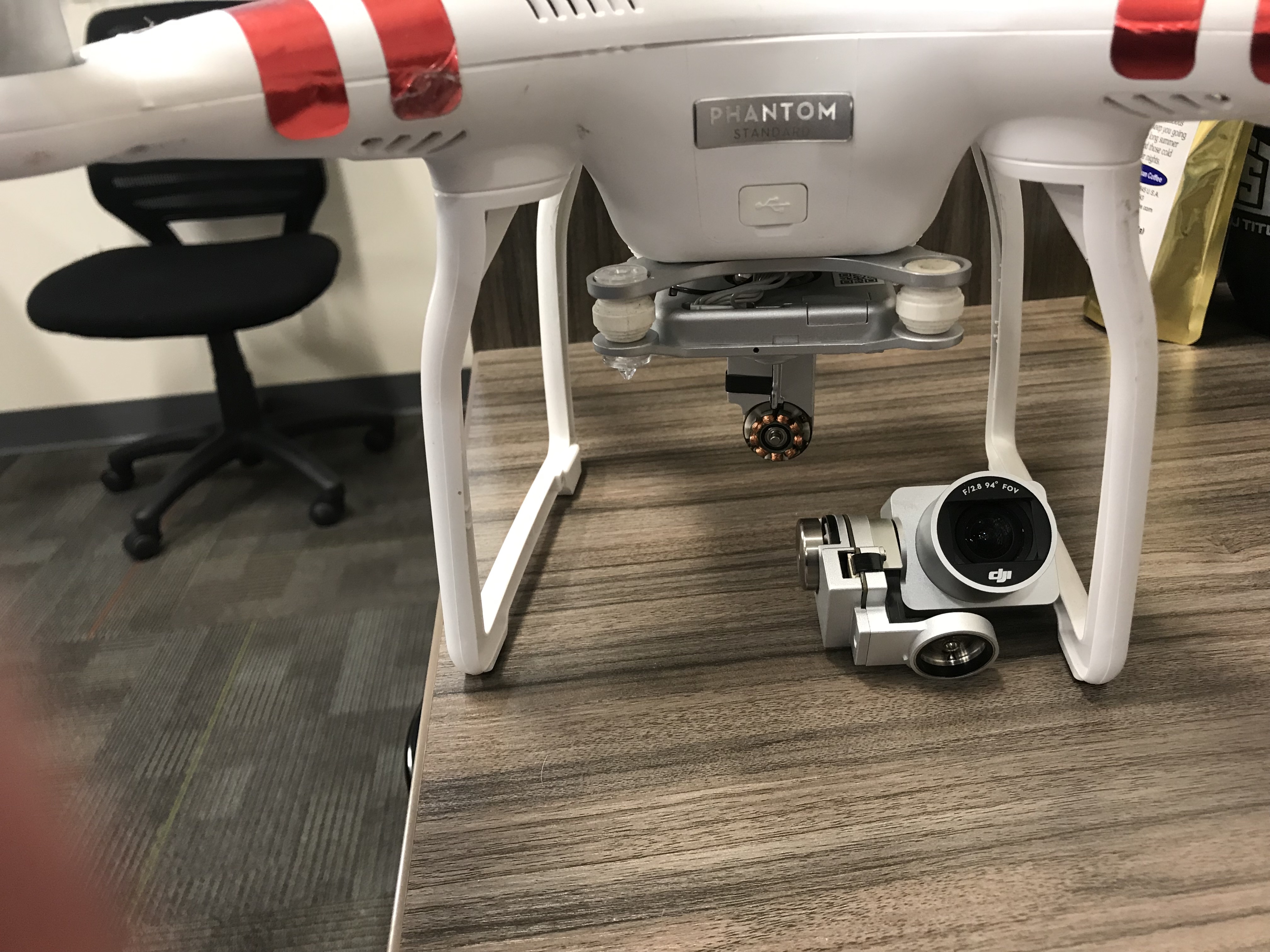

Hello all, I am a newbie to the forum and wanted to reach out to get advice on repairing my Phantom. A while back I had a rough landing which caused the drone to spin out of control upon impact with the ground. At that time the camera broke off and was ejected across the yard. Other than broken camera the drone seems to operate fine. Do you have any advice on how can I repair the camera? Is this a complex fix? If not where do I find replacement parts? Attached are a couple photos so you can a sense of what the damage is. Any help you can provide is greatly appreciated. Best, J

Buy a roll motor and a ribbon cable if nothing is bent. Go from there.
Roll motors are notorious for coming apart in a crash. There are posts on how to glue it back together.
If you are a handyman with this type of thing, it is not hard to repair. You know your skill level. If not, sent it out to be repaired. Parts are all over the Internet. Amazon is you best choice. You Tube is your friend.
Without actually seeing it, I cannot say that yours is the same as mine, but when mine came apart (like in your pics) I reassembled the roll motor and it works just fine. I straightened my slightly bent yaw arm, and installed a new flat cable.
