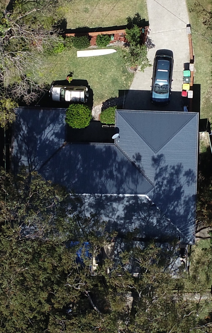

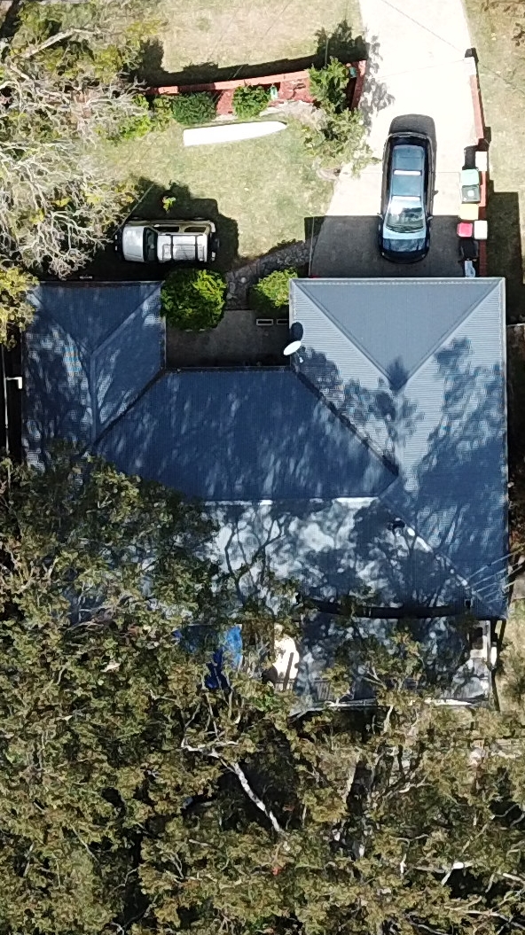

So I did a comparison on the stills. Took both drones up 100m and took a straigh down shot of the house. I believe stills are supposed to be similar resolution but P4P has larger sensor. Still detail looked very similar. Little more colour depth fom the P4P. I have attached samples from the 2 drones (cropped to protect the guilty).

I assume that the top pix is the phantom. There is no question that it is terrible.
What or how did you focus the phantom’s lens? The phantom has a focus control. From the picture it looks as if the lens focal point was shifted to a point closer to the drone than the actual subject.
For maximum sharpness for stills and video, shoot at a higher speed 1/48 sec or 1/60 sec will blur if there is rapid motion. I usually shoot at 1/500 sec or more. I don’t find that motion blur created by slow shutter speeds works for drone footage.
Was the lens spotlessly clean? Was a filter used?
The remaining possibility is that the lens itself is defective. I haven’t heard of that happening, but the image is really bad.
Sorry top one is Mavic. Bottom P4P.
Both images are a cropped image about 1/6 of original. I will take it to a more suitable place where I can take and upload uncropped/unedited photos videos. I will keep an eye on the settings perhaps do a manual shot but they were both taken on Auto with a 'tap to focus'.
Yes, top would definitely be the MP. Much better sharpness and color on the lower picture.Having had the MP since 2017, not hard for me to pick it out.
Puzzling. Even with that crop, it should be sharper, although you have thrown away 83% of the pixels with the crop.
If you are talking about a Mavic 2 pro the sensors and resolution are the same.
If you mean the original Mavic pro, it's sensor is smaller and so is the resolution (4000 x 3000 vs 5472×3648)
Or if you had the Mavic 2 Zoom, it has the same small sensor and resolution of 4000 x 3000.
Just for certainty, which Mavic are you asking about?
The main issue I see is that one is significantly overexposed.
I can't see anything to say that there's a problem with sharpness or focus

The top (Mavic) photo is so obviously inferior to the bottom (P4P 2) that I'm amazed at your comment, "From my basic usage I have been quite disappointed with the quality of the Photos and Videos of the P4P compared to the Mavic Pro." I would have complained differently.
Yes, the top one is Mavic. I could predict that the Phantom's is better and that's and so it is in general.
If someone gets better pictures with Mavic, then something is wrong with the Phantom!

I'm certainly no expert when it comes to photography as I still think an F stop is a position played in baseball. But your bottom photo, labeled P4Pv2.jpg, is noticeably sharper and clearer than the top one. Yet your original post at the top states that your Phantom photos were of lesser quality than your Mavic. Excuse my confusion. Just trying to figure out where and why my understanding got derailed.
