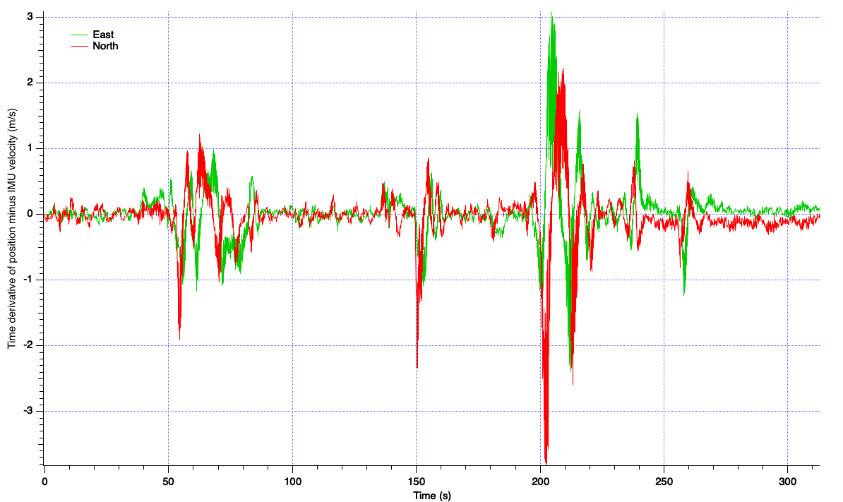

@BigAl07 asked me to take a look at the flight log for this unfortunate flight. The only log available appears to be an AirData csv conversion, which is missing a lot of data fields, but there is still quite a lot of information to work with.
Firstly, the log messages indicate a number of compass errors and a switch to ATTI mode before the control connection was lost. Without the magnetometer data to compare with the IMU yaw values, I employed the usual trick of differentiating the recorded position with respect to time and then subtracting from the IMU velocity. This technique generally highlights compass errors quite well by deviation from the expected baseline of zero.

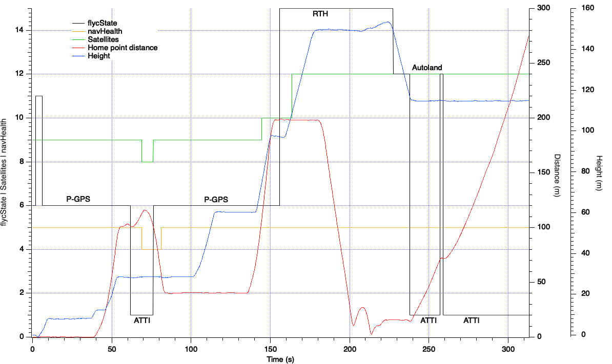

The resulting data agree with the compass error messages at around 60, 150 and 200 seconds. The cause of the errors is impossible to determine from such limited data, but it the problem led to the FC switching to ATTI mode. In the plot below the rather confusing wifi reconnect status values are removed for clarity:

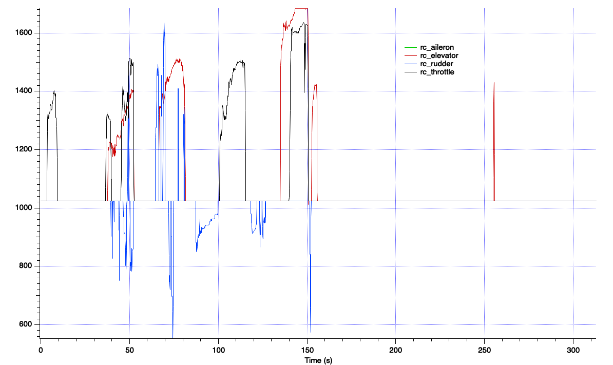

The switch at 240 seconds, briefly interrupted by autoland, led to the aircraft drifting away and losing connection after flying behind a tall building that obstructed the link. In that sense the event was accidental, but for some reason the pilot made no attempt at all to control the aircraft once it started drifting - almost no stick inputs at all other than one very brief application of elevator at 255 seconds:

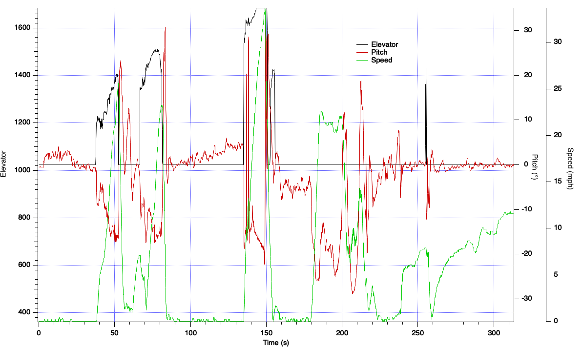

That's strange, because despite the compass errors the aircraft did respond appropriately to stick inputs, including the brief elevator input at 255 seconds:
The pilot had 73 seconds to control the aircraft after the ATTI switch occurred and the aircraft ceased autolanding at the home point, and before the connection was lost:

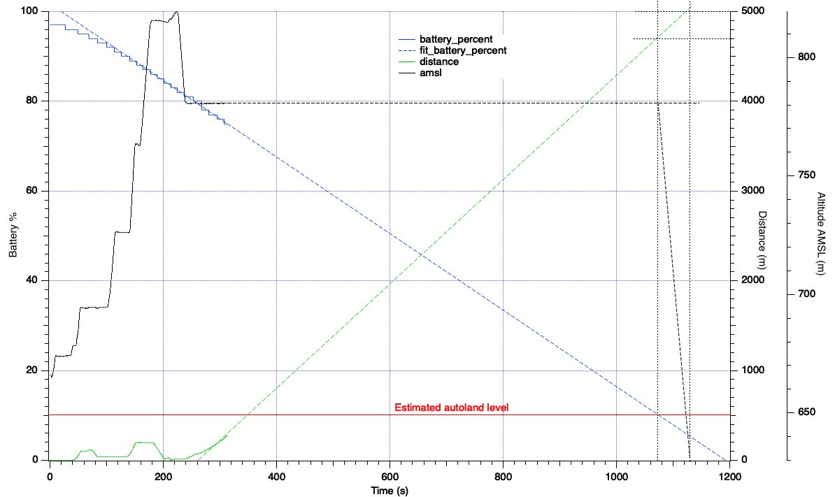

As a sanity check on the final outcome, extrapolating drift rate and battery depletion yields the following:

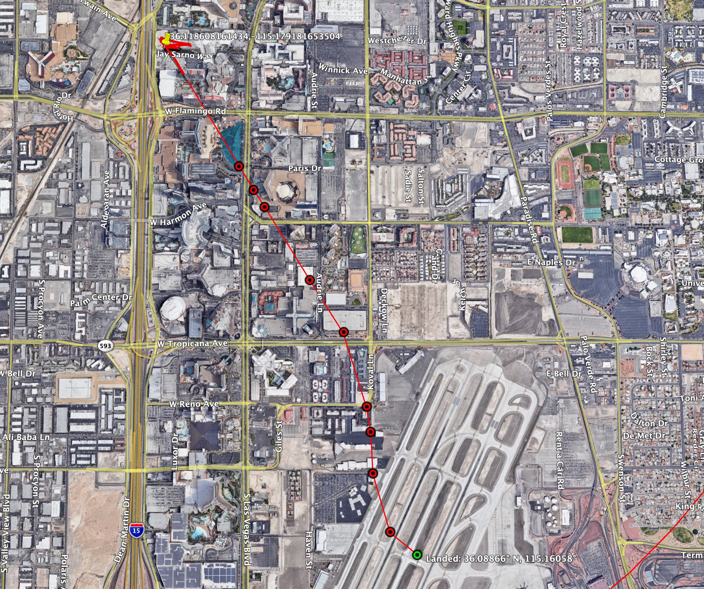

That suggests that it should have drifted to around 5000 m before autolanding. That puts it at the airport, although further than it actually travelled by around 1200 m. The reason is that the drift rate (i.e. wind speed) slowed as it headed for the airport. Analysis of the video show the actual track followed, with autolanding at almost exactly the predicted time (1068 seconds) just west of 19L-1R.
In conclusion, it looks like very careless piloting - either the pilot had no idea what to do in ATTI mode, or failed to notice that it was drifting away.
Very well done SAR. I think this helps to prove what many of us suspected all along.
Thank you for your time and expertise.
@mossphotography this should help explain many things we were wondering about.

I missed the local news on this one. Was anyone able to play back the flight using the log file referenced in the article? The longitude/latitude data makes no sense. It shows the drone was only 900 feet from home point but it landed between two taxiways on the far north end of our N/S runway. (19R) Fortunately the bulk of our traffic lands/departs to the west. It's rare for traffic to land to the south.

That was excellent work! I had it eyeballed landing a bit more to the northwest between the first two taxiways. Personally, I hope he never flies again.
Thanks. The landing spot that I marked is accurate to within 5 meters or so - the uncertainty due to it bouncing somewhat as it came down.
