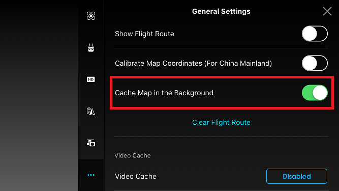

    I haven't been able to find anywhere in the Go app where to turn on map caching??

  8. msinger
    Approved Vendor
    Oct 30, 2014
    27,852
    8,659
    Harrisburg, PA (US)
    In the "General Settings" section of the DJI GO app, the setting is named "Cache Map in the Background" (on Apple devices). There is no setting for Android devices.

  9. Ron Arnson
    Dec 6, 2015
    43
    5
    Western Michigan, USA
    I find "Cache locally when recording" under the Video Cache heading but not under the Map heading.
  10. msinger
    Approved Vendor
    Oct 30, 2014
    27,852
    8,659
    Harrisburg, PA (US)
    Ron Arnson, there is no setting on Android (had to double-check). Since Android devices uses Google maps, that's where the cache comes from. The maps are just always cached by default. I've seen many people say the maps are cached for a longer period of time if you cache them from within the Google Maps app. I've never compared the two caching methods to see which holds longer though.

    Hi. Went through the steps to cache map as per video. Drove out to the location and everything was fine except no map, just a black screen. Got home, turned on Goapp and there's my map. What am I doing wrong? iPad air2 wifi and cell, set to airplane mode at site as there is no wifi or cell service at the location. Cache maps in background is on, goapp 2.60. Any ideas?
  13. msinger
    Approved Vendor
    Oct 30, 2014
    27,852
    8,659
    Harrisburg, PA (US)
    Jojoned, did you enable the following setting in the DJI GO app before attempting to cache the maps?
  14. Jojoned
    Jan 6, 2016
    110
    21
    Yes, I did. What is confusing is that the map comes up in go app now I am back home. I turn airplane mode at home and the map still shows up. So it appears to have cached it but did so on location. I don't turn off the tab, only use sleep mode.

  15. msinger
    Approved Vendor
    Oct 30, 2014
    27,852
    8,659
    Harrisburg, PA (US)
    Are you sure you zoomed into the correct zoom level on the map when caching? Other than that, I'm not sure why it wouldn't cache properly.
  16. Jojoned
    Jan 6, 2016
    110
    21
    Yes, zoomed in to the max it would allow. Does the bird and RC have to be connected to cache? Thanks for your help...will keep trying
  17. msinger
    Approved Vendor
    Oct 30, 2014
    27,852
    8,659
    Harrisburg, PA (US)
    No.
